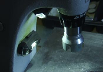

a. the drill chuck being rotatable is good as you can fine tune the alignment b. I have one of Tony's patterns and there is a quadzillion holes to punch. The press & 6 hole punch really speeds it up c. The press I have doesn't have a large reach so I can't do holes towards the centre of the pattern with the press (oh dear, how sad, never mind!) I take my pattern out side to do those holes d. you have a good height on that drill press. The leather press I have hasn't great height and I had to replace the bar on my multi-hole punch with a much shorter one and cut down the single types
I haven't searched that way before. Thanks for the tip. I'll give it a try. I just put my 5mm hole punch into the drill press and didn't turn it on. It was easy for me to go through this heavy leather just pulling down on the handle. Is there a benefit to the spinning other than making it easier to go through the leather? Using the press like this is a game changer for me. I think I'll be able to get my stitch lines straighter and do it without damage to my body or upsetting anyone else with the noise. Working with heavy leather, I can probably go faster too vs hammer the 6 prong punch 4-5 times to get it through. Maybe I'll invest in a dedicated press eventually, but for now I can use this and get good results. I'm not sure if the drill chuck's ability to spin with the punch in it is a good or bad thing for this yet.

Here is a small set of single hole punches that are made for the drill press. I used to have a customer that I made leashes for and each required 8 holes punched into 10/12 Latigo. They saved my life and sanity. https://www.harborfreight.com/6-piece-hollow-punch-set-67030.html
