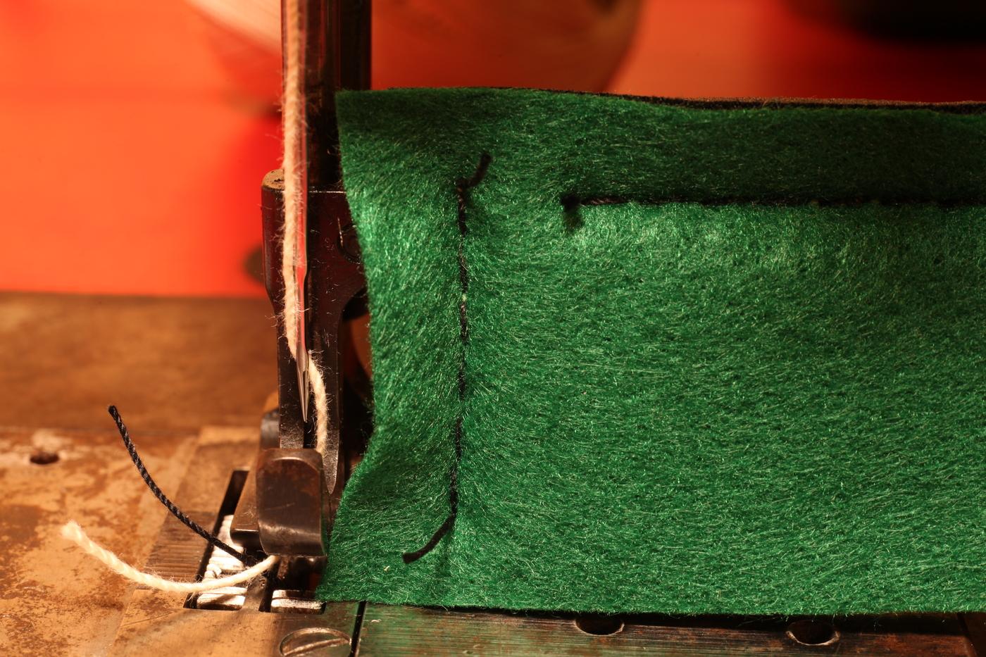

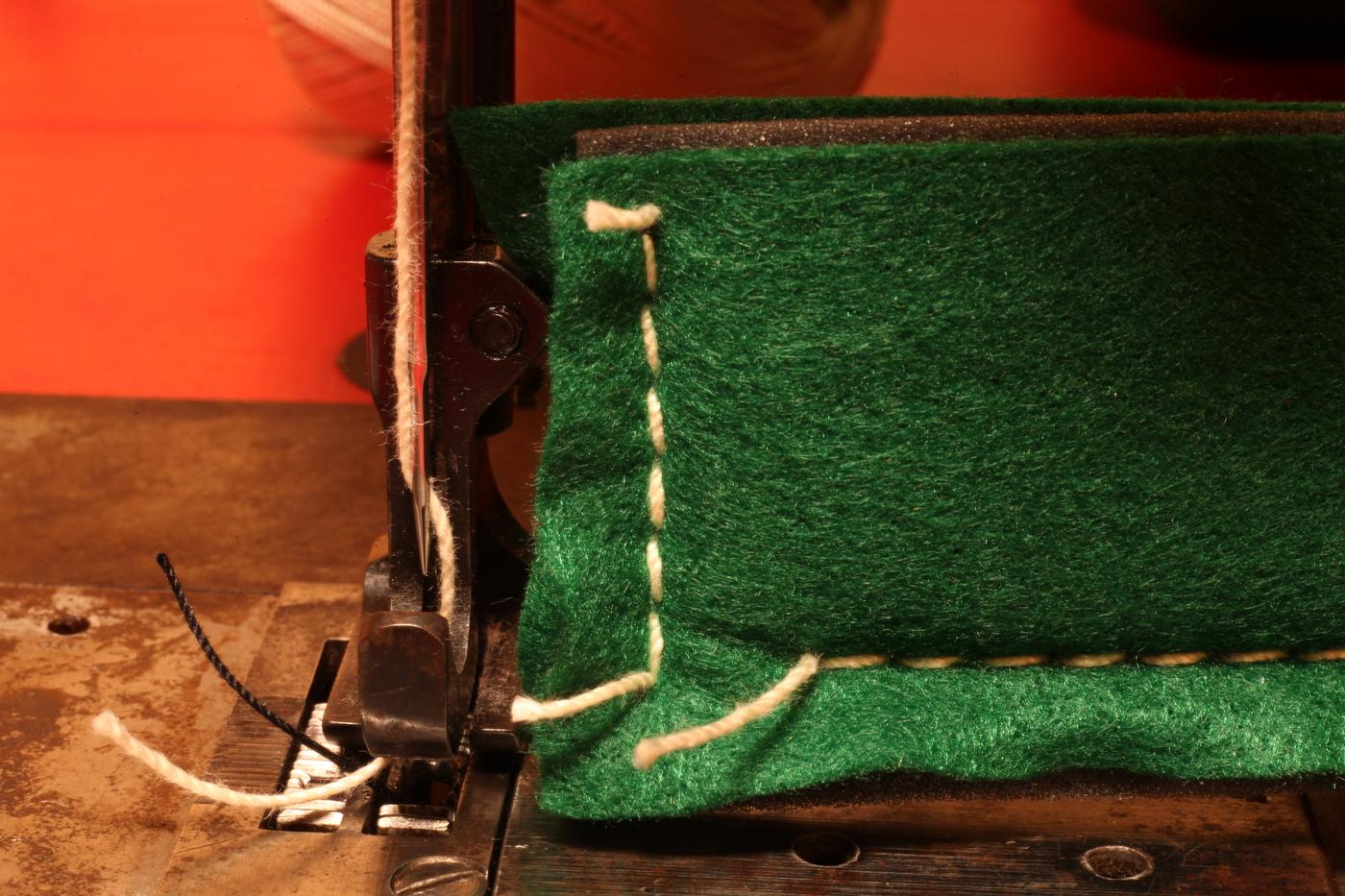

  2. This topic has inspired me to try stitching with larger cotton thread. I often use number 10 cotton yarn for practicing and prototyping, because I like the puffy look and it's available in bright colors. The next size up is "number 3", so I acquired a spool. Here is some number 3 cotton yarn ("natural" color) through the needle. The thread has a lineal weight of 360 mg/m, so it would be TEX 360 if you applied that scale. I used number 10 cotton yarn (black) in the bobbin, which weighs 170mg/m This is on a singer 144W103 with size 180 needle. Here is the number 3 yarn I bought: https://www.amazon.com/dp/B0BRLDP8CB
