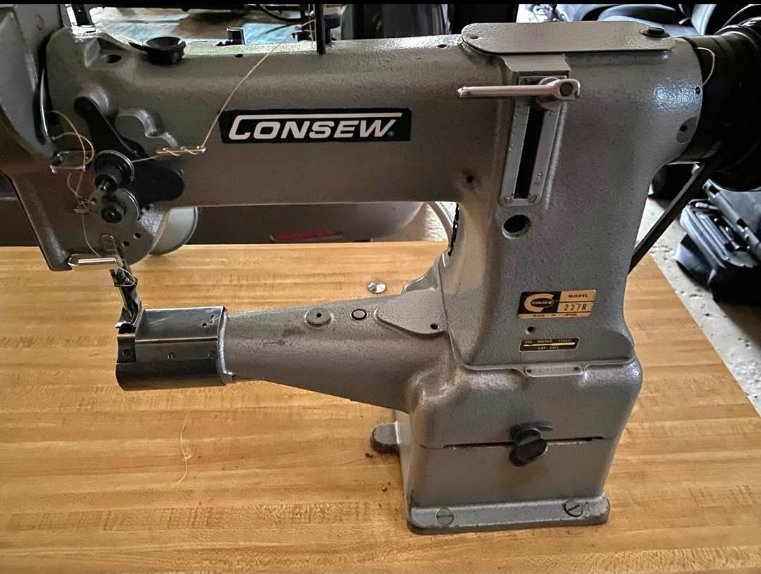

I've been looking for a sewing machine to sew leather belts, bags and wallets this is a consew 227r i tried searching the internet and youtube but I cannot find any with the black nameplate to compare it to. I assume this doesn't have a reducer if not can one be added? About the only thing I've found is "R" means it has reverse. What are the pros and cons to this machine? Any help would be greatly appreciated. A techsew 2750 or Cobra 26 would be great but this is 1/2 the price of not more.
