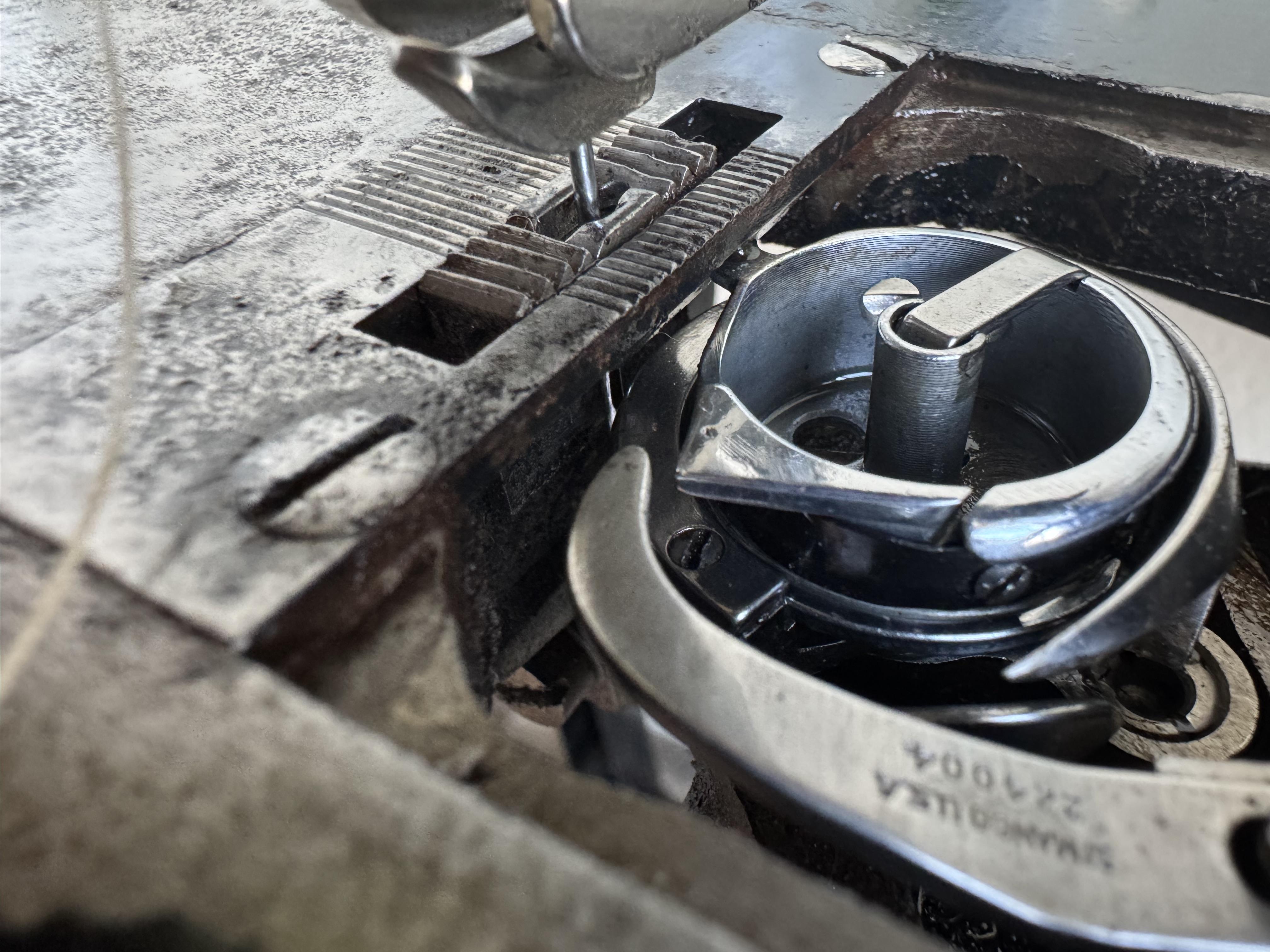

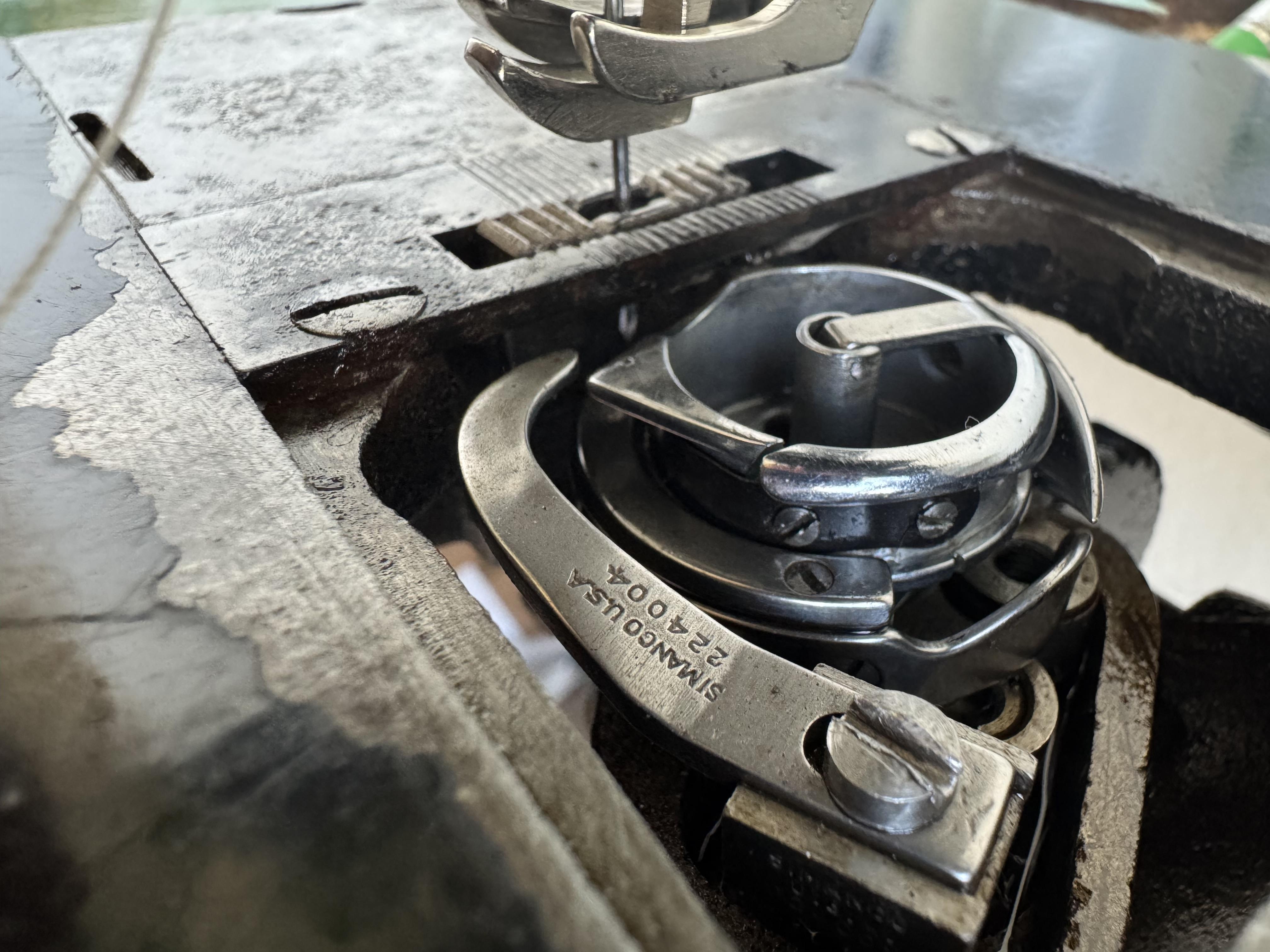

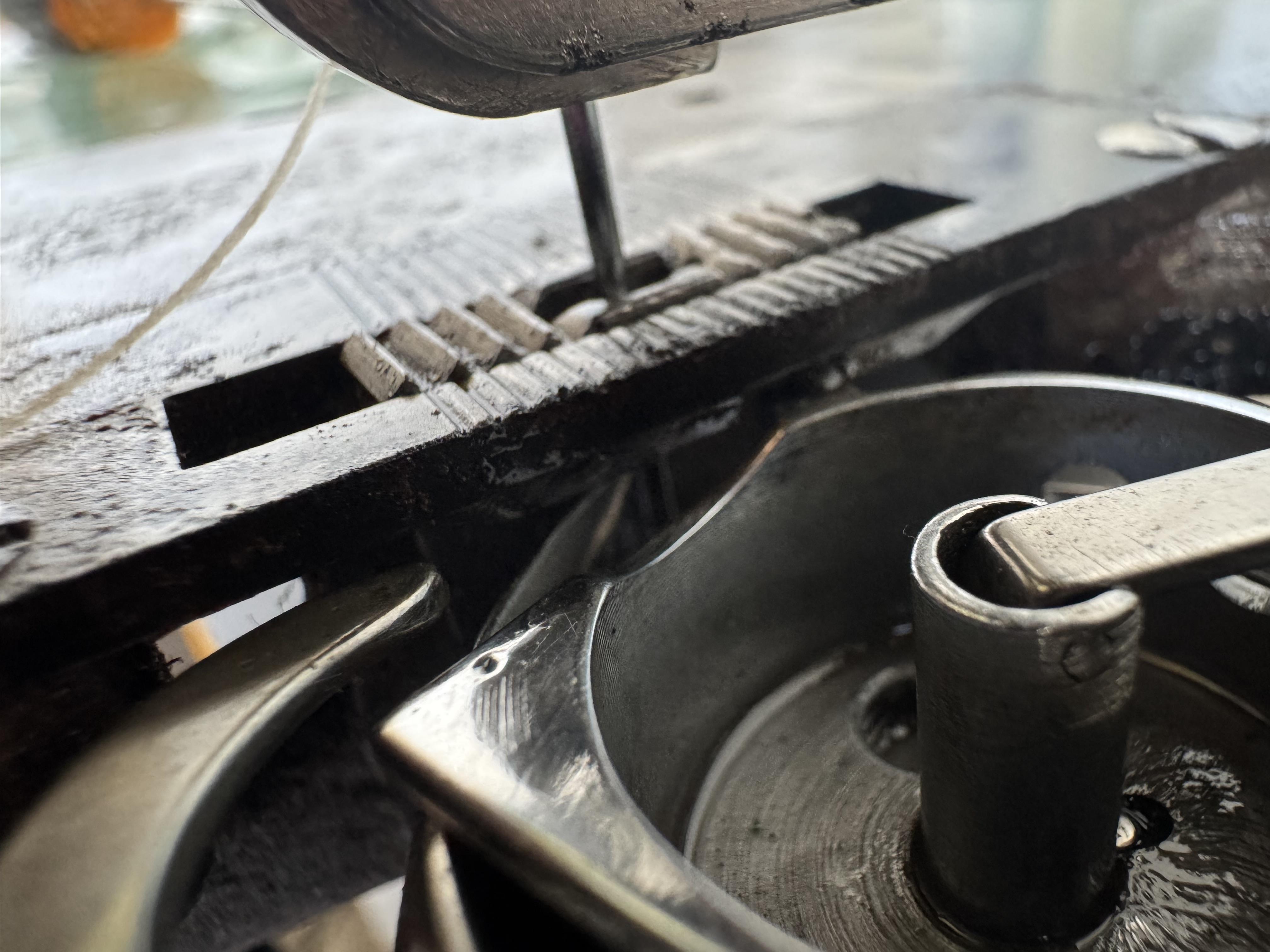

I would suggest a couple more photo's with no thread in the needle, the needle plate removed showing the position of the needle as the hook enters the Scarf ( indentation / cutout ) of the needle to catch the top thread. If the hook to needle timing is off you will get skipped stitches. kgg

I guess I’ll just need to fine tune then. The hook seems sharp and I’m letting machine do its thing.

Looks like you've got the corners down. I wonder why the stitch length is varying and the occasional skip. Probably the hook, needle, needle bar height and timing need to be fine tuned. Are you letting the machine feed the material without tugging on it? That can mess with the feed and thus the stitch length.
Easy fix: Loosen the screw at the top rear of the inner presser foot, rotate the foot till the needle is centered in the hole, tighten the screw. Would you mind taking some close-up shots of your hook point from above? My Singer 144W103 (built in 1943) had a dull hook point: https://leatherworker.net/forum/topic/131846-best-angle-to-sharpen-a-hook/#findComment-784869

@AlZilla @kgg Thank you both so much for the advice. I followed all of it. Switched to 135x16. using a size 20 needle with Tex 90 nylon. Made the needle face the correct orientation. Repaired the small thread guide at the bottom. I still feel like my needle is a little too close to the inner wall of the foot but worried to crank on it too hard. It’s sewing like a dream only have a small issue with it skipping every so often or another. Will post new practice pieces after. Again thank you so much for all of your help!
