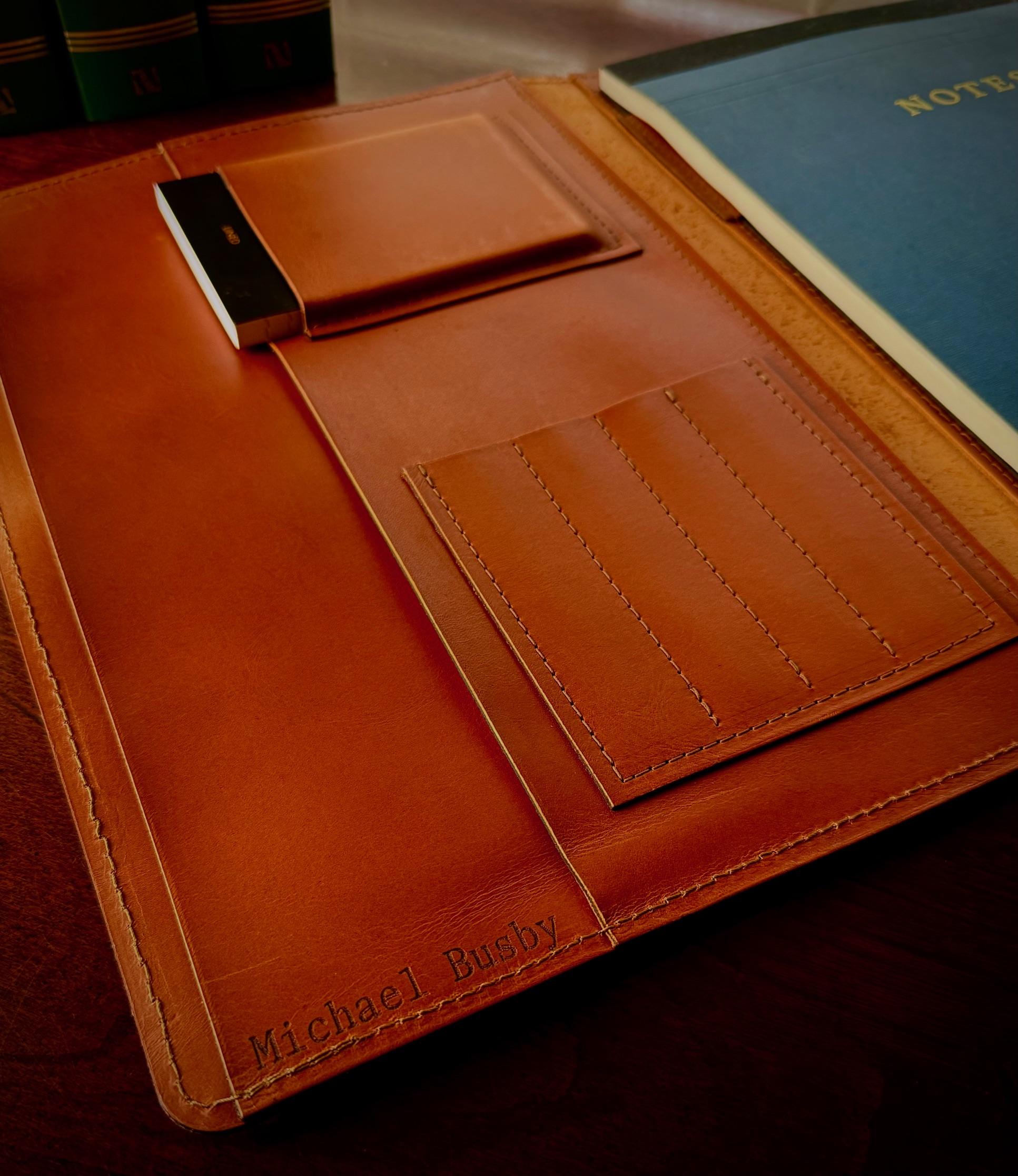

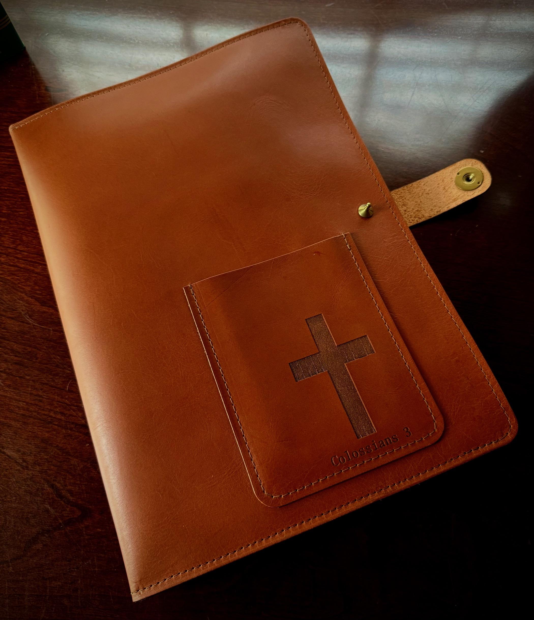

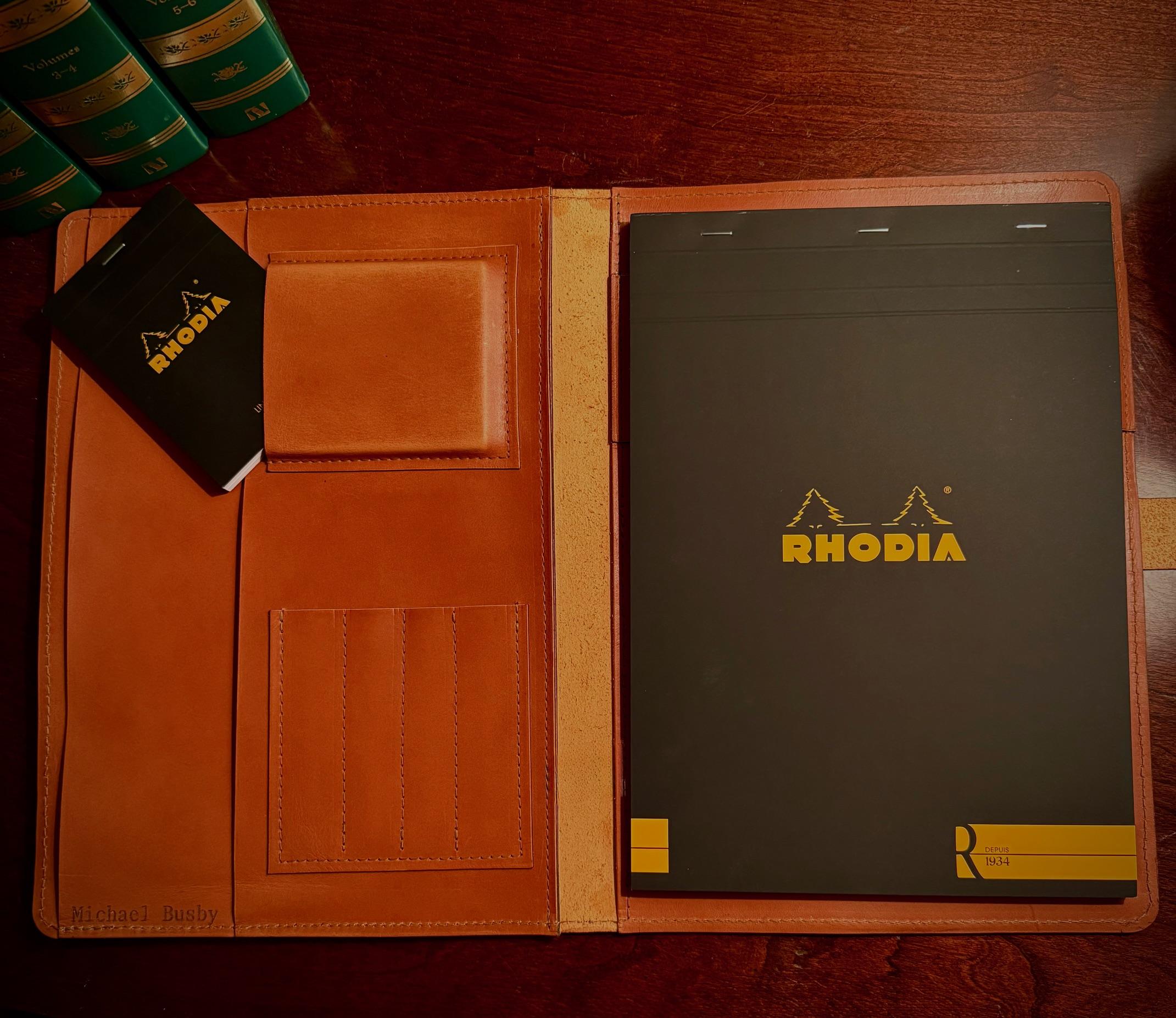

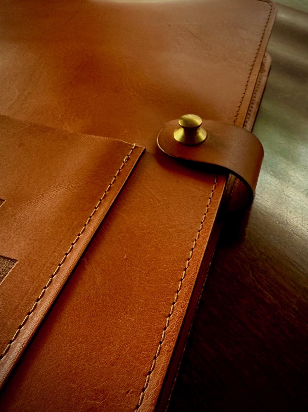

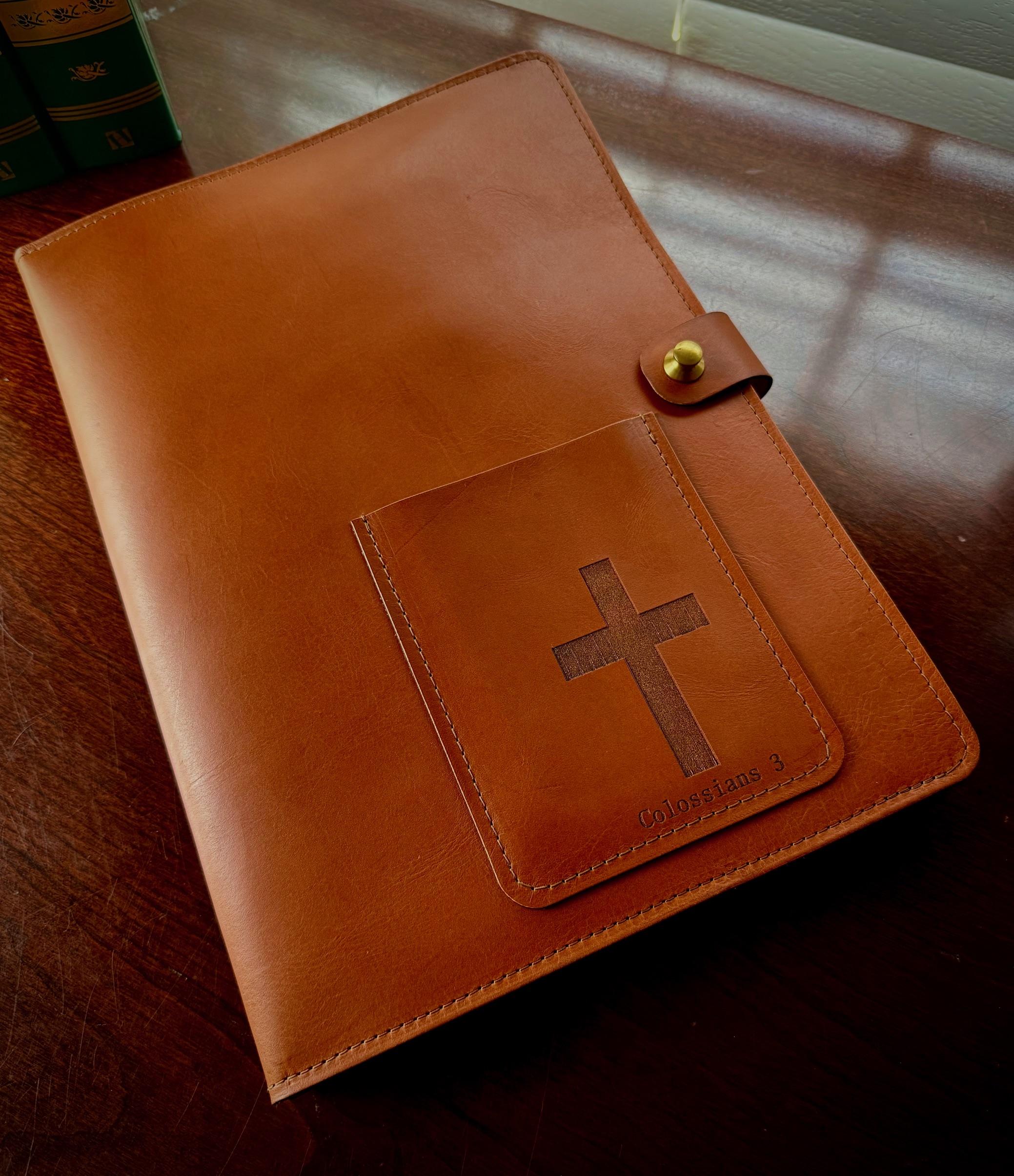

Hey everybody! This is my first post in a while. I just got this portfolio finished up for a customer and felt like it was worth sharing. This may be my favorite thing I've ever made! What do y'all think?

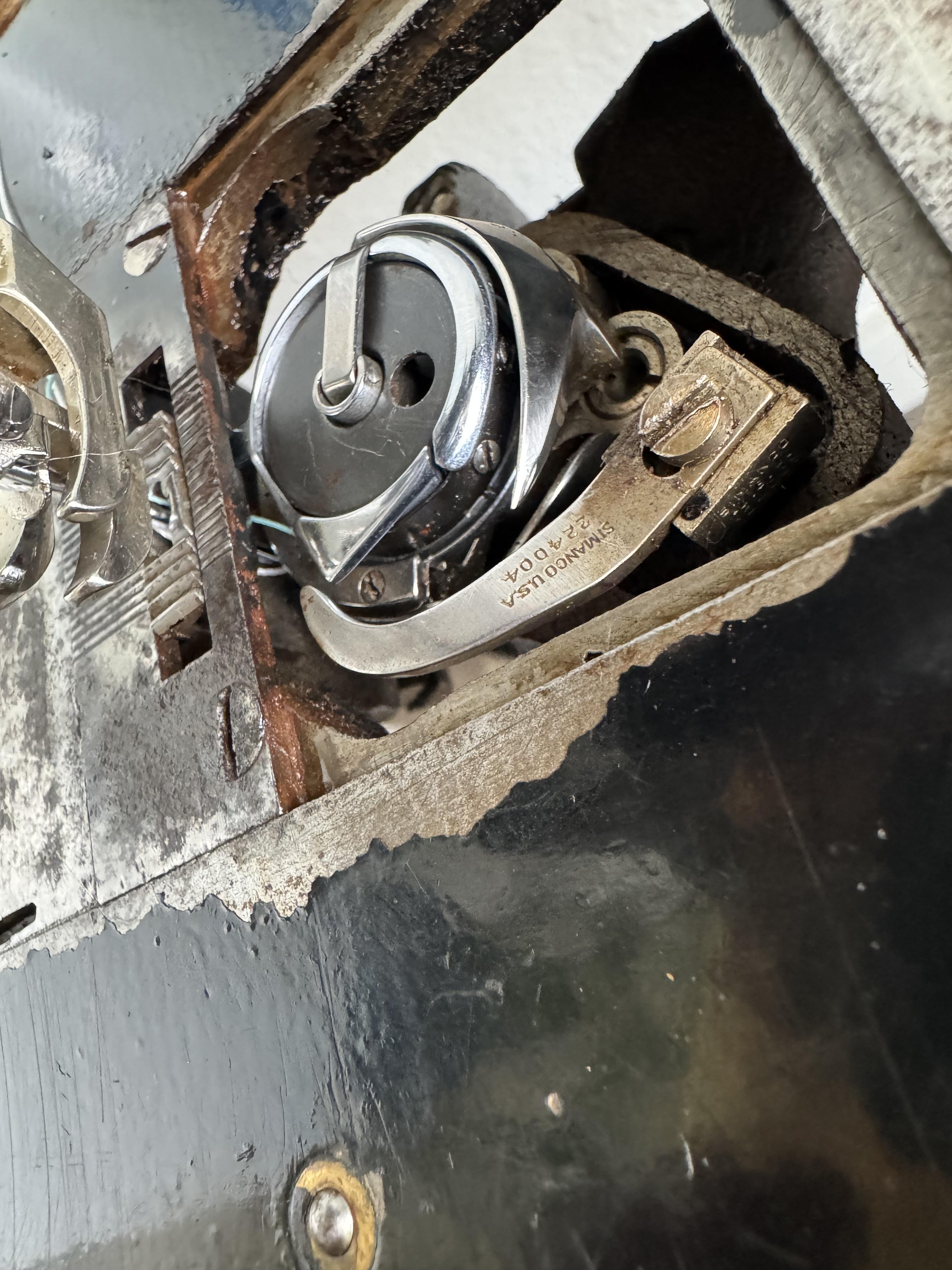

Looks like you've got the corners down. I wonder why the stitch length is varying and the occasional skip. Probably the hook, needle, needle bar height and timing need to be fine tuned. Are you letting the machine feed the material without tugging on it? That can mess with the feed and thus the stitch length.

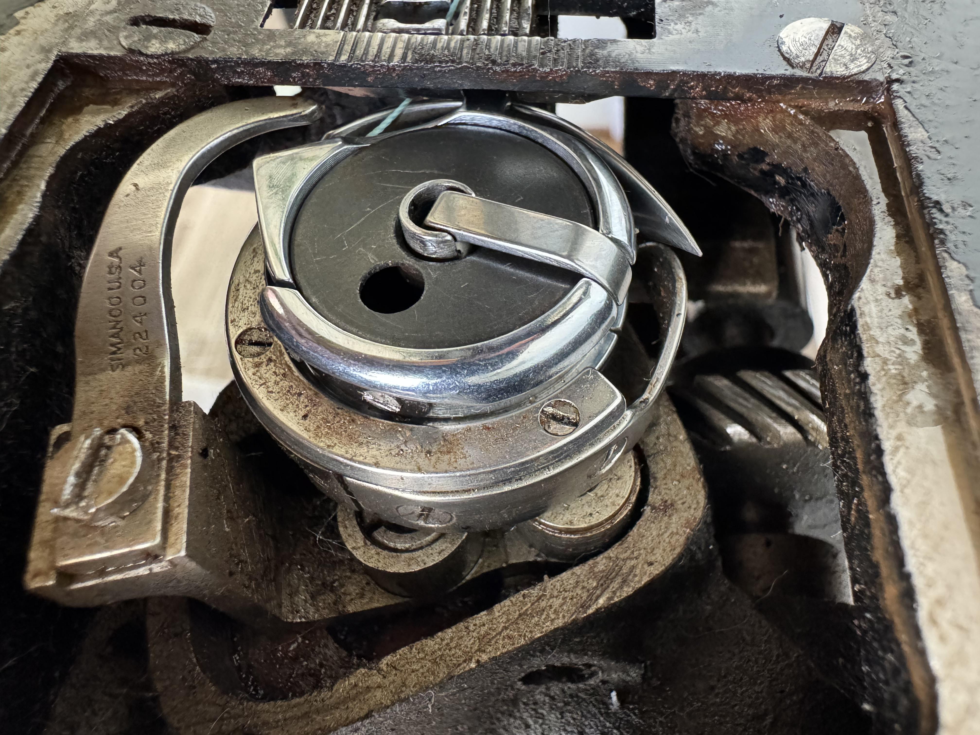

Easy fix: Loosen the screw at the top rear of the inner presser foot, rotate the foot till the needle is centered in the hole, tighten the screw. Would you mind taking some close-up shots of your hook point from above? My Singer 144W103 (built in 1943) had a dull hook point: https://leatherworker.net/forum/topic/131846-best-angle-to-sharpen-a-hook/#findComment-784869
