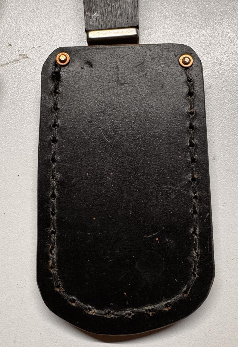

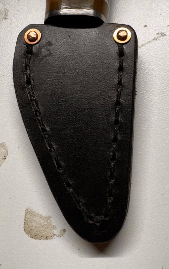

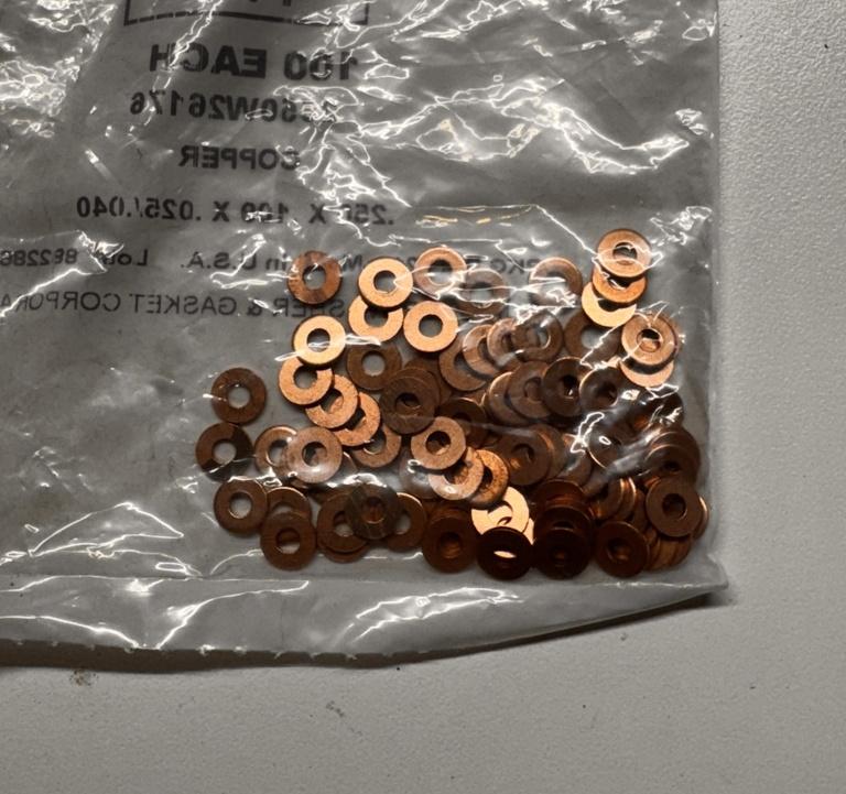

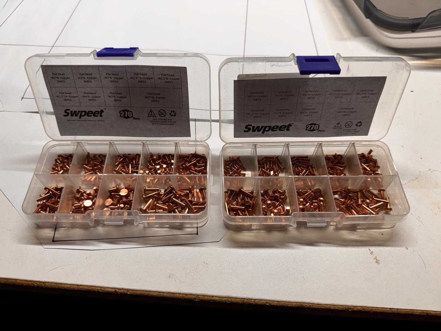

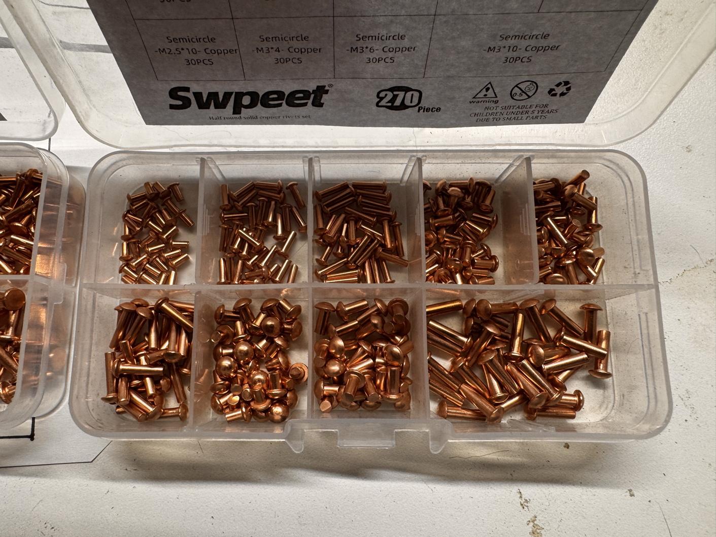

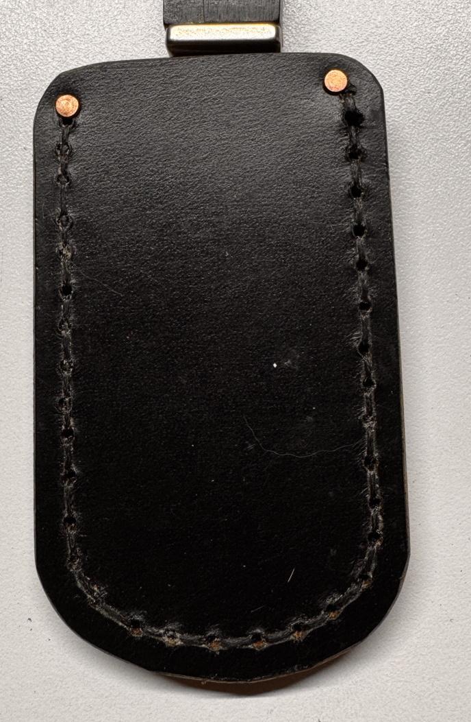

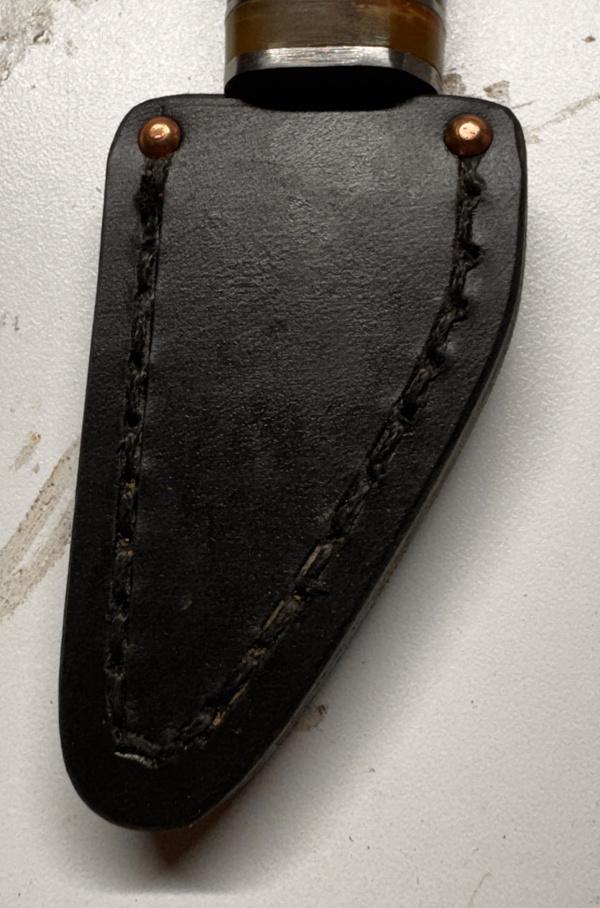

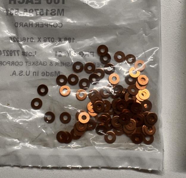

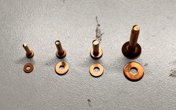

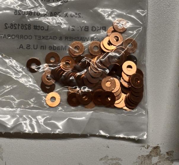

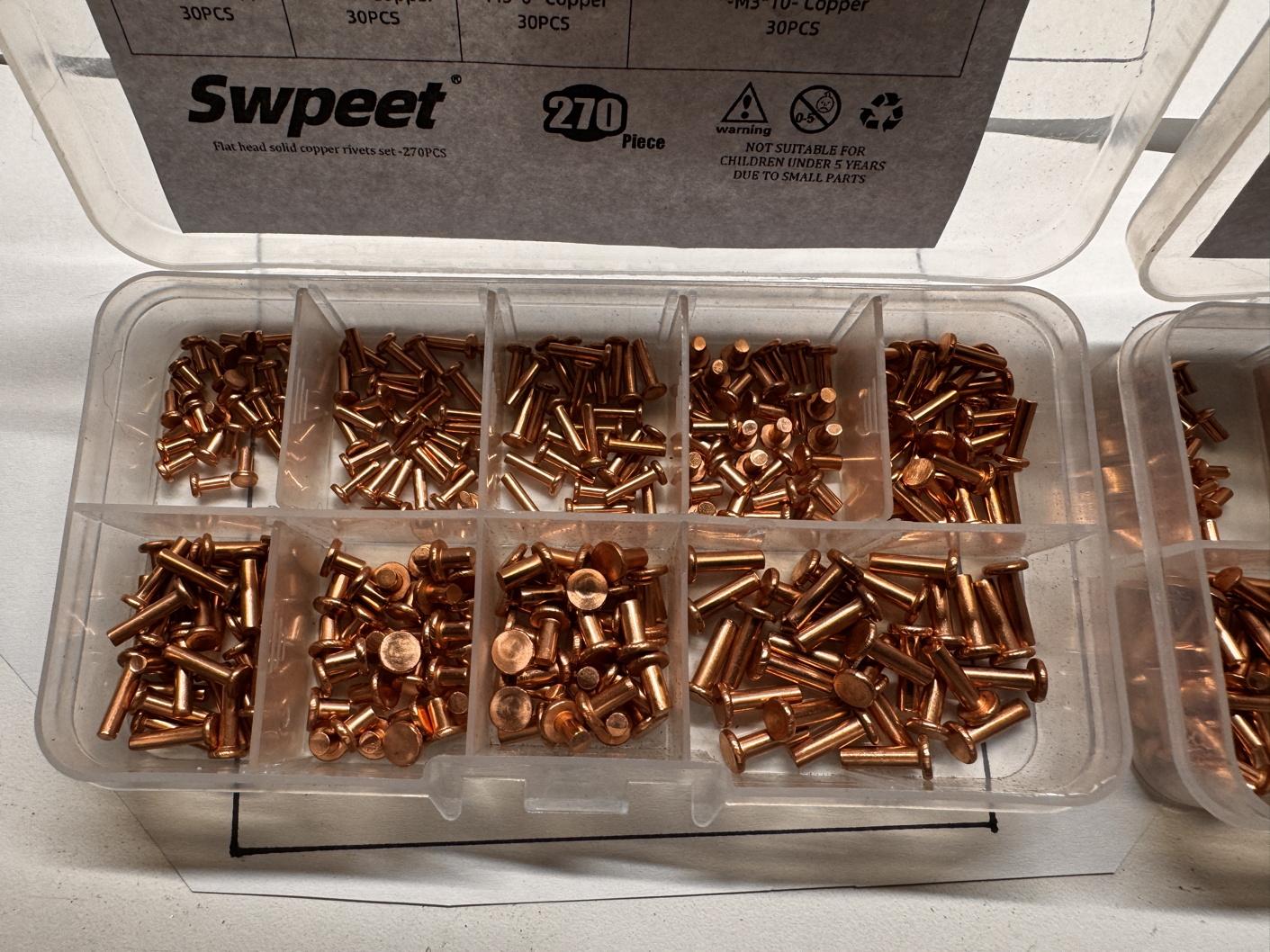

I mostly make leather knife sheaths and I was trying to find a compact rivet to end the stitch lines. I like copper burr rivets, but the smallest available are still way too large. I have found a solution that works for me. Amazon sells assortments of metric copper rivets in flat-head and round-head versions. The range is 2mm, 2.5mm and 3mm shaft sizes https://www.amazon.com/dp/B0CNCSHG3T https://www.amazon.com/dp/B0CNCT42XG I found the washers on McMaster Carr. They are sold as #1, #2, and #3 copper flat washers https://www.mcmaster.com/97565A111/ https://www.mcmaster.com/97565A112/ https://www.mcmaster.com/93661A112/ I made my own rivet sets by just end drilling some pieces of 1/4" round steel rod. You will need a #44, a #40 and a #31 drill bits. I think mild steel is fine as these will only get light use. I will probably make some matching doming tools by using a diamond ball bit in a dremel to carve little domes in some harder steel rod.
