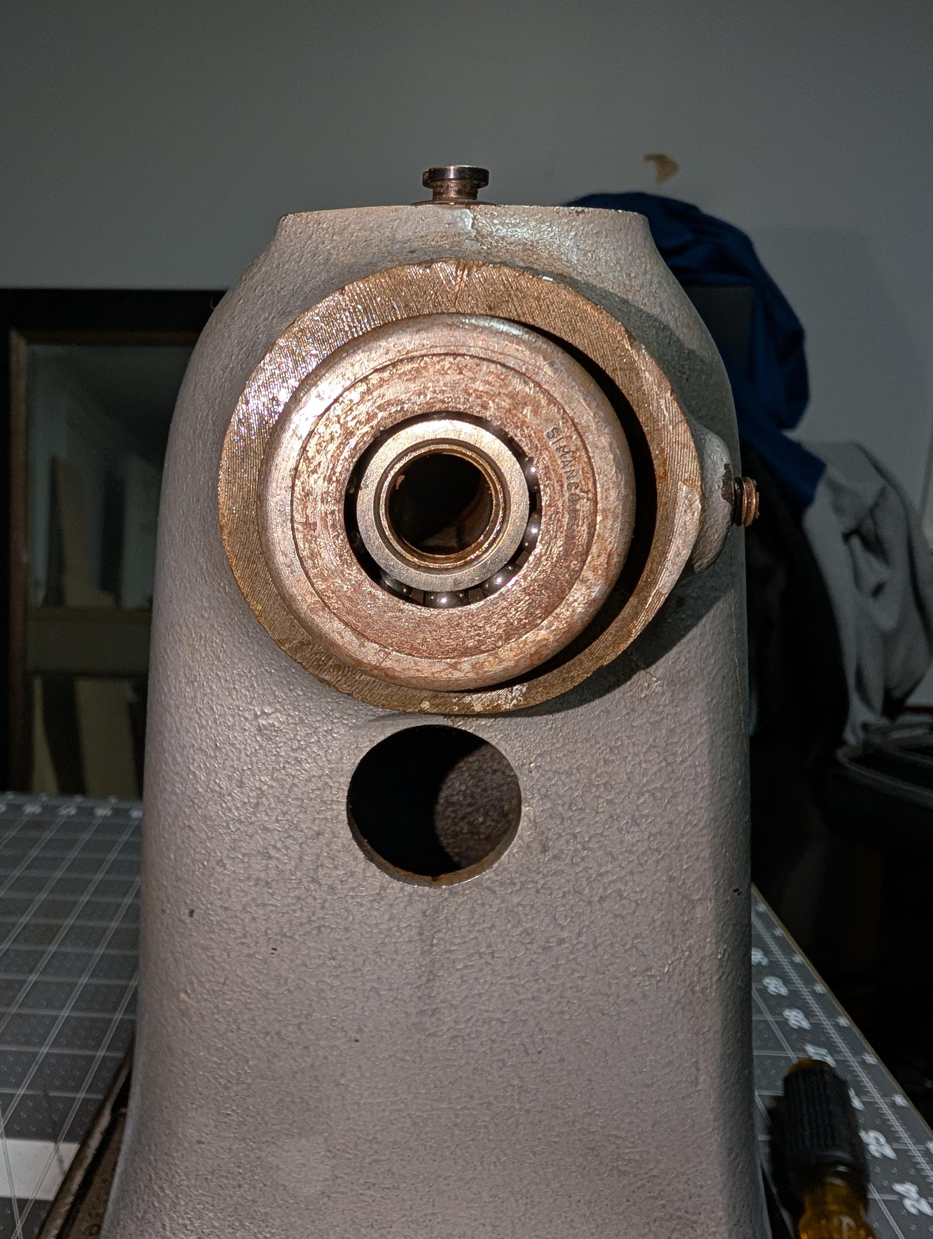

On the subject of lubrication: should this bearing get packed with grease, or does it just get sewing machine oil?
