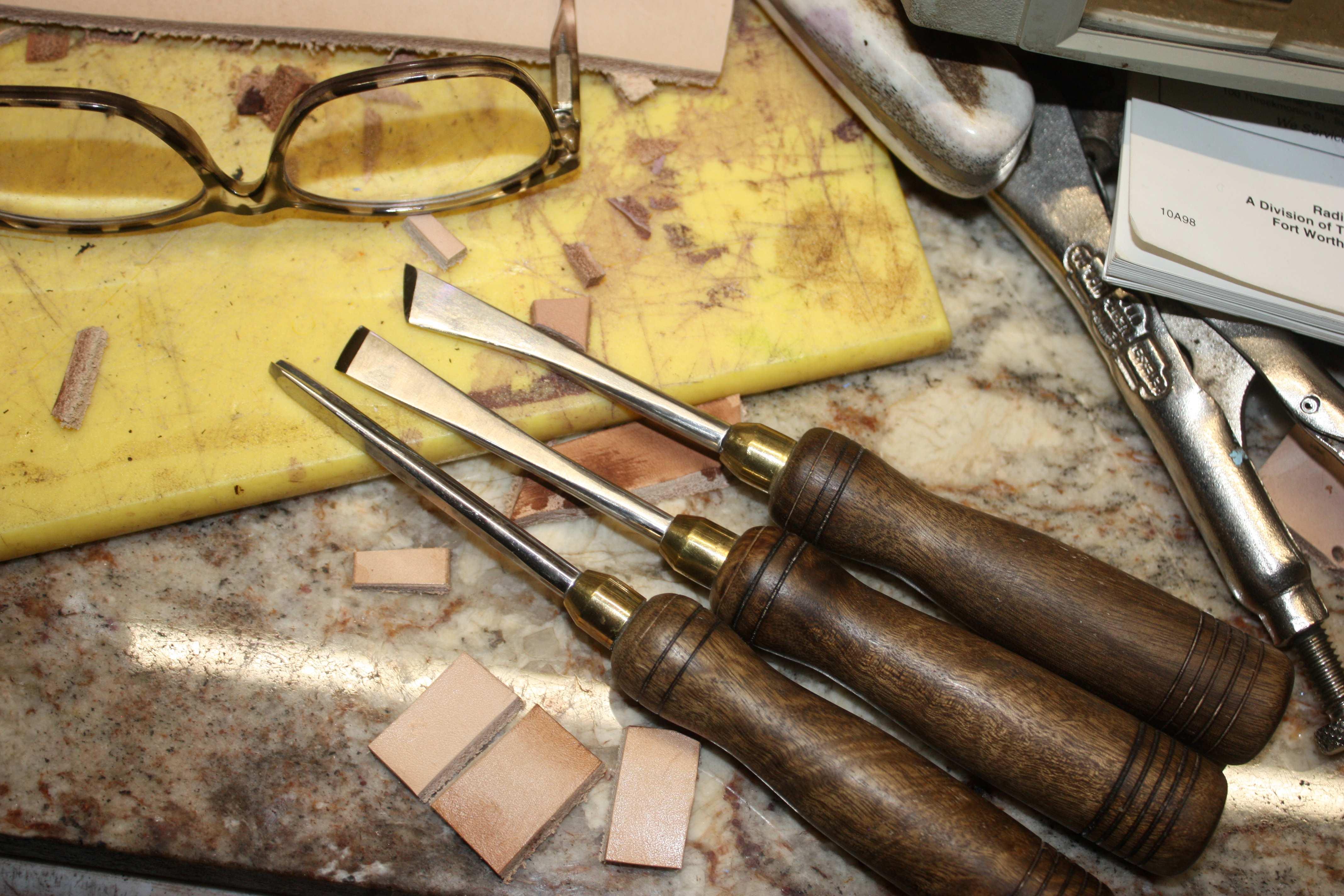

  24. I don't understand the witness marks... It looks like regular marks from cutting, but I can't imagine what gets cut like that, over and over. Cool tool mod, by the way.
