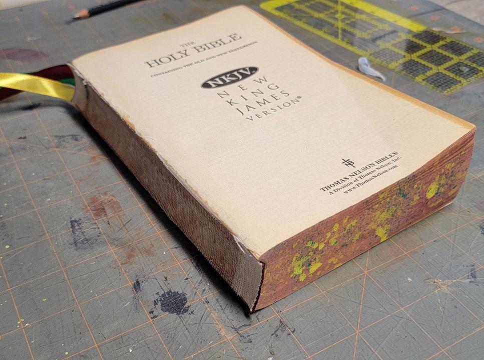

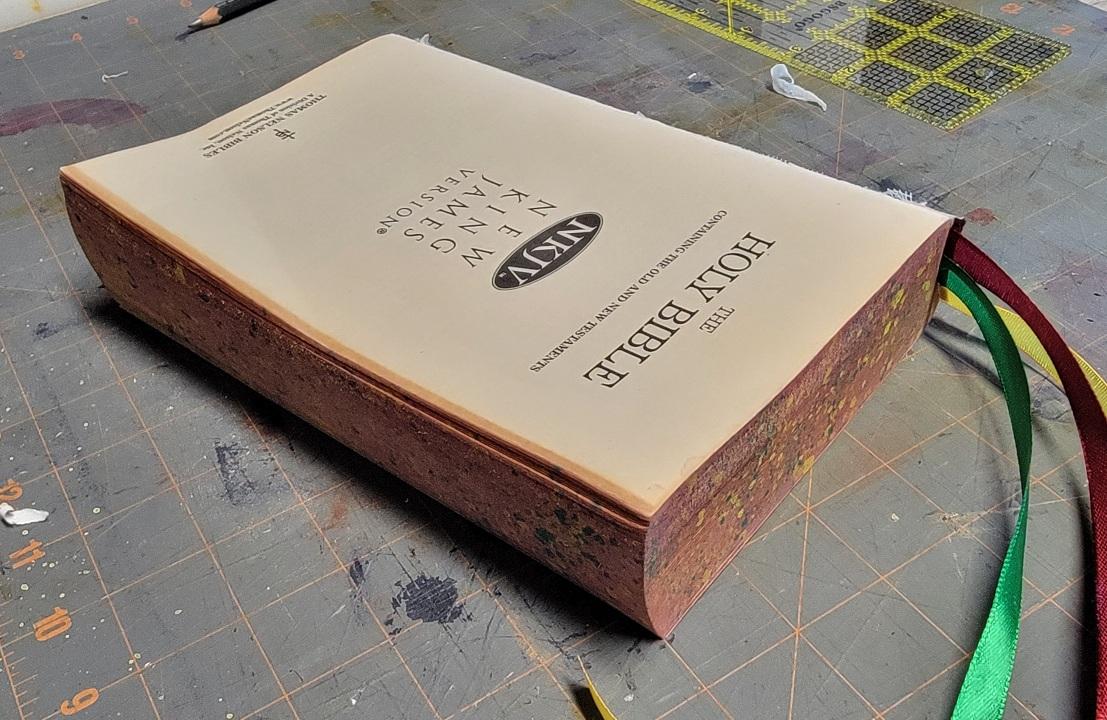

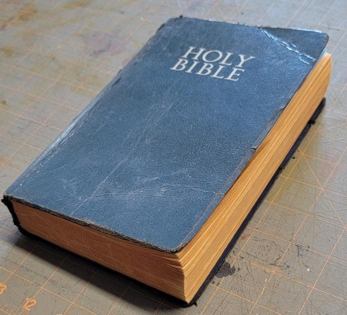

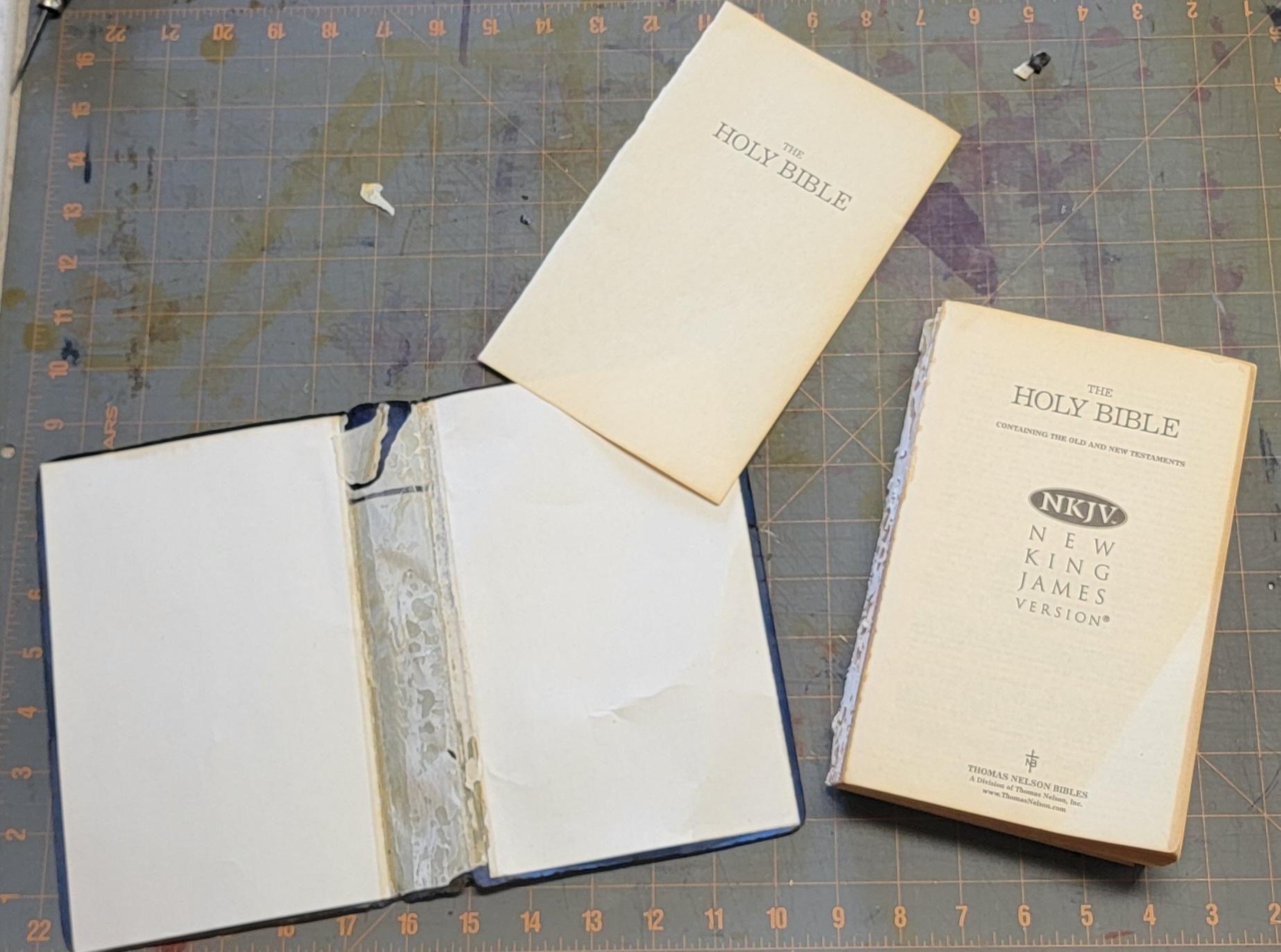

I'm currently doing some book rebinds. My plan is to rebind and sell a few books from time to time. Generally books are rebound in 2oz leather and good quality binders boards for hardcover books. Going thicker than that makes it difficult to fold over the edges, going thinner means the leather will wear out faster. On my bench at the moment I'm rebinding a soft cover Bible. I'm going to use poster board and 2oz veg tan. You can probably do 5oz you'll just have to mitigate the curling of the leather after tooling.

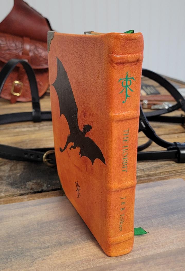

You don't need thick leather for books, but you can use whatever you want to. I've made a few sketch books, bible covers, and vow books for weddings. There is a lot of info on the forum, i would search bible covers, book covers, vow books and such. you will also want to get info on bookbinding in general. Good Luck!!!!

One of the first ones I did was an old Bible. I used 5/6 oz. leather for it. I did some tooling on it as well. It is somewhere between a soft and hard cover.
