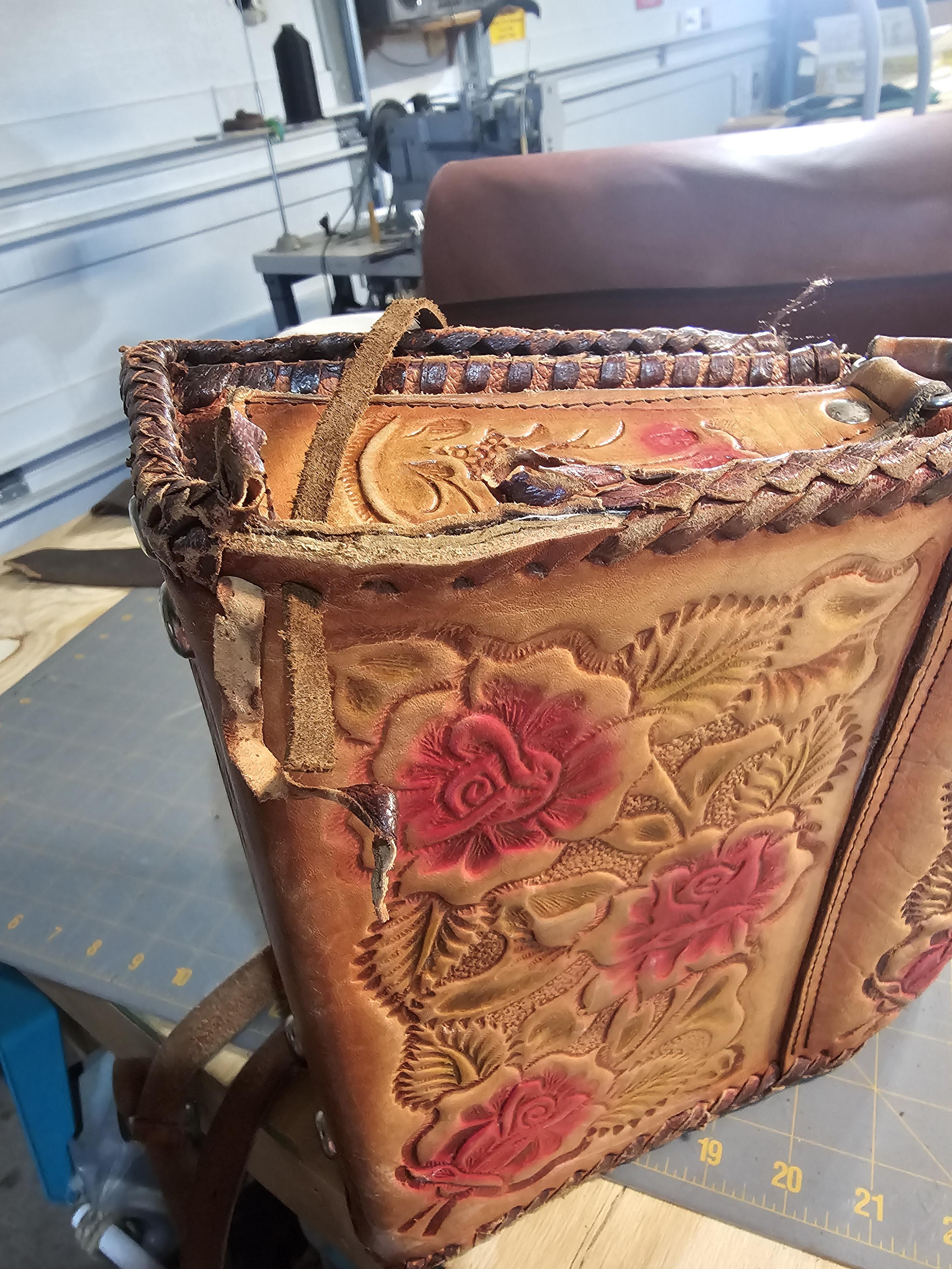

A brave friend asked me if I would try to put new braiding on her bag. It was broken and worn in a few places. Of course, I can't match what has been used, but I think I found something that will work, and have ordered it.{Calf, 4mm} Now, I'm trying to find a good "how to" video, and don't know the name of this braid. It looks like double loop, but I'm not sure. Or, is it Mexican round braid? TYIA
