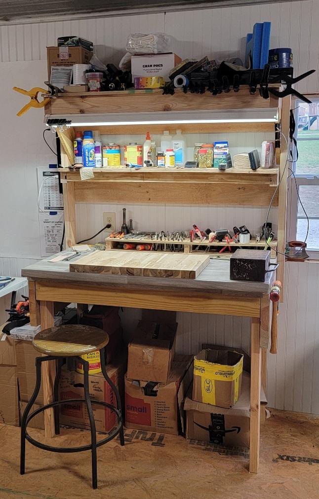

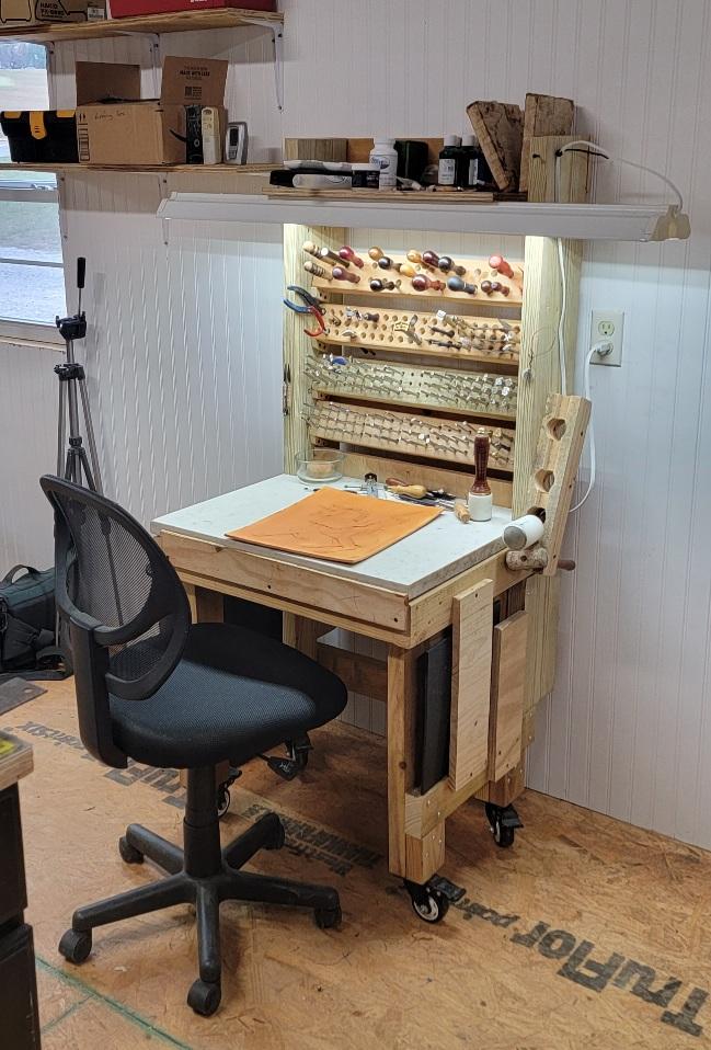

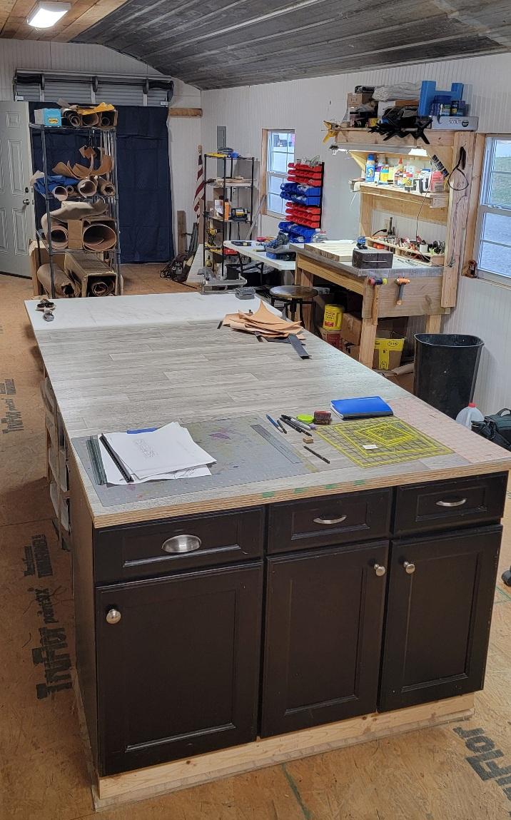

  5. You don't mention if you looked at the check spring, suggested earlier. Here's a recent treatise on all things Check Spring from Wizcrafts. Proper check spring function is critical:

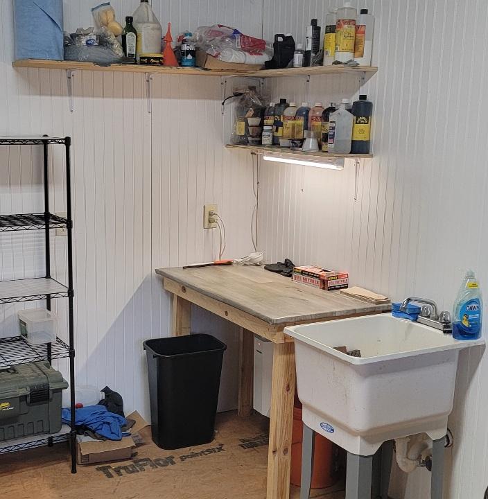

  20. I have been dabbling in leatherwork for years, but never took it seriously or to the next level. Recently, I've found I have more time on my hands, and I want to get serious about improving my skills. Years ago, my father built me a great workbench to put in my tack room, but I just had tools randomly stored in the drawers. I've taken the time to sort things out and grouped my tools into "categories" (for a lack of a better term). Here's my question to all of you... How would you arrange these "categories" in your bench drawers? Sharpening Measure Cutting Skiving End Punches Press Punches Hole Punches Tooling Dying Gluing Zipper Setters Stitching (Hand) Thread (both hand & machine) Edger's & Groover's Burnishing Hardware Setting Miscellaneous (like a thread spool holder, belt trimmer, etc.) Stitching Pony's (small item only, not my large one) Keep in mind that I have hardware and stamping tools in dedicated spots on top of my bench. Thanks in advance for any and all suggestions!
