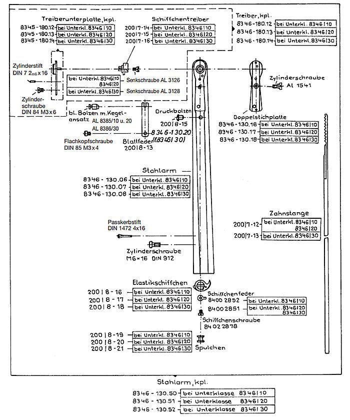

  8. Yes, its a 8346-20 medium hook machine. Top threading seems to be okay but indeed, the "wedges" don´t belong to the machine (check the parts list - see picture below) and are probably part of the problem. I assume when the top tread goes around the hook the thread keeps handing on the wedges - somehow (maybe not but they don´t belong there anyway). Hard to tell what the guy 5 years ago did with the machine. I only can guess what he tried to achieve with the wedges. 1.) Either he tried to "rise" the hook a bit to eliminate a timing issue (Needle bar to high so he tried to bring the hook higher 🤨 or 2.) he tried to compensate wear but I doubt the machine can we worn that much already. So I assume its 1.) What I would do is removing the wedges and lower the needle bar a little bit. Some years ago I translated a 8346 mechanics manual from German to English for one of our members. I´ll check if I can find it and send you the file. It includes all values for timing and how to replace worn shuttle drivers and set the needle bar correctly and so forth. Thats the best I can do from the distance.
