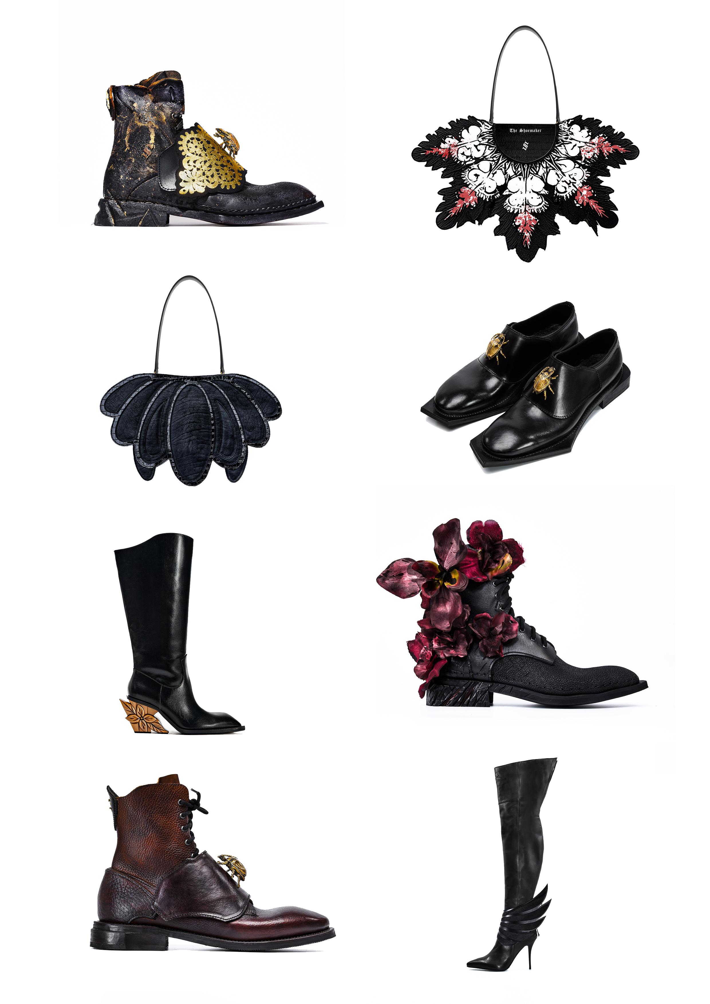

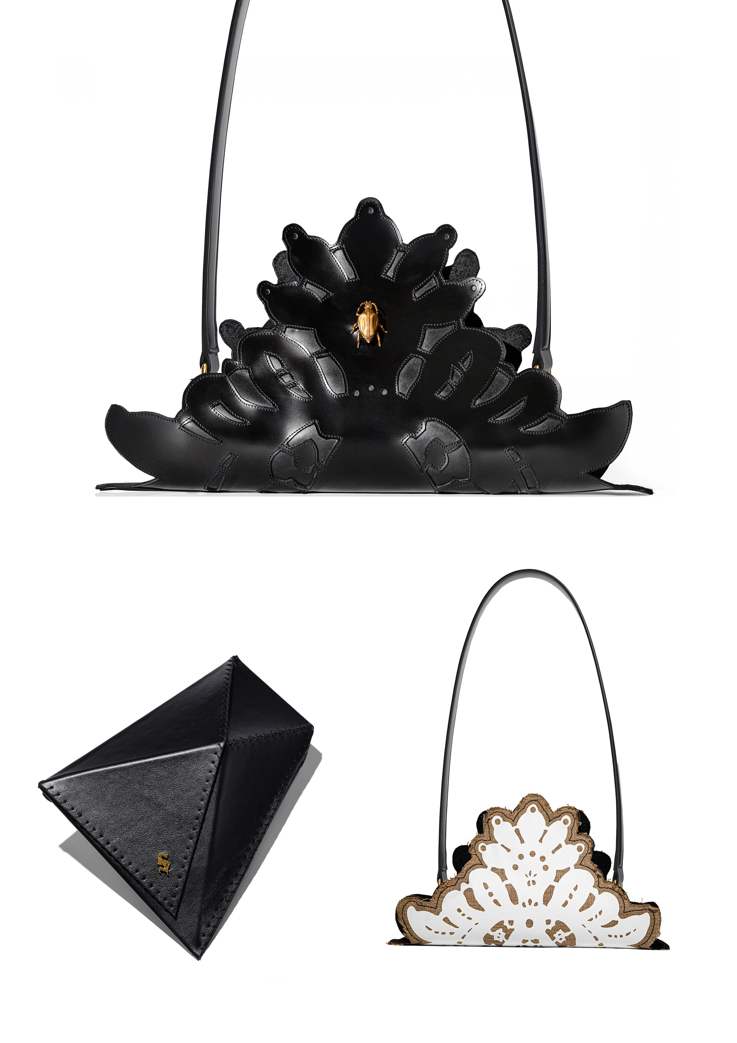

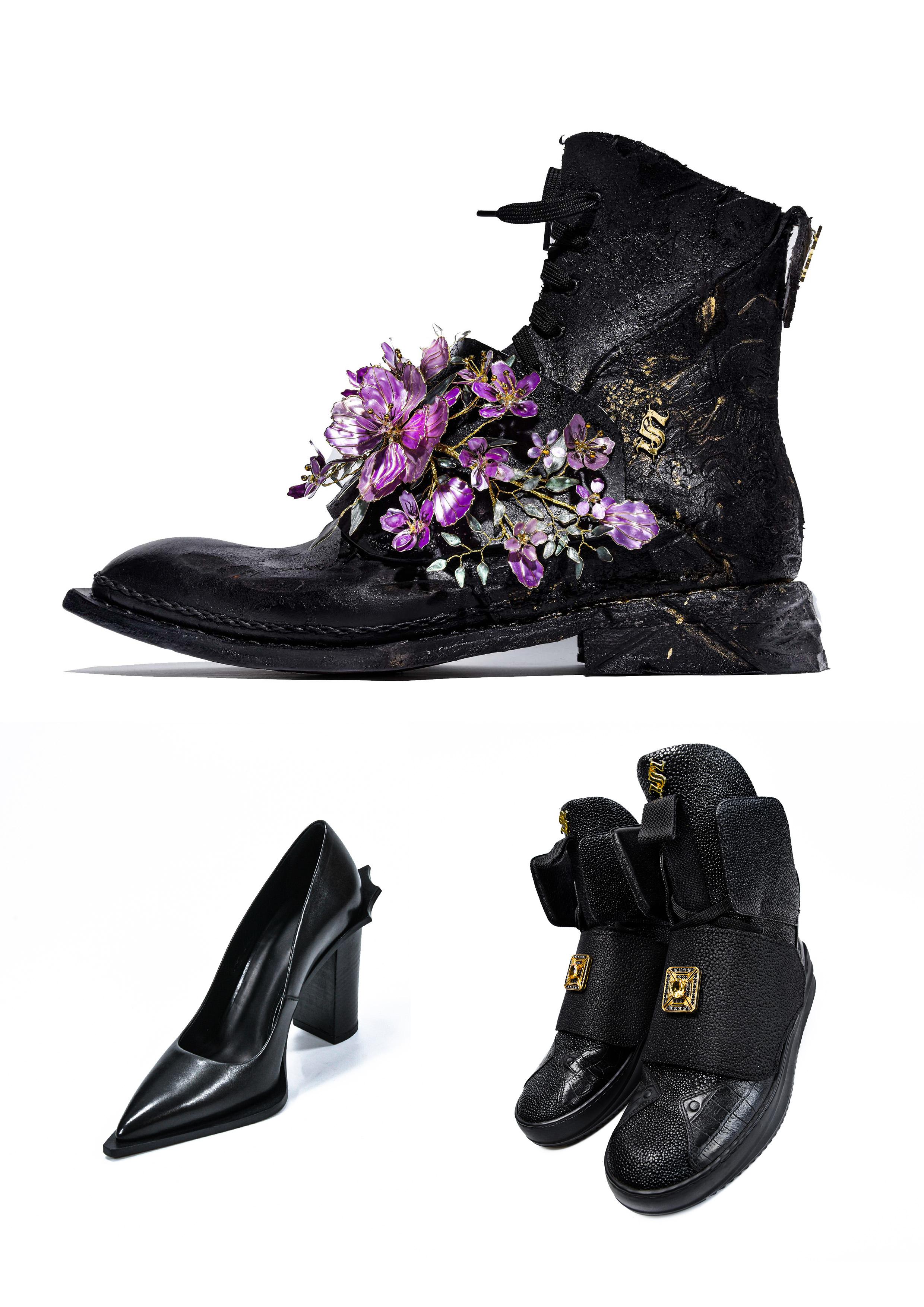

  4. My collection of shoes and accessories combines traditional craftsmanship with artistic expression, turning each pair into a wearable statement. The designs draw from fine art and Japanese aesthetics, balancing elegance with individuality. A distinctive feature of my work is the use of interchangeable magnetic jewelry accessories, an idea I developed to let the wearer transform the form and character of their shoes — from subtle and classic to bold and expressive — with a simple change of detail. Every piece is handmade, unique, and created to celebrate both style and personal story.

  17. Yes whoever invented the layback sewing machine deserves a prize 🦄
