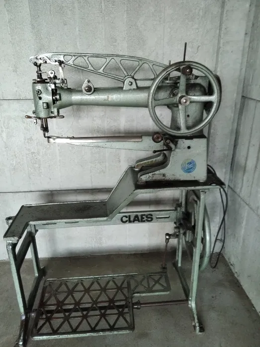

  9. if you cant find one used check with CL Machinenbau - they still make the shuttles for the 8346-20 https://www.cl-maschinenbau.com/de/leistungen/naehmaschinen.html But do not expect them to be cheap 😉

  13. Hi i want to buy Claes 200-2 Machine. But the seller says it is missing shuttle. Where can i buy a new shuttle preferably cheap. Diameter of socket is 22,7mm. Anyone know something?
