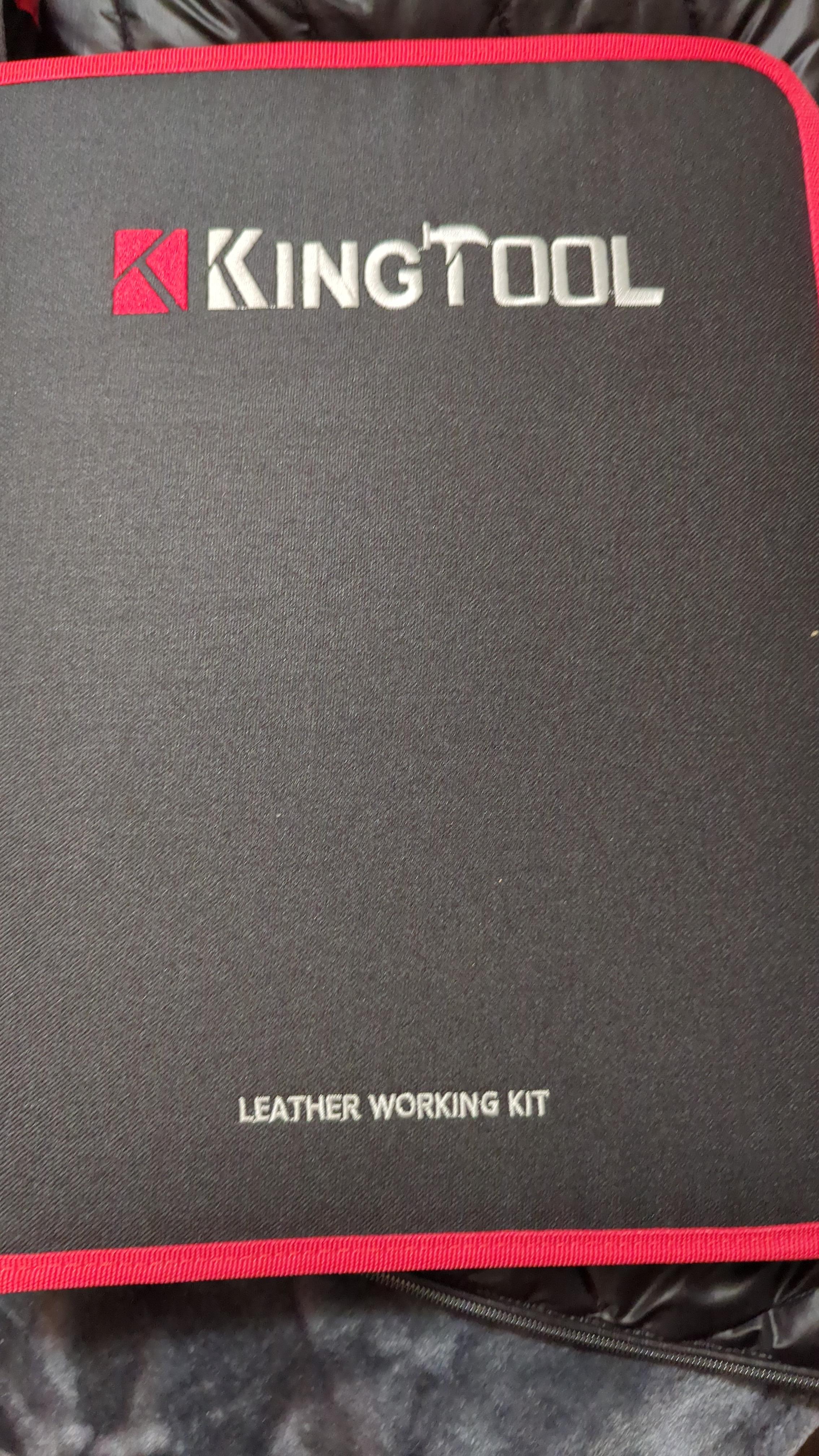

Thanks I just got this kit on Amazon... Now I need to get some leather, seem to have some basic tools I guess . Now I need to get some patterns and some leather to start practicing. Saw I few things on a Renaissance fair that I would.like to some.day be able to make like a dragon mask or a dragon night night helmet. I also already promised my mom to make her a wallet once my skills are up for the challenge.
