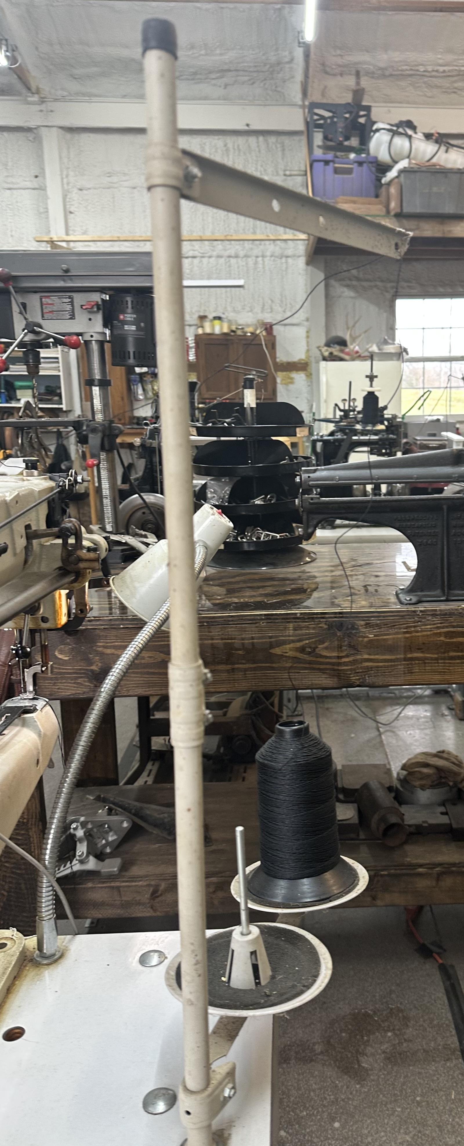

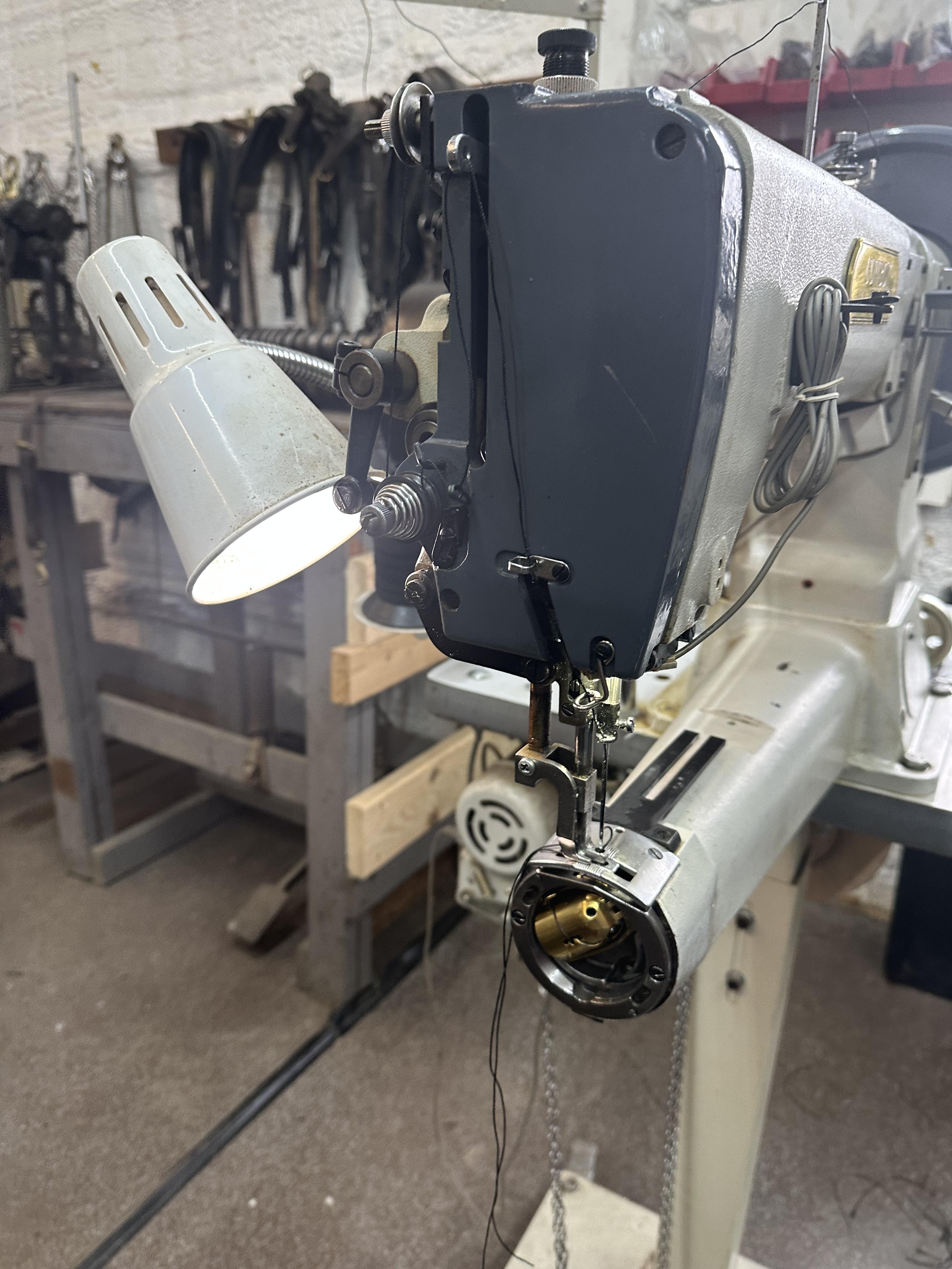

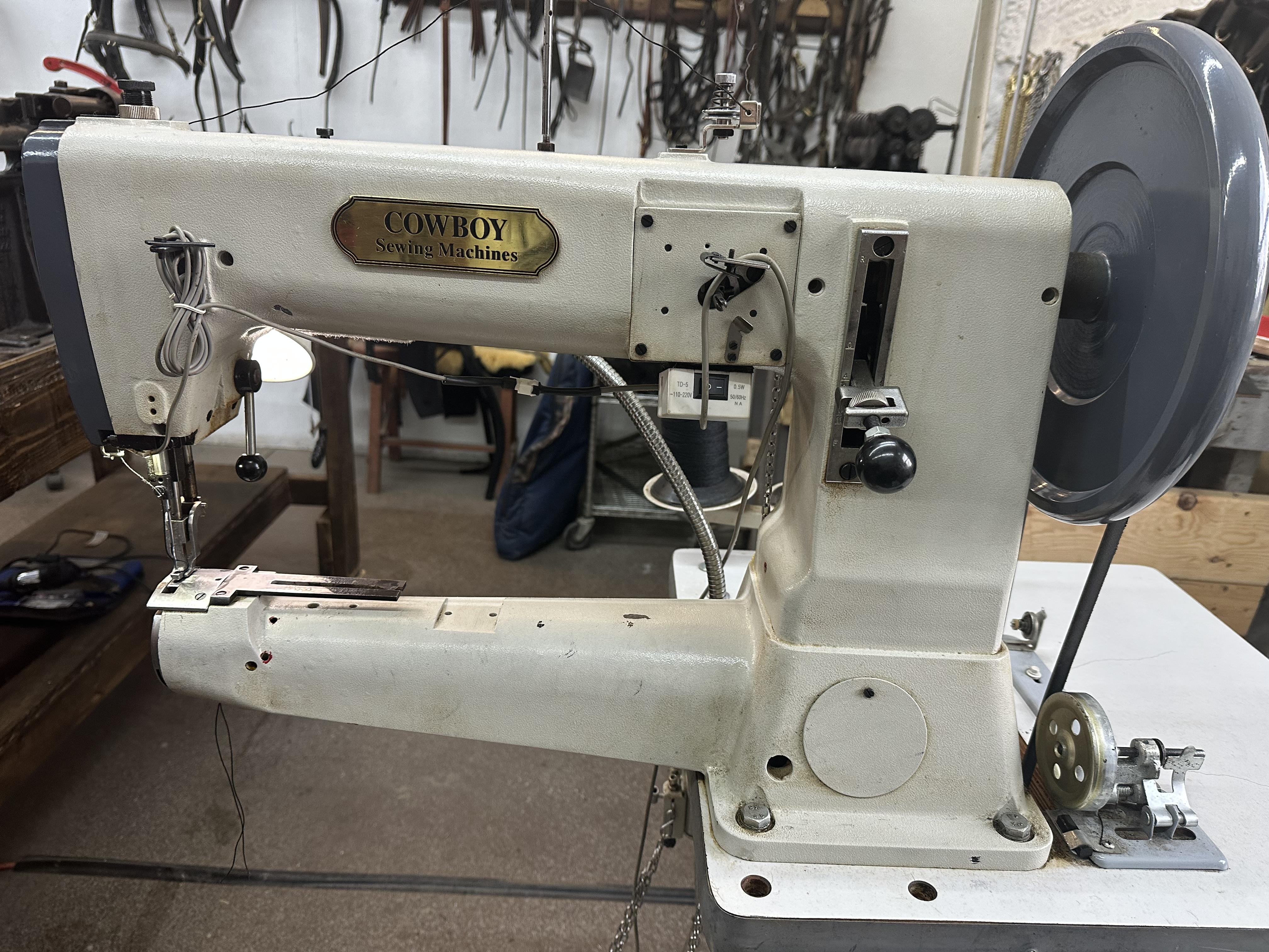

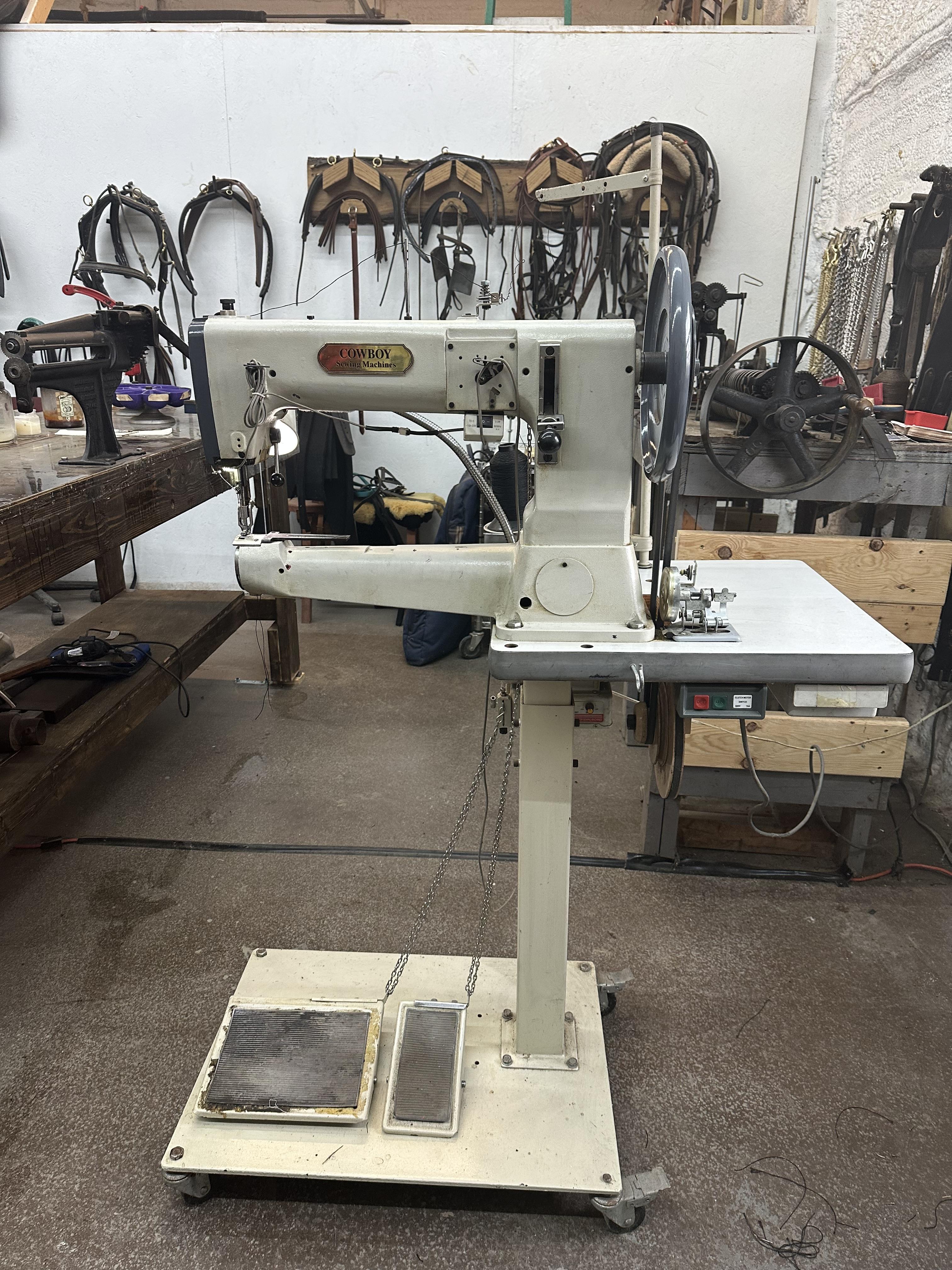

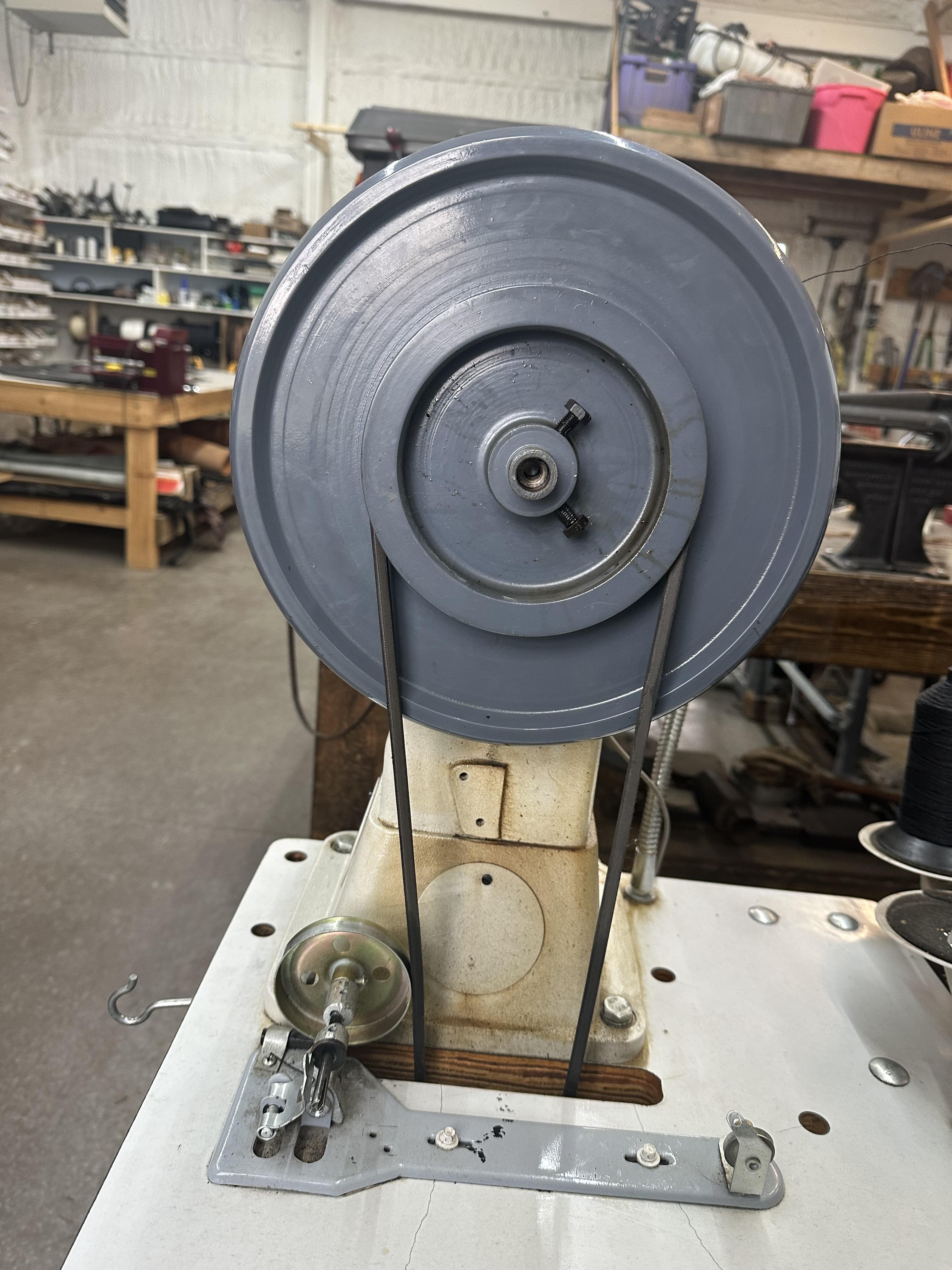

Used Cowboy leather sewing machine has been taken excellent care of! Reason for selling needed a bigger machine for specific use. Please contact me at (502) 295-6683 for more details. Can send video or FaceTime how it works.
