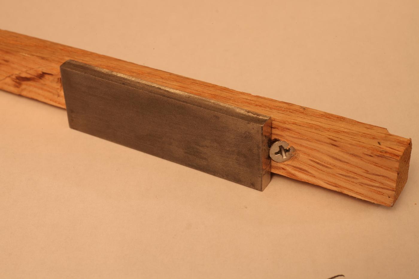

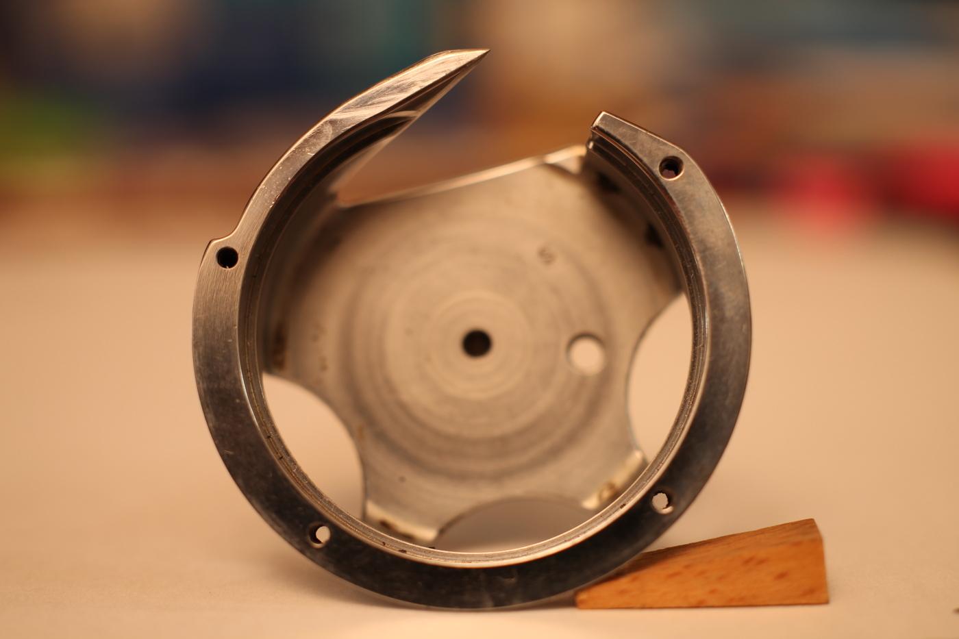

Here is the after photo: I can see now that the camera is not looking directly down the hook axis. Oh well..at least the before and after shots got the same treatment š¤·āāļø I faced the inside and outside edges of the hook using a diamond sharpening stone. Stone is 25x75x6 millimeters, on a 320mm stick of oak.

Considering that I couldn't find much for references, I agree that sharpening a hook is uncommon. I'm satisfied with the hook-to-needle timing, and I want a sharp hook with useful angles. So here we go... Here's the before photo, so you can see how rounded the tip of this hook is. Also note that the hook tip is positioned directly above the center of the hook in this photo, so you can imagine the arc swung by the hook as it intercepts the thread/needle.
I may be wrong (I have limited experience on machines), but I don't think sharpening the hook is common practice. I would think that the hook/needle interaction is more a matter of timing. Perhaps someone more knowledgeable will chime in.
