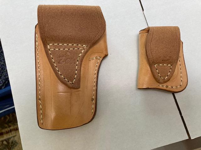

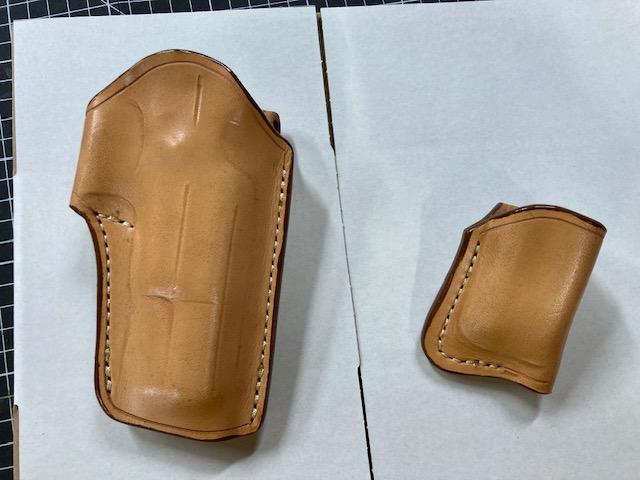

So was I right?
Jjp joined the community
Can you make another?
