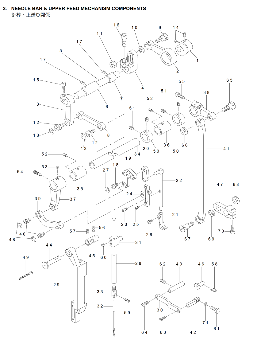

  2. On my machine (Pfaff) you set the needle into the centre of needle hole in the feed dog by moving the needle bar frame. This is the upper assembly that includes needle bar and upper feed mechanism. By my machines is always annoying to get some movements. How is this solved by Juki I rerally don't know. check on which axe the needle bar is hanging, is there and screw that you can loose, and than by rocking the wheel you push the whole assembly slightly to the left.

  5. Yes, that's the point. I need either to move needle bar or feed dog, depending on what is ajustable on this machine to have everything in line I just don't know how to do that. This is why I came here and asked

  18. Way back when I was only sewing for about 2 or 3 years, I bought two post bed machines with roller feet off some shoe maker who was going out of business. I used them to sew Marlon Brando style biker caps. I even sewed a Cowboy hat or two, and sewed patches onto ball caps. One day, I counted all of my sewing machines and discovered that I owned 13; a Bakers' Dozen! They included everything from a flat bed tailoring machine to a huge Union Lockstitch machine. That truly was a rabbit hole. Then, I moved and sold all but two machines. I eventually sold the big ULS and went into computer troubleshooting. I finally escaped from the sewing machine rabbit hole! Then, one day, as the computer troubleshooting was winding itself down, I saw a National walking foot machine for sale, cheap, nearby, and bought it. Y'all can guess what happened next... More rabbit pellets.

  25. Hello CowboyBob, thank you very much for this documentation. The needle to shuttle clearance seems fine, I believe the needle to hit the feed dog, as I can clearly see impact marks on the feed dog and also if you check on picture you can see that needle is too much on the left when going through feed dog hole Also, mine being a flat bed version, so I believe adjustments will involve parts that might differ
