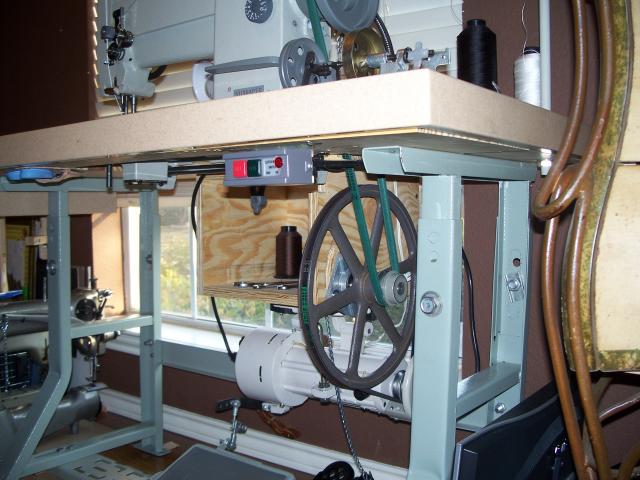

These are copies of Germans and Japanese position motors, I have Adler's from the 1980`s who came fully equipped with such motor. Sometimes it helps to look out of the window. However, the pro motors like Efka and Ho sing cost more; they can also do much more. They are in no need of a speed reducer and can be equipped with all kinds of extras like: Back-tacking, foot lift, thread trimmer, needle cooler and you name it....... The one I use on my 441 clone ( German Efka 1550-AB 321) has up 1800 watt and 8 Nm of torque, I only use the half of it. You might not need all this on a leather machine, nevertheless it makes all the upgrades possible if you need it later. They are small and can be placed inside machines or on the back side of the machine like on the pic. Or the traditional way under the table. Then the quality is superior, the ones I have from the 1980 still works very well. Price from 600 to 900 $, remember you do not need a reducer; then it is not that expensive. Tor
Shoes off, easy on the pedal and use your right hand on the fly wheel to as breaks. Here is a home made reducer one of our member made (pic one). If I have a machine with three phase motor who needs to be slowed down I use a frequency controller, it gives you full controller of the motors speed and many other parameters too. You can run it at one stitch a minute if you like. And it converts the motor in too a single phase so you can use it on the regular household current. Here is one. Tor
