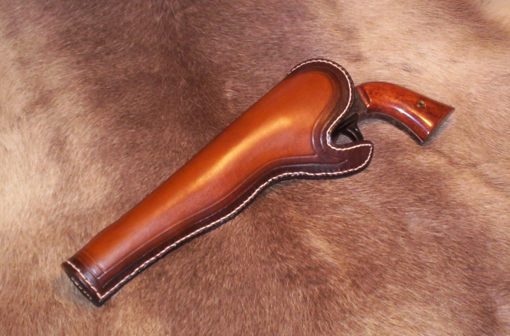

From my experience (and mine only) block dyeing does not always get the desired results. It's a little hared to control to get the "just right" effect. For the holster shown here, after I dyed the leather, I used a dauber to add the darker dye to the edges all the way around. I actually used a cigarette lighter to burn off some of the wool to make a more compact dauber to be able to control the amount of dye being applied. Experiment with this on some scrap pieces and you will get the technique down. Holler at me, Jim
From the photos I can see that you're not pulling the stitches too tight, so that's not the problem. You will run into leather that will tend to wrinkle after being dyed. This is not your fault either. Some cheaper leather you get can come from the belly which is a lower "grade" due its lack of body. Shoulders and backs produce the better leather even in the lighter weights. Also, it depends on who and how the leather was tanned. Herman Oak Vegetable Tanned is the best and is worth the money. Mexican Urine Tanned, RUN! Hang in there. Jim
