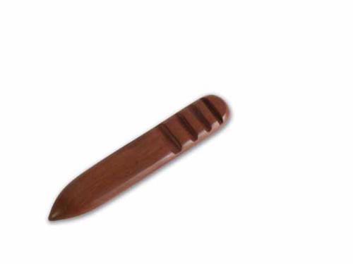

He Butch, now there's a rig to be proud of! I got a tip for the edging (being as you mentioned it.) There are a hundred ways to do it and they all work, but tthere is a quik and simple method using an Edger/Creaser like the one in the photo. When you finish doing what you do (so very well) to the belt and or holster, use a darker dye (dark brown or even black) and re-apply ir to the vey edge of the leather with a dauber. While the dye is still wet, use the small slot on the Edge/Creaser and rub the living daylights out of the egdes until slick and shiney. This can be done in short stages so you don't have to try to do the whole belt at once. After this, rub the edges down with Resolene apllied on a damp sponge. The edges on the holster shown here were done in just such a manner. Hope this helps and keep up the great work! Jim -

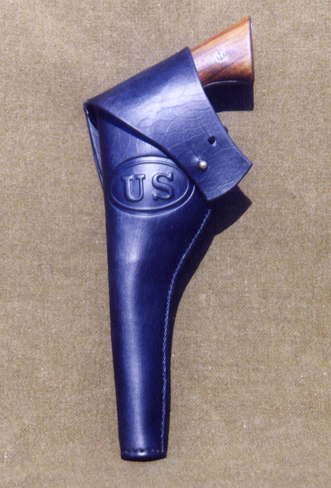

Howdy folks, I would like to y'all to take a look at this Holster Making Tutorial. This will take you step by step through making a template for any size or model Six Shooter all the way through to finished holster. The methods shown are those I have used to make lined and un-lined holsters for the last 10 years. Even if you have never made a holster, the instructions are easy to follow with text and photographs showing each and every step involved in the process. The difference between this method and others you may have seen or currently use is there is no Wet Molding involved to make a holster that fits right, tight, and out of sight. Feel free to download the tutorial and by all means, Enjoy! https://leatherworker.net/SimmonsHolster.pdf Jim R. Simmons Etowah River Productions

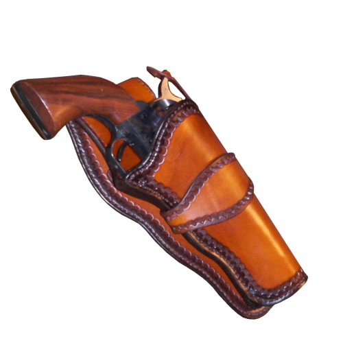

Dave, I developed a method for making lined holsters that does not require lots of tools nor lots of time to make. Truth be told, you how to make a fully lined and ready to use holster in about six hours. No wet molding required! The only drawback (if there is one) is that it requires hand stitching. I can also show you how to add retention without rubbing off the bluing . . . . much. If you you're interested, holler at me. The one shown here was made in about five hours and was ready to use right off the bench. Jim -
Great job on that Leatherjunkie. The Brazos Jack Pattern was the first set I published and the later I created and published three more that show how to make them just like you did yours. They too, are all one piece patterns with options for three sizes for the large to smaller frame pistols as well as different barrel lengths. The photo in my post is one of them. But I always admire a Crafter that uses a little imagination to make changes to suit their own needs. After all, that's what this Trade is all about - progress! Keep it up! Jim
