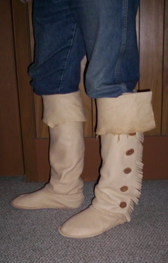

Eidnes Furs St. Maries, Idaho 208-245-4753 I have been getting deer and elk hides from these folks for 20 years and can tell you that I have never been disapointed. They have different grades for various project types and colors. They have garment weight and heavy weight for clothing, mocs, bags, and whatever you can dream of. Here are some samples of you can do with a higher quality buckskin. Jim

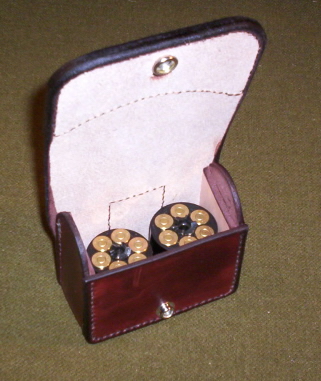

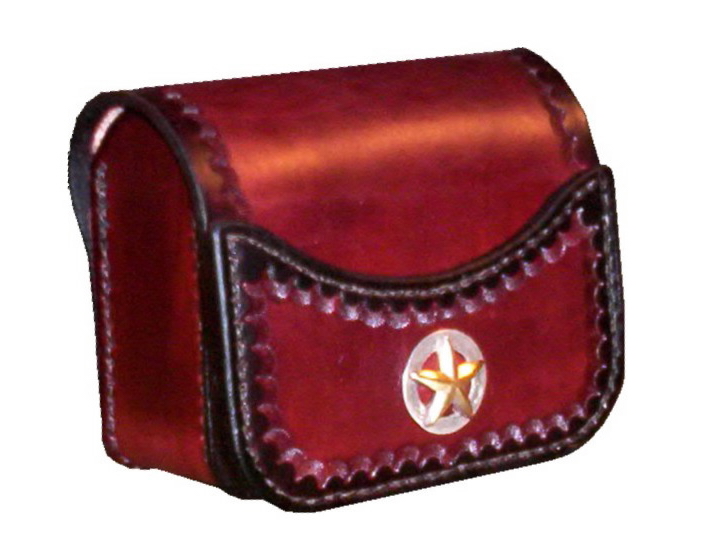

I think there is a type of machine that sews the angle stitch. I haven't seen one, but I have heard of it. I discussed this this with a fellow a few years ago who said I was "nuts" for doing this work by hand. I replied . . . "So, what's your point?" (See the cartridge box below.) With that, doing it by hand is a task, but it's not nearly as hard or time consuming as it seems. Once everything is laid out and pre-punched, it all goes together pretty fast. Oh yeah - Johanna, I'd be honored. Hmm, I just might write another book and elaborate the details further than the last two books.
Tat2, Okay, so it didn't take as long as I thought. I hope this helps you out. Holler if you have any questions, Jim Making_a_Leather_Box_1.pdf Making_a_Leather_Box_1.pdf
Tat2, Believe it or not this is not nearly as hard as it may seem. That is, if you get off the beaten path and take another approach to the problem. I've made dozens of this type of case and being self taught I use a method that is simular but different at the same time. (See: The Book of Leather Work.) The photos below are of a cartridge box made for a SASS Shooter and was made using the methods I will show . . . . later. I have to draw up a tutorial for you and put it in a PDF format so give me a day or two and I'll get it to you. This process can be done with just a little bit of practice and there is no glue involved if you want the best results. I'll be in touch, Jim
