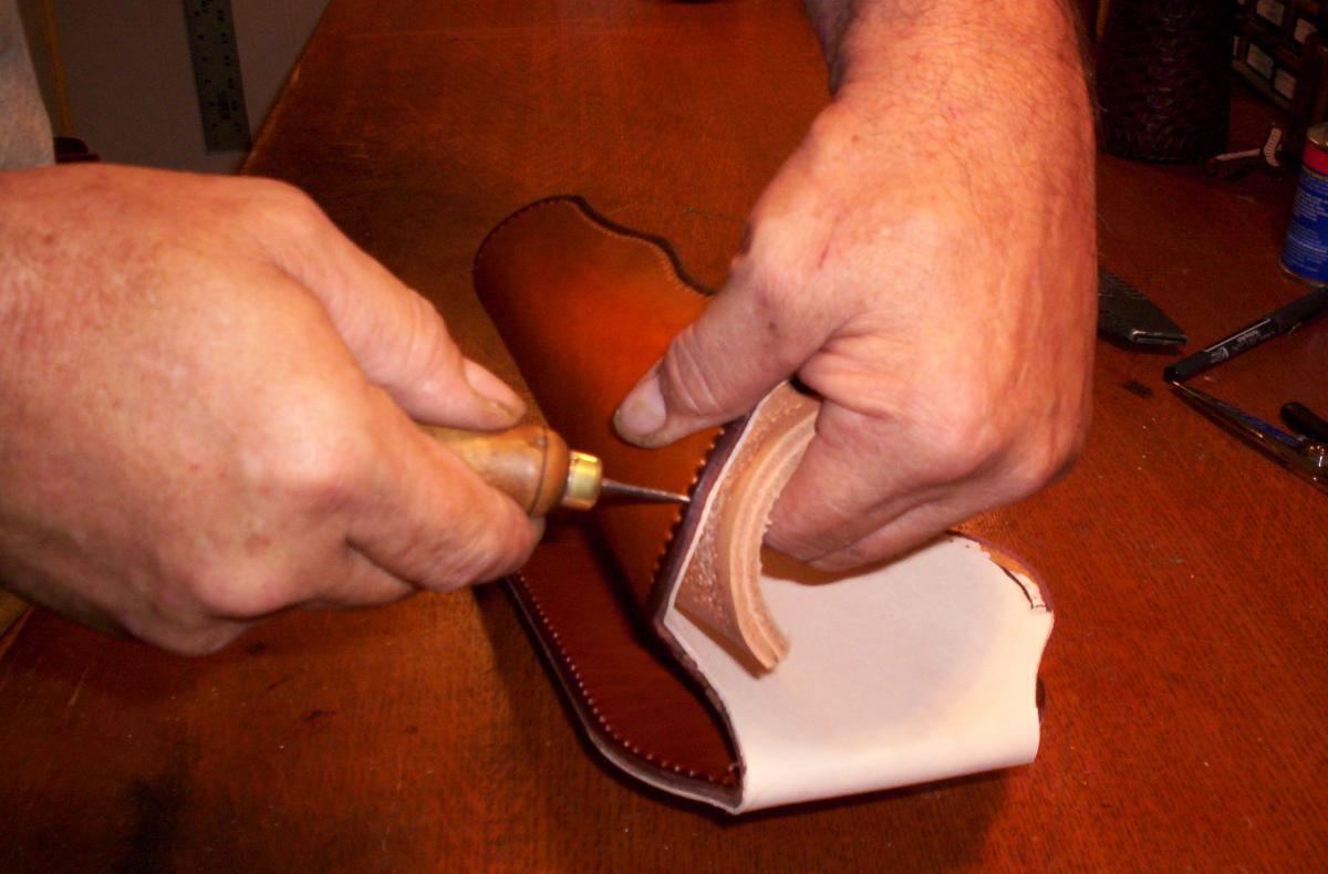

Sewing on the strap prior to molding will cause problems because the bonded layers will want to remain flat. Now, there is a solution to your problem. It may not be easier and using a drill (yuk) can be used but will require you to build a curved jig. In the photo you can see that an awl is used with a double layered leather pad to punch thru while the bonded leathers retain the curved shape. Not easier, but it works really well. Jim

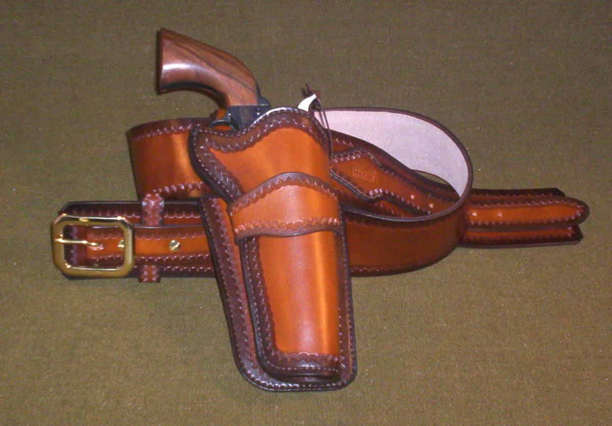

You're on the right track. The way to do this is to retrace the original Pecos Slim holster pattern and then draw the top of the holster about 3/4 of an inch down from the top. That's how this holster got its look. I just trimmed a little off the top of the original Callahan holster. Easy stuff. Jim
It's not that I don't want to sell the patterns commercially, I just don't know who is. That and I haven't gotten a commissions check in ummmm . . . . . what year is this? BUT, I do have a passel of patterns on the shelf that I do whatever I want to with. Kind of like the Callahan Lightning holster shown here. Ain't she a beauty? Jim
