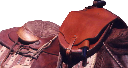

The instruction pages are letter size so you can print them on your personal printer. Pommel Holster Instructions.pdf Enjoy, Jim
Okay folks, let's see if this rascal will upload. I ofered to draw up a pattern for a Pommel Holster and I used the 1881 Pattern for the set. Give this a look see and try it out. VERY IMPORTANT! Burn the PDF on a disc so your local print shop can print them for you. These pages are Tabloid size (11 1/2" x 17".) Tell them to set the PAGE SCALING to NONE. If they set it to "Fit to Page" the patterns will shrink! Have fun, Jim Pommel Holster Patterns.pdf The instructions on the next post.
Hey Jim, I would like to make the same thing with flapholster (civil war or indian war model -- only have the civilwar model holster), but was thinking to place 2 straps of 2 inches on either sides on the topside of the holsters and a strap with a buckle on the underside of the holsters. would this help? BTW, where can I buy your patterns? Cheers, Gunter Ya know Gunter, I was thinking along that line. I figure it would be so much easier to adjust to the user's need if the stap or straps were adjustable to put the holster where they need to be so they lay corectly over the pommel. After all, in the absence of a saddle to use as a guide, I can draw up a basic design that y'all can modify to a good usable pattern once the angles and lengths are figured out. After that, you can attach any style holster for any size or type of pistol. As for where to buy my patterns? I believe Silver Creek Leather is still carrying them . . I think. I haven't heard from Greg Sartor in some time. Call 812-945-8520 and see if they are still offering them. If not, holler at me and I'll do something. Jim
Hmm, let me see if I can help you out with a pattern. (Pattern, I got!) First off, what type of the pistols, (Colt Army, 75 Remmington, etc.) What is the barrel length? I can take an exsisting pattern and modify it to the pommel holster. Being as I don't have a saddle anymore (dang it!) I will make it to where you can modify it for the length needed from the saddle horn. PM me with the pistol specs. Jim

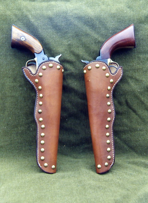

I see your point about the "fast draw" design, especially from Bob's point of view. But then again Bob is a World Fast Draw competitor - not a snake charmer. (I know Bob so I get to poke fun at him.) As for safety, well THAT should be first and formost in ANY holster design. It's possible to have a fast draw holster that is not only safe but allows easy and fast extraction of the side arm. The idea is for the holster to be able to keep the pistol IN the holster while the wearer goes through a normal mode of movement without a retention strap. The holster shown here is of such a design. Note the Hammer Loop: this was added because most competion sports such as SASS require them on the holster. This design allows a time of .4 seconds to draw, shoot, and re-holster - Adios rattler! But at the same time the pistol remains holstered even in a sitting position. So consider what might happen if you were to drop your pistol - even with an empty chamber behind the hammer. It's just plain unprofessional. My two cents worth, Jim

I tell ya what 6guns, it sounds like you already have half of what it takes - "The Want To!" The other half lies in a good pattern template and an attention to detail. Both of which are not beyond your reach. A holster is nothing more than an odd shaped pouch designed around an odd shaped object. If you read the Holster Tutorial I posted you will have no trouble getting your first holster made right, tight, and out of sight. I learned this the HARD way with a lot of wasted time and leather. My hope is that no one else has to. Good luck and have fun! -
