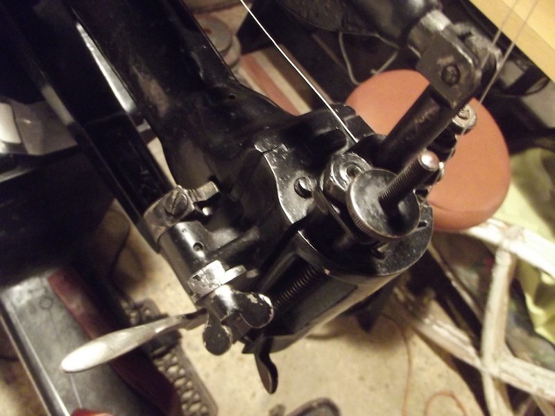

Sorry it took so long to get back to everyone on this. Here's a couple pictures I just took of the items Kevin's talking about. How should I go about adjusting the "follower" ? As in maybe raise the needle bar to it's highest point then move the follower down "X"mm ? I mean is there a standard? BTW - there's a log narrow spring that runs down the back of the sewing head and there is a visible screw for adjustments at the bottom of it... that adjustment screw on my machine is pretty nackered up, so it's been adjusted a bit in the past. Could it's arrangement be the cause of any of my issues? -

(The play by play ).... Somehow the machine started laying down a stitch. Don't ask me how to explain it, but all of a sudden it did. Maybe the thing was suffering from not being operated for ages before I got it. Anyway, there are two or three issues that I see now. First, the stitch length is a little inconsistent (some shorter than others) at times but not always. Secondly, the times when it IS stitching consistently, the widths are off from what they should be.. for instance the stitch regulator is set on 5 and I'm getting closer to 10 stitches. When I move the stitch regulator all the way down where it hits the presser foot (below the 5 mark) I only get 7 stitches at best (usually more like 8). Thirdly, occasionally when I'm sewing a sharp corner, the corner stitch (only) will come out and not complete that stitch. I notice this after I'm a couple stitches into going away from that corner. BTW, I've got it loaded with #92 thread top and bottom through a #18 needle... two layers of 3.5oz upholstery leather (I think). Comments/help/thanks ? -
