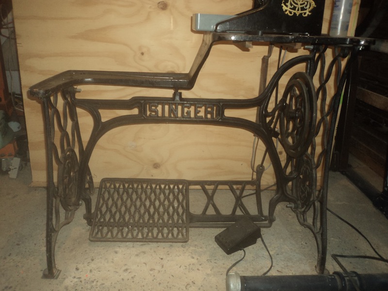

For Sale: A 1919 model Singer 45K25 cylinder arm machine in good working order. This machine is the workhorse that has been a staple used in tack and saddle shops for ever. It is to my understanding basically the same machine as a modern GA5-1 and therefor will use many of it's parts such as pressor feet etc - I've been told (I haven't actually bought any and tried ). This machine comes with one pressor foot (a left side zipper type foot). It would benefit from a roller style pressor foot which I would definitely add if keeping it. There is no leather belt on it for the foot treadle, but they're pretty cheap - however, it does work fine by the hand wheel as it is. There are 4 or 5 extra bobbins and a handful of needles included. The original cast iron treadle and bi-level table top are in good condition as is the head of the machine too. There is some chipped paint as you'd expect from a machine of this age. The treadle has a nice original wooden pitman-arm (see pic). I'm located in Dallas, TX. and would rather not ship though I would consider it. I could also possibly deliver it to the Wichita Falls roundup show that is coming up soon too. Note - the picture of the stitches included adjustments to the stitch lengths. See my other add for a Singer Patcher. I'm Asking $700 for this machine. Let me know if anyone needs more pics or if I can answer any questions about it. Thanks ~ Doug

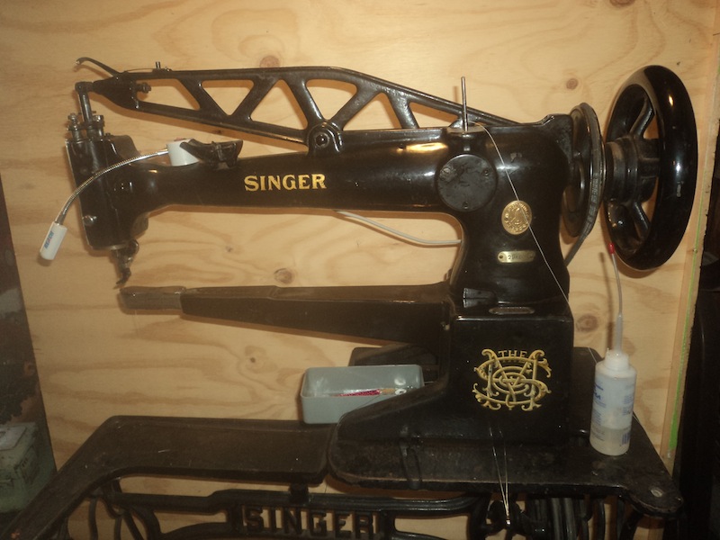

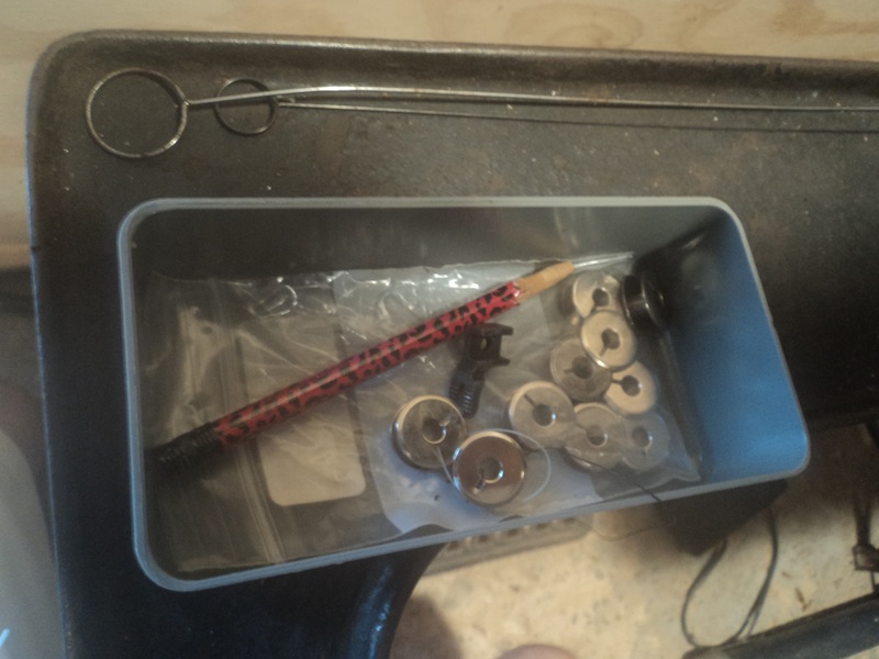

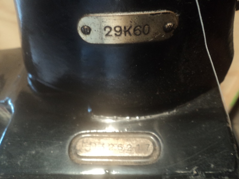

For Sale: a 1945 (if I recall correctly) Singer long arm patcher machine, model 29K60. This is one of the models with the larger bobbins (several extras are included as well as an extra pressor foot). I've installed a small but powerful motor to assist with long straight runs. It works great but two small issues I want to make known is that the pivot bolt for the hand lever on the back is not original (just the bolt) but the lever works well and raises the pressor foot just fine.. and secondly, the darning tensioner is missing from the front of the head - I've never had a need for this feature but they can be sourced fairly easily. I'm located in Dallas, TX and would prefer not to ship, though I may consider it anyway. Also, I could possibly deliver this machine to the Wichita Falls, TX show that's coming up soon. Asking $700. I can get more pics if needed or answer questions if anyone has any. Thanks ~ Doug
