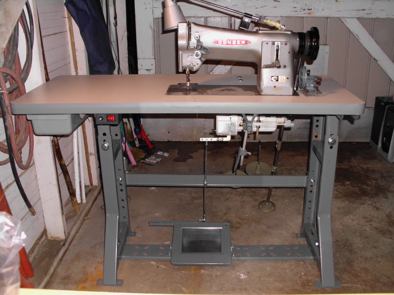

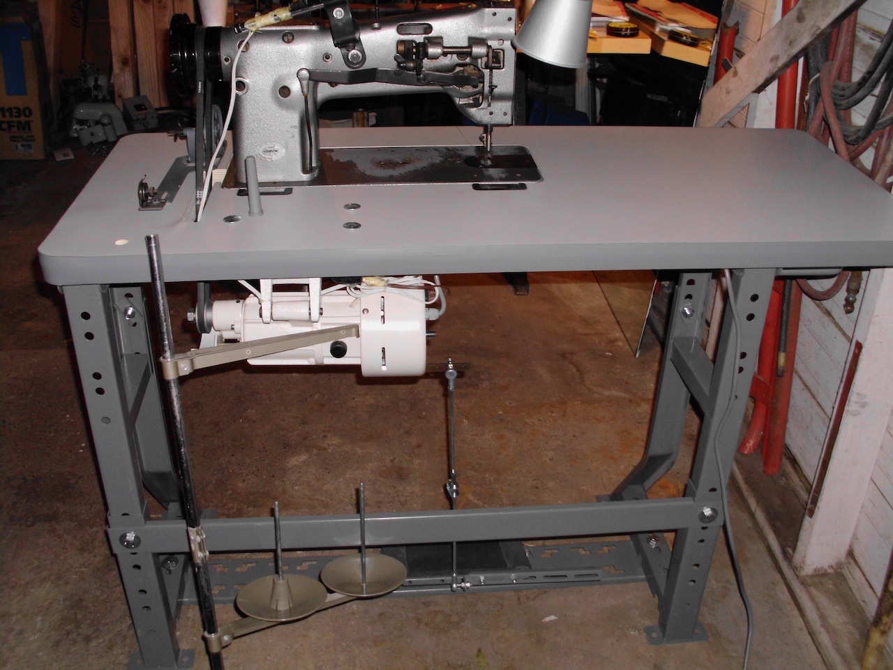

  10. Consew 206RB pics:

  23. I'm selling my Consew 206RB (flat bed walking foot machine), in very good condition, has brand new K-leg stand and table top. This one I believe was the last model made in Japan, very good quality. Local pickup in Dallas, TX. preferred. I will try to post pictures of it soon.
