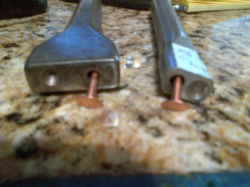

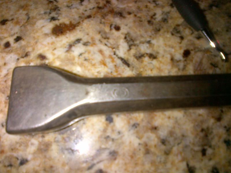

These are a couple of tools designed to gouge a groove to make box corners. Kind of expensive for one or 2 uses though.
