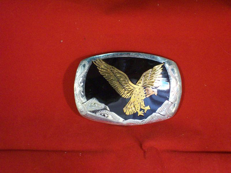

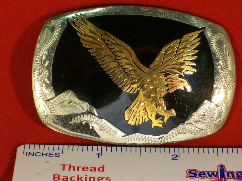

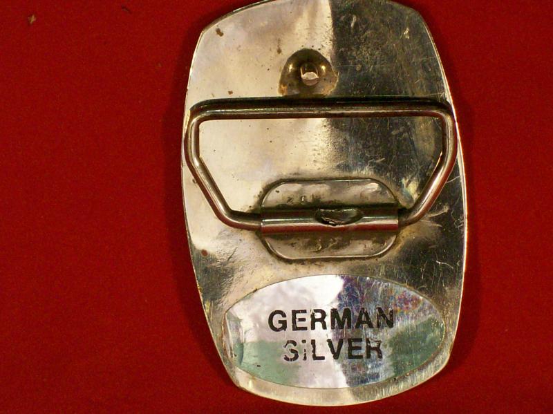

I picked up this buckle and need to figure out what it is and its value. it looks like silver around epoxy resin with brass and copper or bronze inlay. The back has a paper tag that says German Silver. Any thoughts or opinions? Thanks Tom
