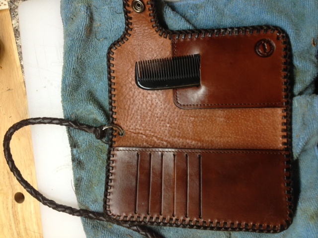

  1. I picked up some kangaroo from Springfield leather and this is what has come from that.

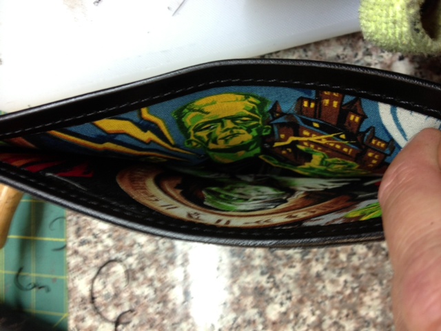

  3. Thanks all. Matt the card liner is nylon fabric cut into 6 by 2 inch rectangles. I use an eyelet 1/4". I haven't had one failure to date with this setup. I use the Tandy die press to set them.

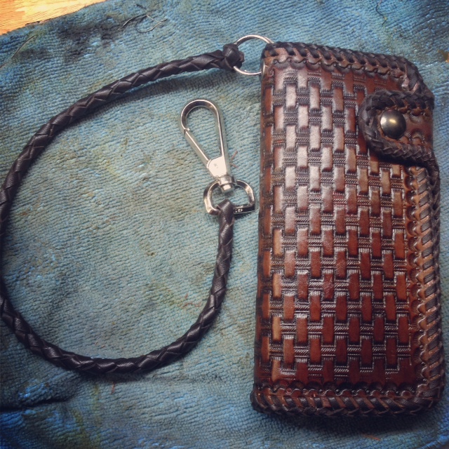

  5. Made with Herman Oak 4/5oz lined with pig and laced with kangaroo both on wallet and the tether.

    Thanks Megabit. I watched some u tube videos and I think I will attempt the crown knot.
  8. Hello all I want to make a simple 4 part round braid for a biker style wallet instead of a chain. I understand the braiding part but my question is how to finish it. I plan on starting with (2) 1/4" strands ran through belt loop clasp to give me 4 strands to braid but no sure how or terminology of how to secure key ring on other end. Any help with terminology or suggestions would be great. P.S. simple preferred as I don't do much braiding. Thank you all in advance

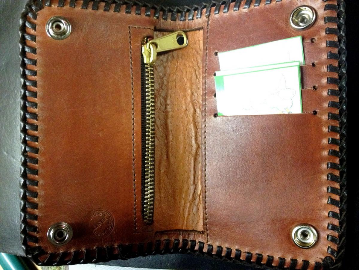

  9. Hello all Just delivered a newly designed 6" wallet. It has 4 card slots and a zippered pocket. As always laced with Kangaroo. BTK= Billy the Kid not the serial killer!!!!haha

  11. looks great the only thing I see is that the zipper opens from bottom of wallet to top. I install my zippers the other way. Color and construction look awesome to me.

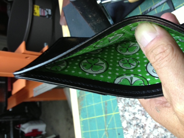

  13. BillyMac the pockets are made of nylon and glued. They are individual and in the shape of a "U" Keeps the bulk down. Andy I use #5 zipper I usually buy in bulk from Springfield or Tandy and cut to length. I cut the zipper the full width of the pocket then cut out just the teeth and leave the nylon material after the opening in the leather. This is so when I stich them the ends also get stitched. If you are only doing one you can get a nice brass zipper at Johann's for around 4 bucks and look online usually a 40% off coupon every week. You're in La Vern we are pretty close I'm in Hemet maybe about hour or so from each other. I really like the briefcases you make they look great.

  17. I use a nylon strip that I glue to the back and then line entire back with pigskin.
  18. It is a nylon strip that is glued down keeps it thin
