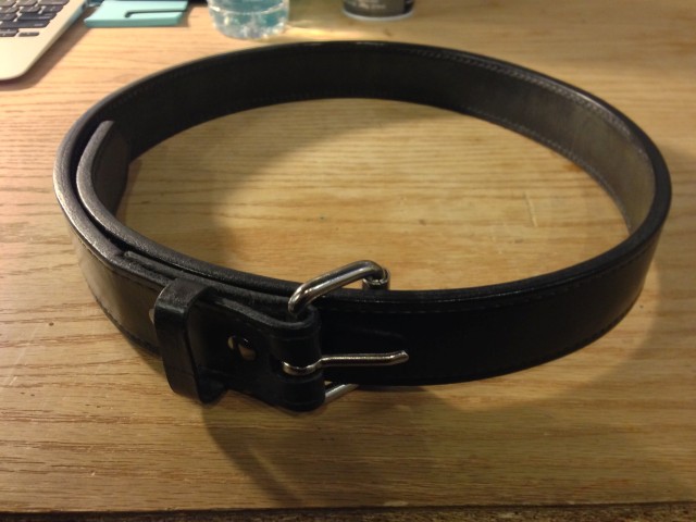

I looks like the leather was rolled backwards. Flesh side out. That will always make wrinkles like that.
When I do a double thickness belt I stop the second layer about a half an inch before the first chicago screw hole. This allows me to fold the outer layer back for the buckle end and it winds up the same thickness as the rest of the belt. no skiving is needed this way. Hope that makes sense. My first try at a double belt, from a few years ago. It's not the best but it shows what I am talking about. The back end of the fold lays flatter when I make then now a days.
