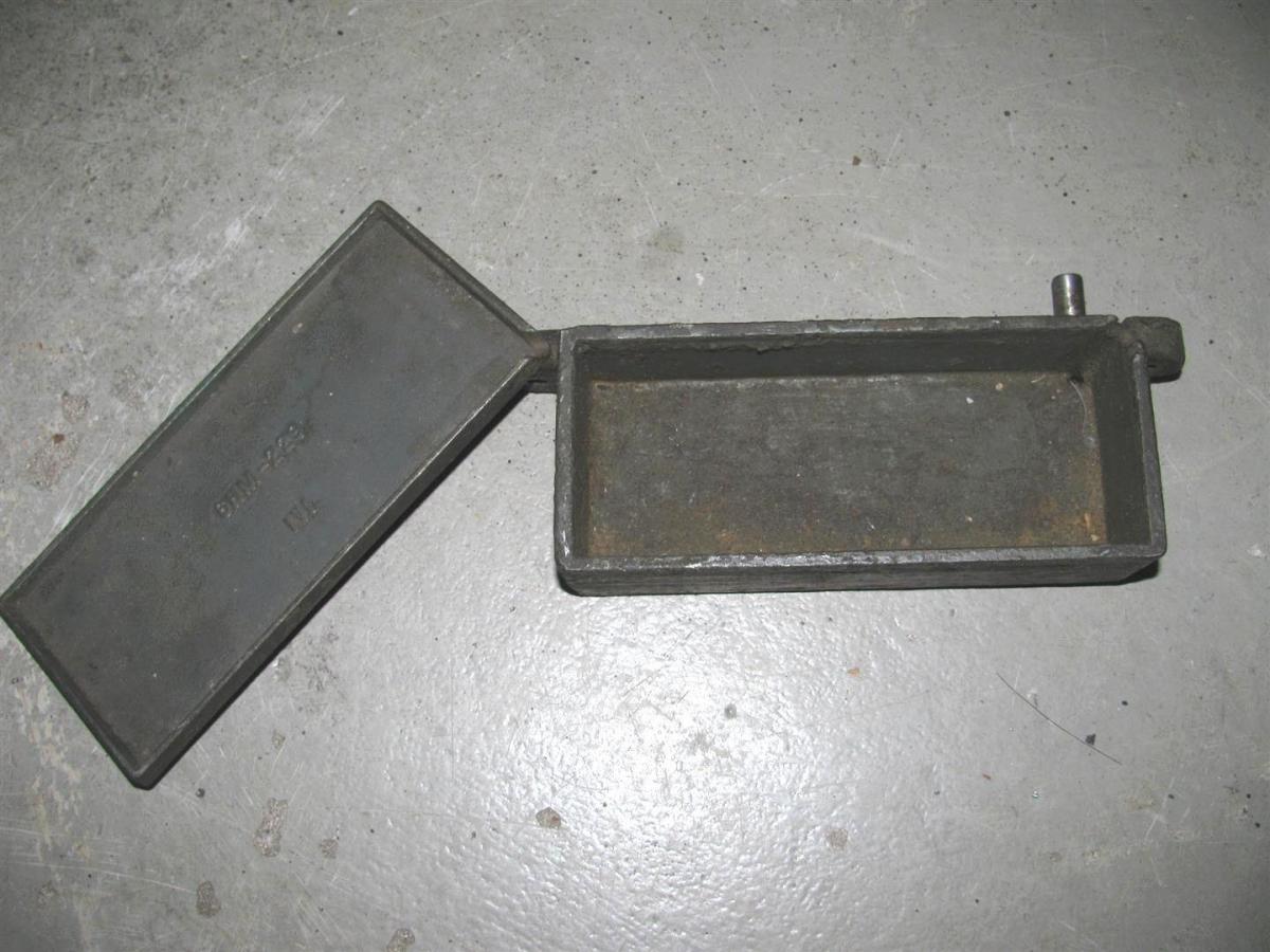

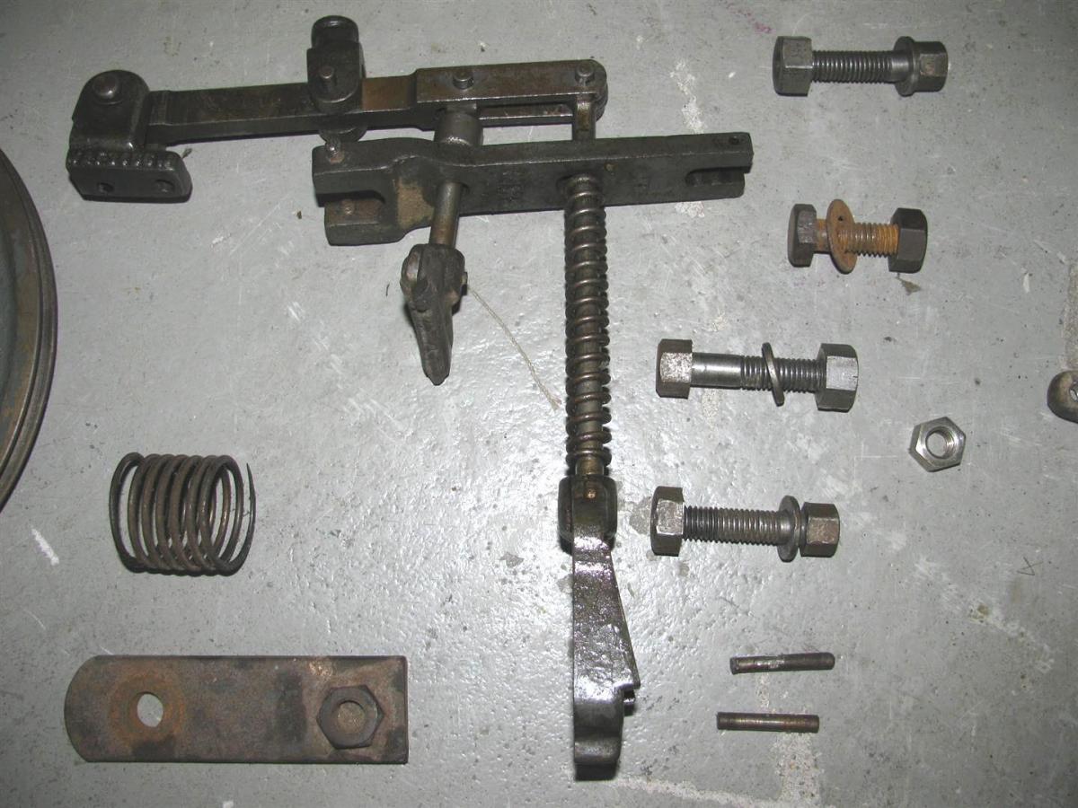

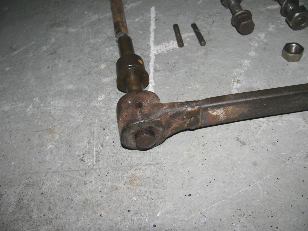

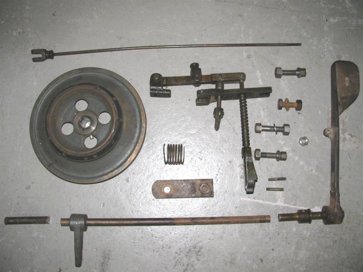

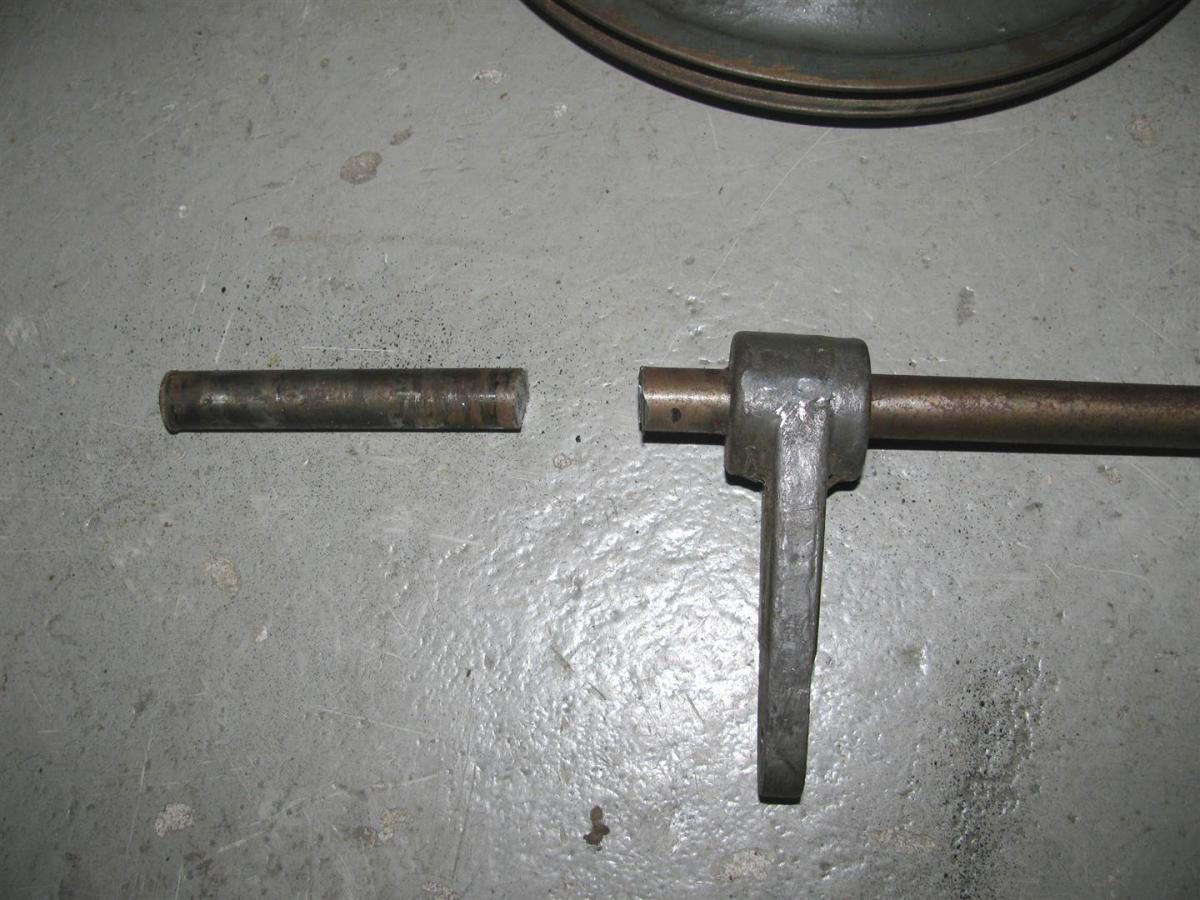

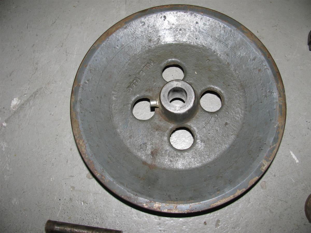

Do I Have A "complete" Busm / Pearson #6 - Or What?
Constabulary replied to Constabulary's topic in Leather Sewing Machines
I was able to locate some parts. Shuttle cover even seems to be NOS. My original shuttle cover had no spring so I bougt the complete unit. Hope the needle plate screws will fit... -
