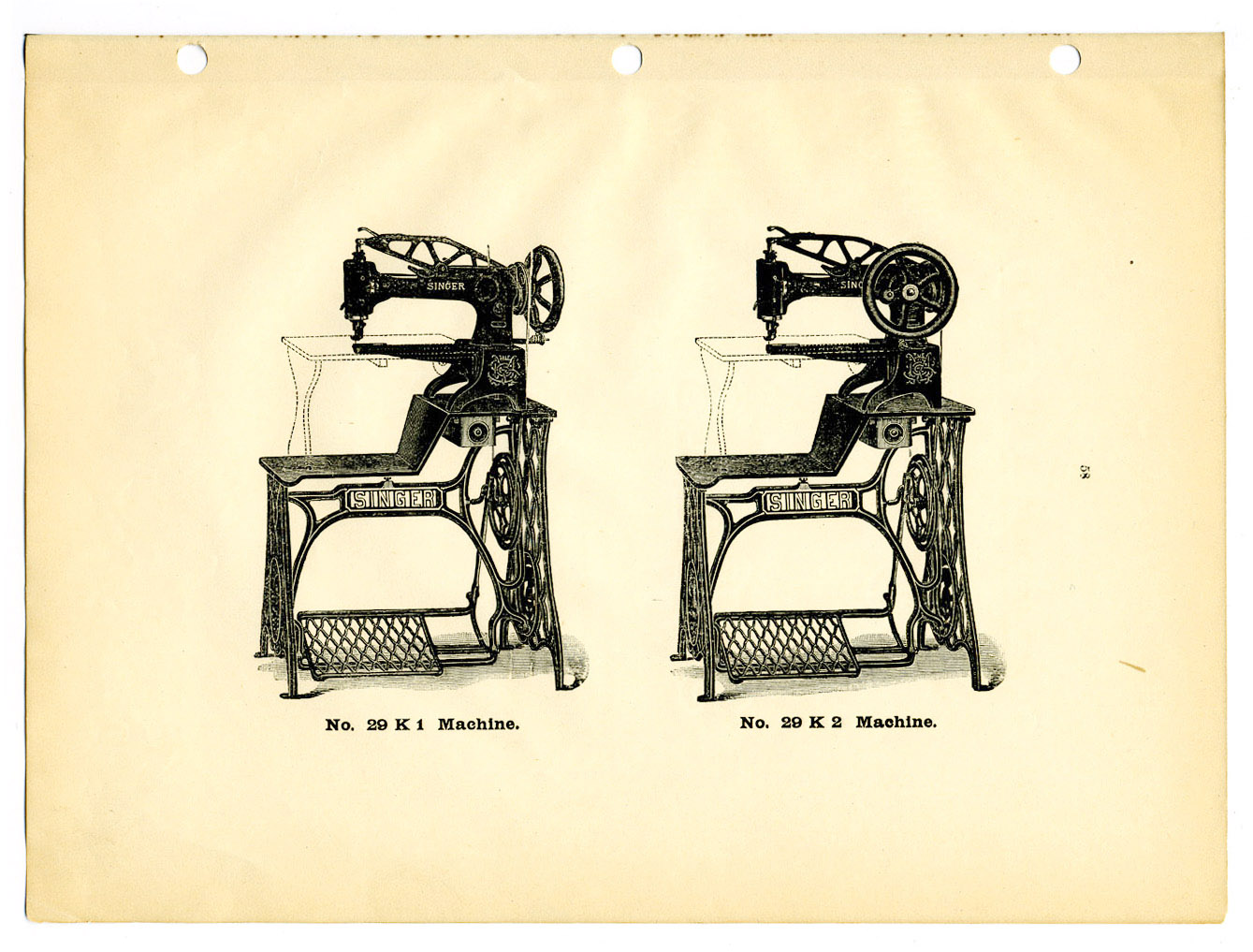

http://www.sil.si.edu/DigitalCollections/Trade-Literature/Sewing-Machines/NMAHTEX/2753/ Hi Folker, here is the link for the full catalouge if anybody is interested. yes maybe it was just called the 29k17 or the 29k22 after?? here is the binder and the two top and bottom feed options. (this one is on my make list) here is the link for the parts book for the singer 29k if anyone is interested. did you buy this sv3 machine?? http://dixiesewingmachine.tzo.com/MANUALS/SINGERPARTS1/29K1%20TO%20K4,K10%20TO%20K18,K12%20TO%20K23,K30%20TO%20K33.pdf- 18 replies

Hi Folker,Yes that is the one, you can see the clamp almost in between the two bobbins? or maybe the two screws for the bobbins pass through the plate and into the arm?? the binder is on the opposite page you posted. maybe some day someone will find some information about the SV versions and what they were intended for??- 18 replies
