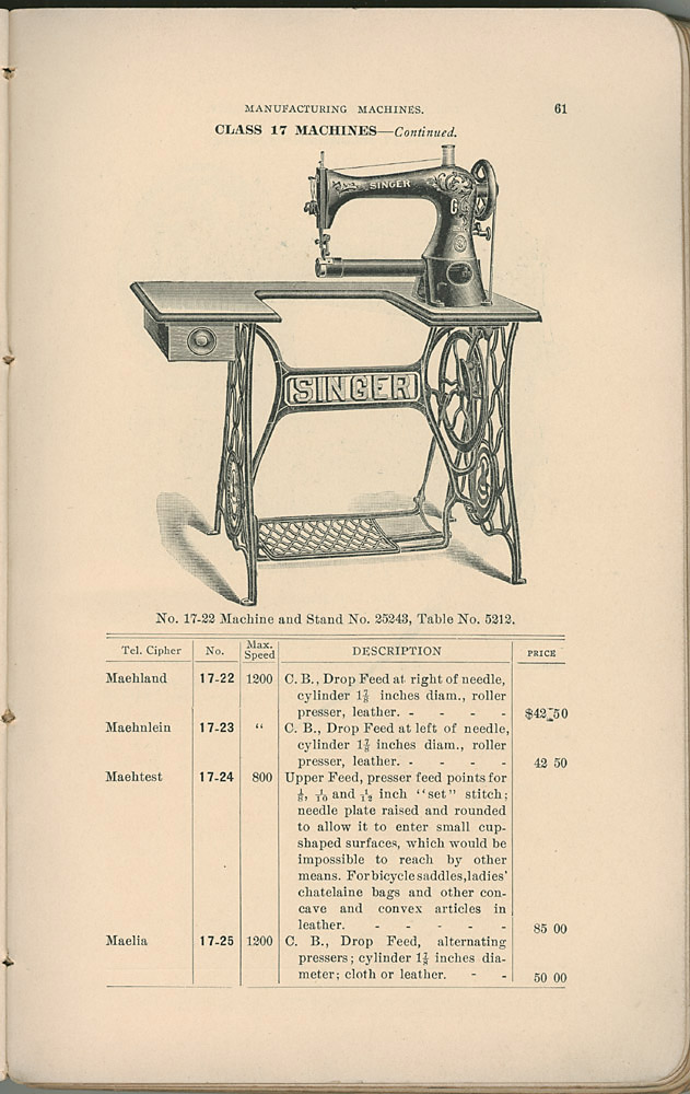

In the pictures the feed dog has big flat spots, adjusting the height wont fix it i reckon. unless you file them to a point again and then you will possibly have to widen the elongated hole underneath on the bottom side of the feed dog. the other option is get someone to TIG weld the top of the feet and then file them down again to the original height. you might even find some new feed dogs somewhere on the net?? but you will probably have to change the needle plate also as two rows of teeth are probably not out there for the class 17 machines. http://stores.ebay.com/SHARP-SEWING-SUPPLIES/_i.html?_fsub=439427819
Here you go. http://dixiesewingmachine.tzo.com/MANUALS/SINGERPARTS/17-1%20-%2017-30.pdf not much else out there?
