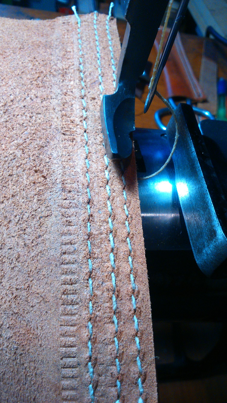

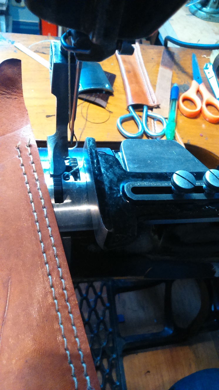

	No Problem, just a quick update on the binder. i have just made a new needle plate and as i imagined this one looks as if it will work better although i have to try it out a bit more. you can see in the picture that the feed dog does not feed on the binding as now it only has the left row of teeth feeding. i did not find this information from the groups of accesories in the parts book for the 45k21,25 etc.. the only needle plate for the 45k21,25 etc with a single row of teeth to the left has a knife setup with it. so this needle plate is not present in the parts book?? there is only the right hand one?? although i supose on a tight corner it might touch the binding ?? not sure. now i will finish the plate and try another run.

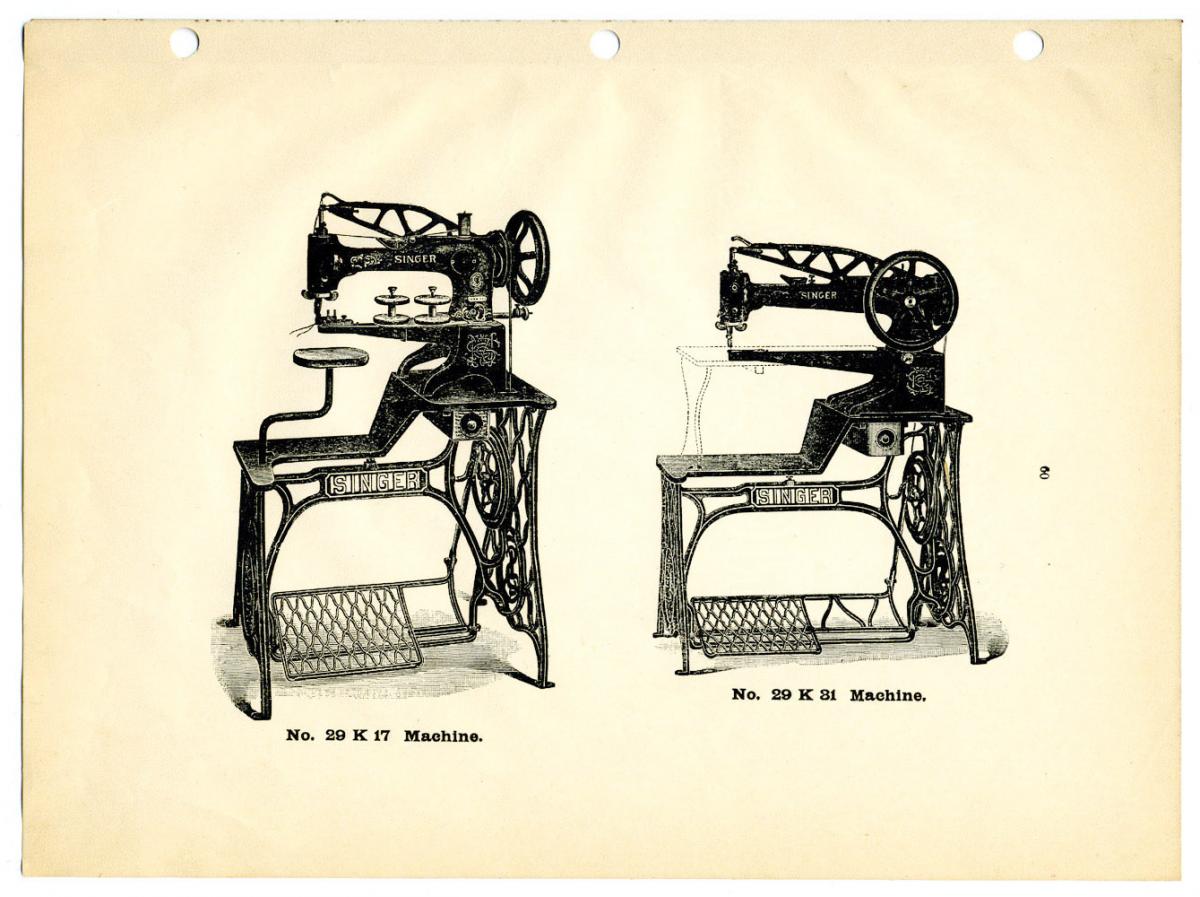

	http://dixiesewingmachine.tzo.com/MANUALS/SINGERPARTS1/29K1%20TO%20K4,K10%20TO%20K18,K12%20TO%20K23,K30%20TO%20K33.pdf plate 168 part nº 81993 and 81925 were top and bottom feed binders made for the 29k17,18,22,23 no welting as far as i know. maybe you could make a similar one for welting?? when i get time i will surely try to make one for mine. regards jimi.

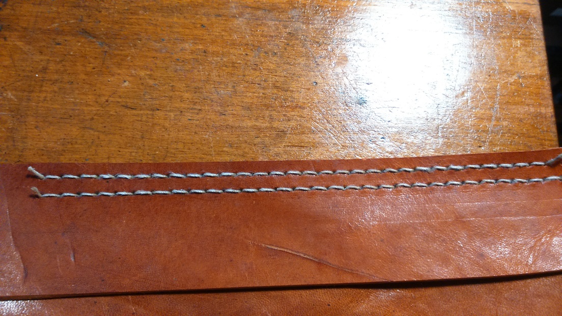

	this is another option but you would be in the same boat? you would need the foot to go with this needle plate which has a modern type binder incorporated, or try to fit one on to your 45k somehow?? this looks like an Adler machine not a singer 45k so may not fit. whese binders are easier to use compared to the older type ( just my personal opinion). but the one in the picture might possibly have the same problem with veg tanned leather leaving marks on the bottom. unless it is a needle feed or jumping foot?? also that is just a small straight run of binding, when it comes to curves etc??? it gets harder to keep it in line, but not impossible . if you use chrome tanned leather i am sure you will get less marking on the bottom side of the binding. i will have look and see if i have some around and will do a test to compare. hope this helps.

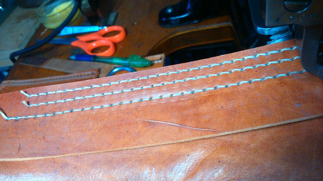

	as you see i used some veg tanned leather as this marks very easy on the bottom side due to your feed dog. then the next picture shows if you wet the leather then smooth out the marks it is not too noticable. if you want to bind say the edge of a bag or something similar where both good sides of the leather are facing outwards then the left hand row of teeth will mark your leather.
	the width i used for this is 21mm wide and then i creased it to help keep the shape. you need to keep the middle piece of leather pushed up against the right side guide and also make sure the top side of the binding keeps up against its small arm guide, and hope the bottom of the binding keeps up against the small guide on the bottom of the foot, which is the step. it is not that easy as you think, but the more you try the better i am sure you will get.
	Hi there, seems like you have picked a hard one here? i have done a couple of short runs at binding and personally find it challenging? hahaha! as we are talking about and older machine which seems to me needs a bit of time to master unlike the modern binders. first of all the binders that came with the 45k machines can take a bit of time to find, unless your machine came with all the parts for that operation. i had to wait a while to find one for mine and in the end it was an adler binder which is the same as the singer ones. then you would need the presser foot #85753 which is the one for this operation. i will leave the linen thread in that i used for your other post and sew a small piece.

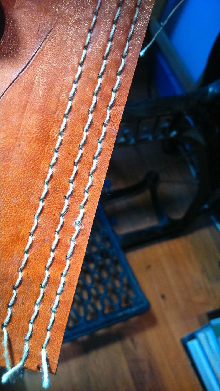

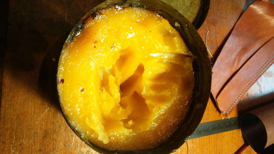

	Hi Nate, i think the needles should be about 21-25 that is what iam using at the moment (when i have time) with T207,T270 bonded nylon thread. i have only done two test runs with the linen thread and it turned out nice, i dilluted some old floorwax with turps then added a small amount of silicone oil and put it through the oil pot and it worked out well. this is the same as using beeswax, melting it down then adding turps "once it is away from the cooker" the linen thread is 18/3 cord the bobbin thread was not run through the wax, just the top thread and a nº 24 needle was used. it is a sticky sort of pull coming through your tension units so i had to back the tension all the way back on the first one then on the second wheel tension just go the half way around it, not the one and a half turn otherwise is resists too much.( at least for me).
