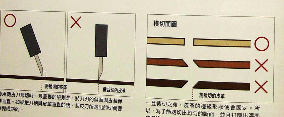

right handed version has the bevel on the left side - holding the knife like an exacto for cutting, tip facing down. For paring (bevel facing down) for cutting out patterns using a ruler its terrible IMO. I skive right handed, left to right so the angle on the right hander is \ which is the one you want if you skive the same way. The picture on the website the knife on the bottom is the righty. Picture 2 shows how to use a right handed Japanese leather knife, tilting the blade. A cutting knife with a chisel grind dragging along a ruler you want the LH version unless you want to tilt your knife while you cut. Pic attached worker skives bevel up, instead of bevel down so skiving can be done with a lefty or righty. Hope this isn't too confusing.
