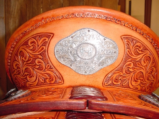

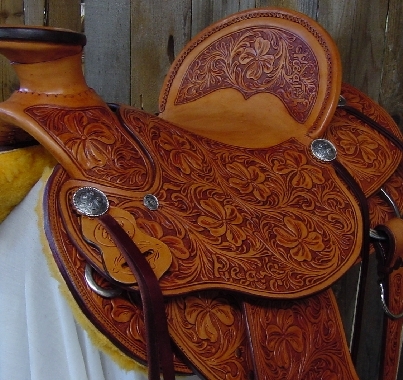

    Yes I do draw all my own tooling patterns. It takes up a lot of time, but I draw new patterns for almost every saddle I build, unless the customer picks out a tool pattern that I already have drawn. But I find it more fun and freeing to just draw new patterns for each job, not to mention it brings a lot of uniqueness to the piece. Here are some closer pictures of the tooling on the wade from before. This saddle is the Centennial saddle that we built for the 4-H of Texas. This was a very fun saddle to build and it was for a wonderfull organization. The saddle will be given away at the Centennial kickoff in October. All the silver on this saddle was done for us by Tim Hansen of Hansen Silver in California...wonderful work.
