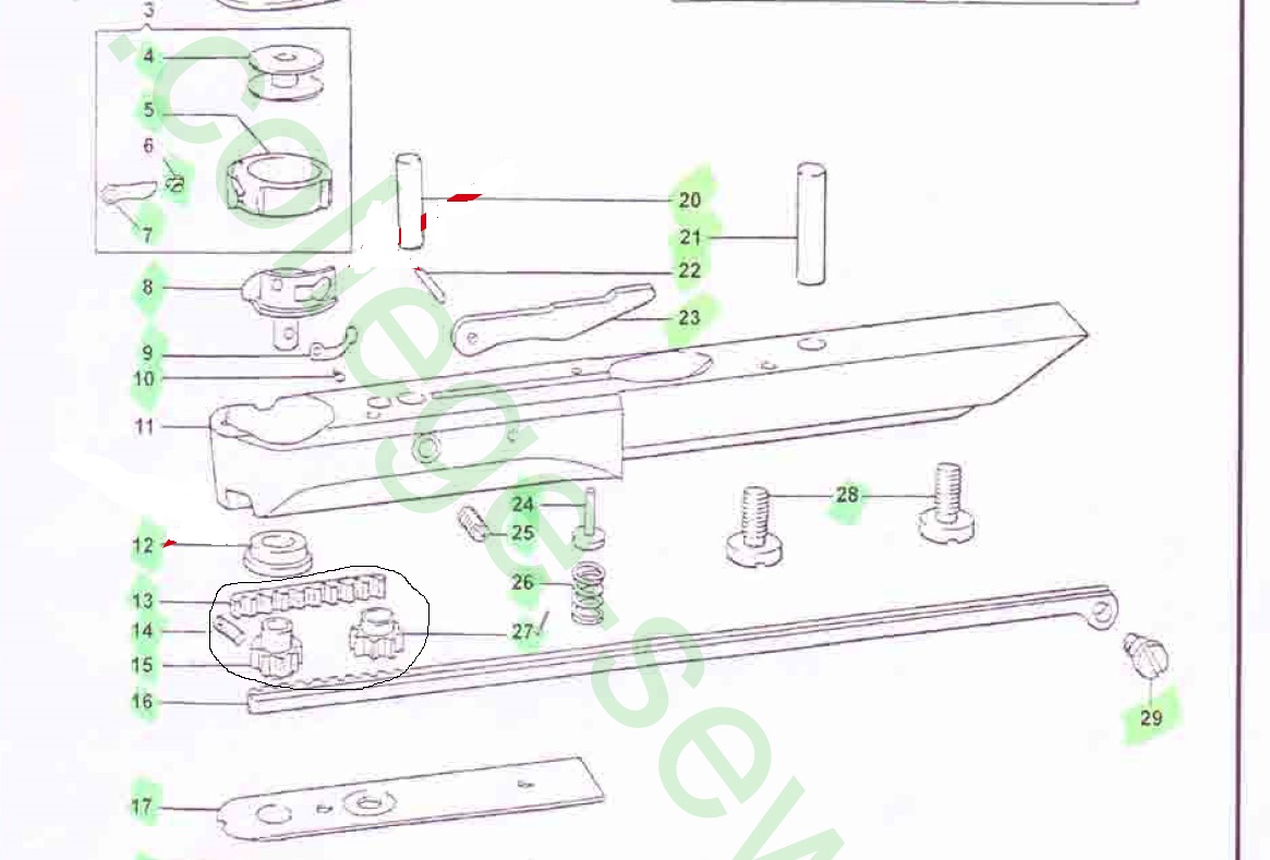

I copied your Dropbox schematic from College Sewing and attached it to this reply. I circled the parts in black that are probably causing your problem. Your bobbin doesn't move back far enough to catch the thread at the needle for the bobbin hook to catch it. This is probably caused by these worn parts. What size needle and what size thread are you using? The machine can only use the 29-4 needle and thread is limited to size 92. Hope this helps good luck to ya'.
