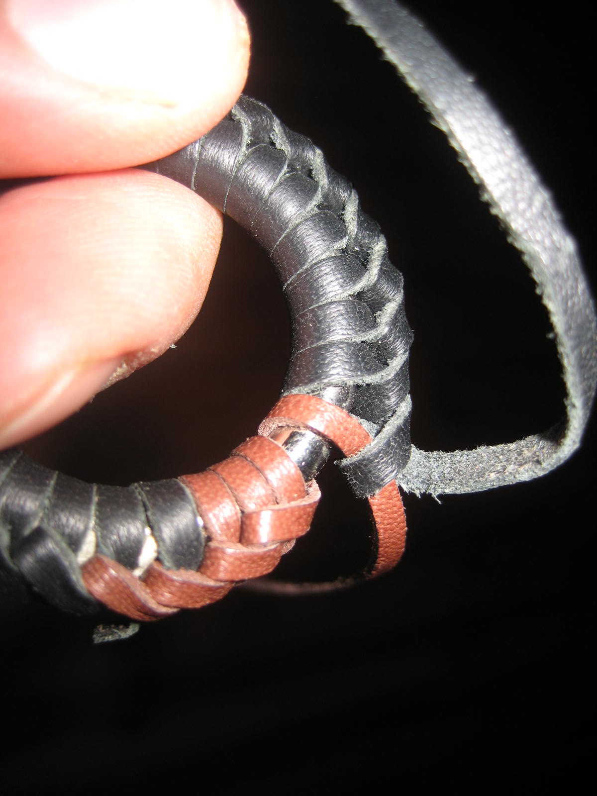

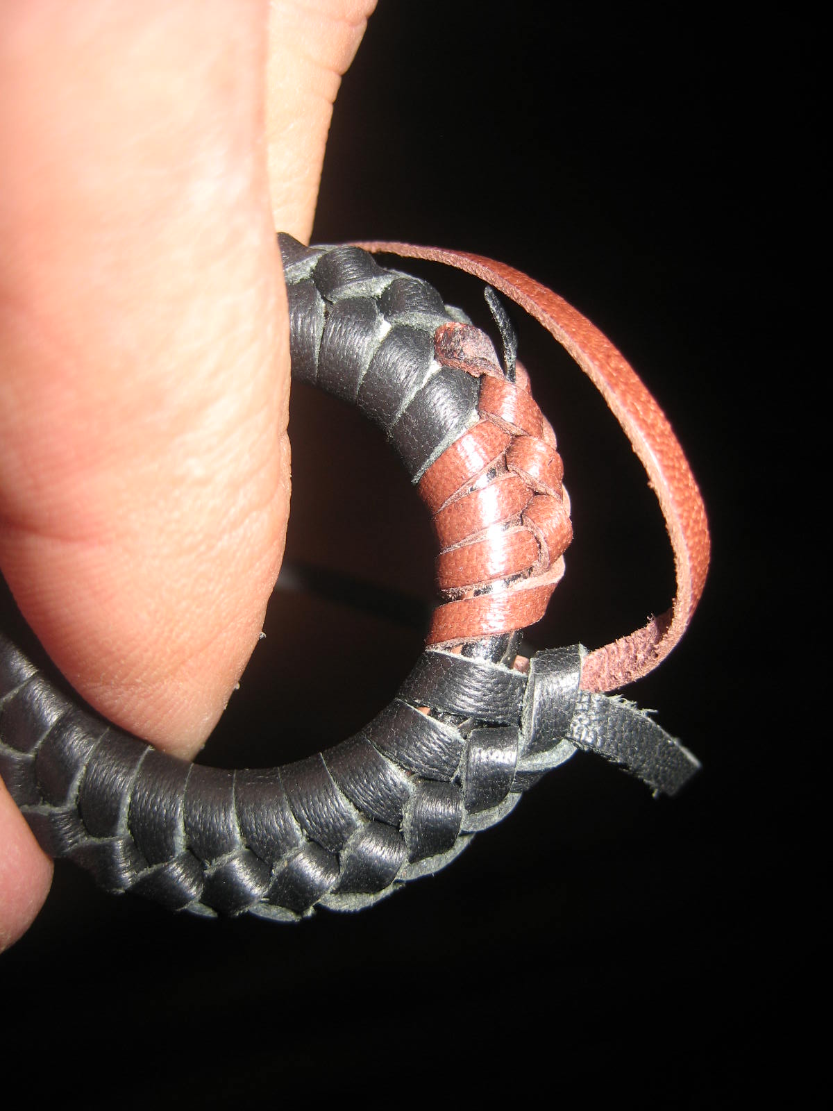

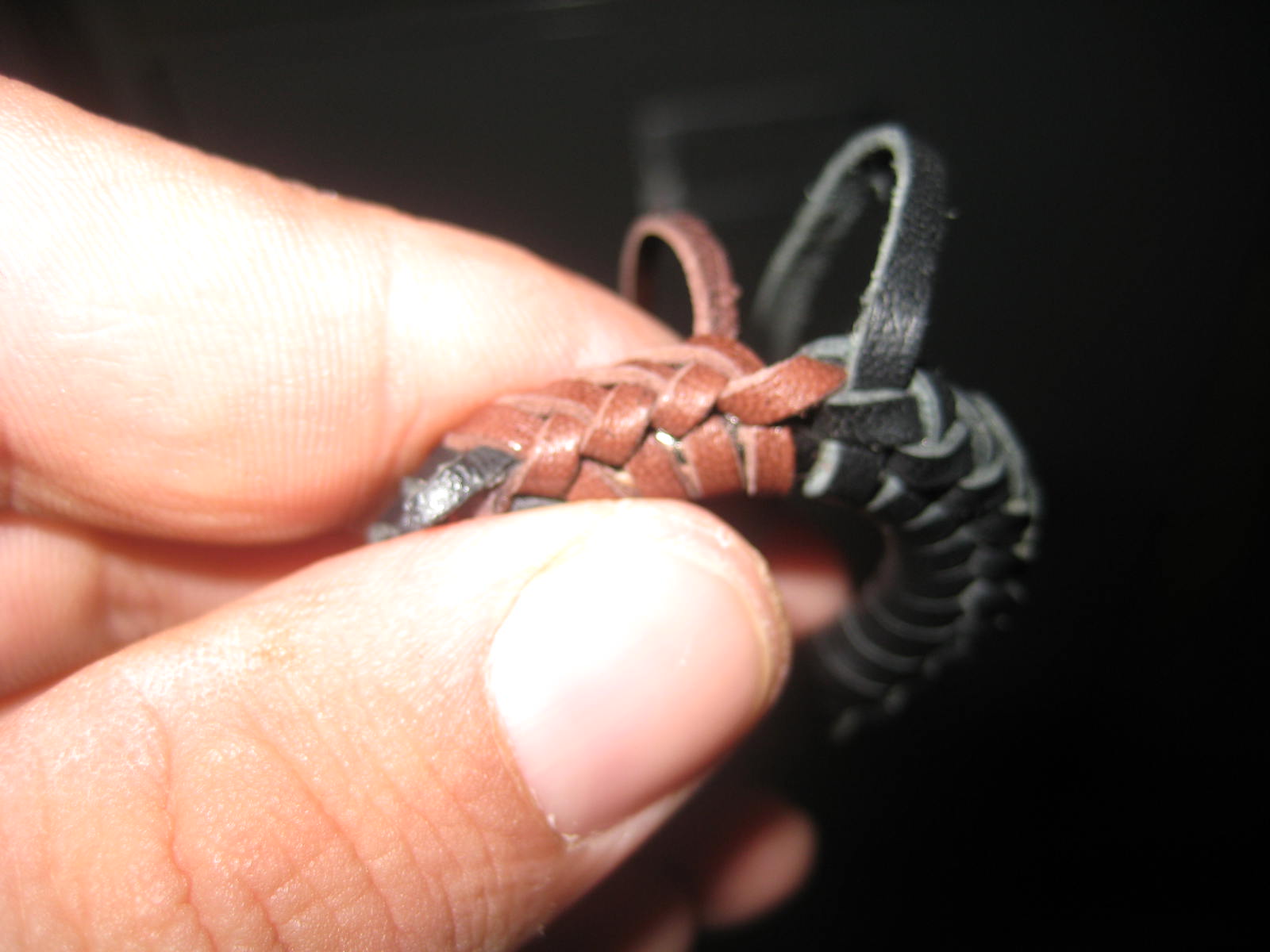

entiendo I didn't want to cornfuse anyone so I did it just like the one in the book. But after I took the pictures and posted I did go back and bury my working end under three. Just so it would hold better and it doesn't make the braid look any different. But I do leave the standing end as shown. I haven't had one come out yet. But I reckon if a fella was worried about it he could use a spot of super glue on it. Tony My daddy always said if ya want to keep your wife happy keep your nails trimmed!! LOL But to tell the truth my nails usually aint trimmed and clean. Mike
entiendo Sorry not to get this posted sooner. Here are some pics of finishing it. I used a different color of roo and it's a little smaller. So it doesn't look as nice as if I had stayed with the black. But I thought you follow it a little easier. Hope this helps Mike

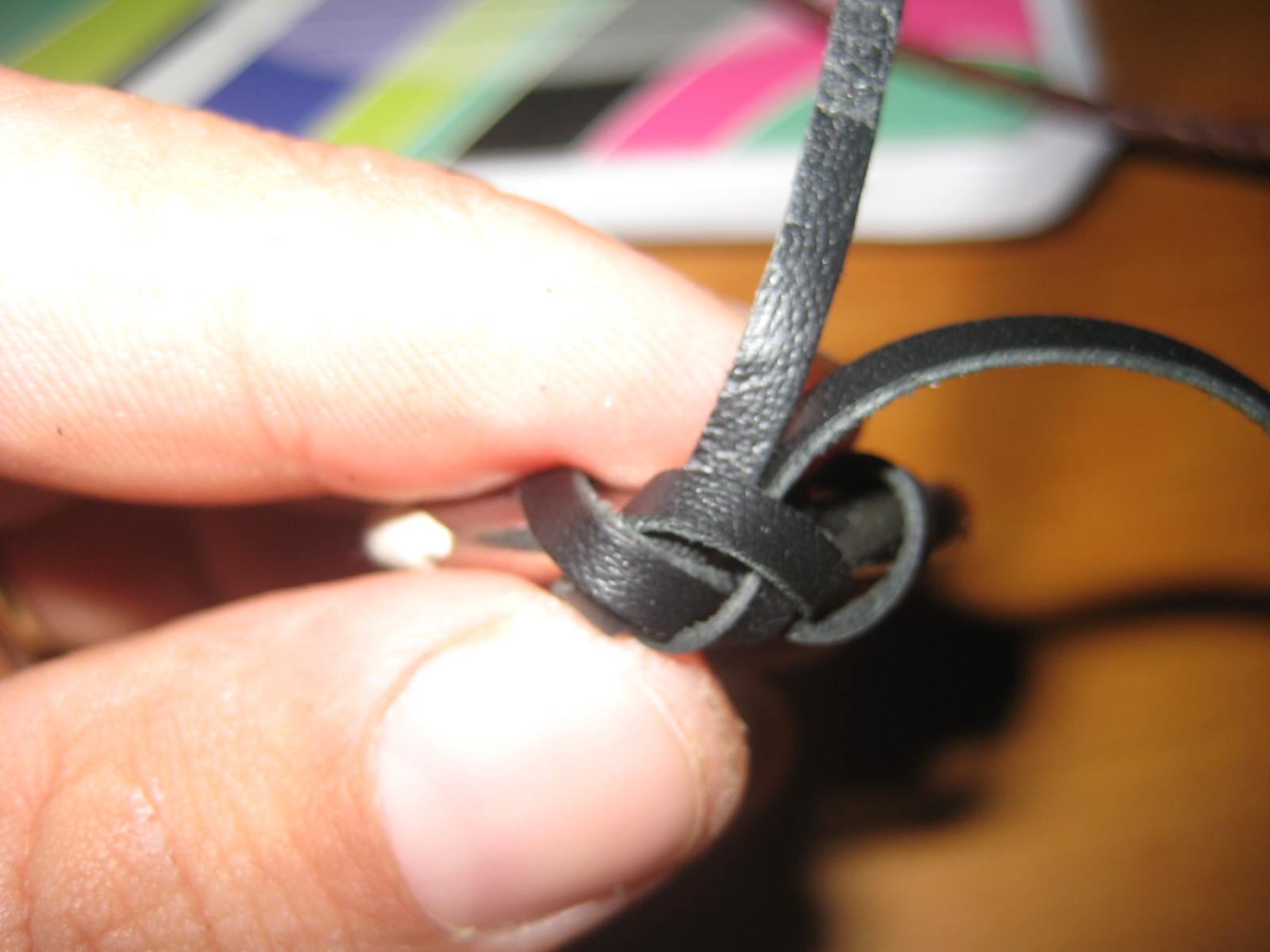

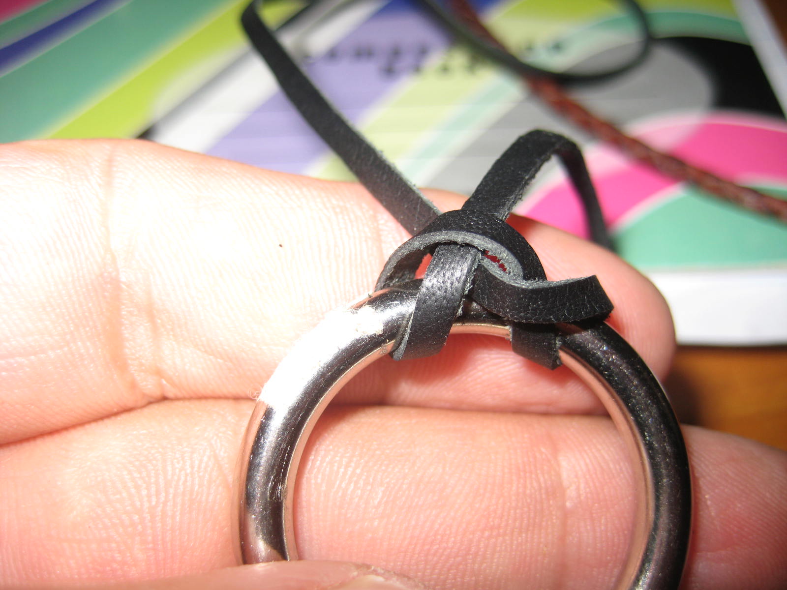

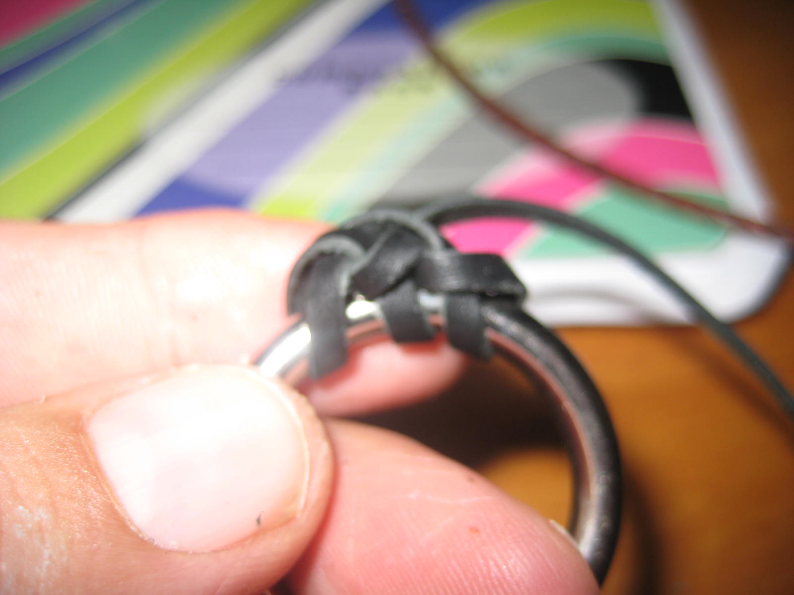

entiendo Here are a few pictures. I left the braid loose so maybe you can see better. Once you get started just keep going over two and then thru the ring and then under the X. I'm on duty tomorrow so it will be Mon. before I can take pics of how to finish it. If you need help on that part. Hope this helps if not we'll try something different. [attac ment=20184:IMG_1285.JPG]
