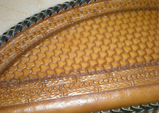

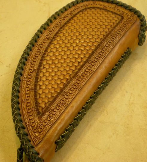

For 2 years now I have visited and marveled at the pistol case that a convict made for Kevin at Springfield Leather in Missouri. I finally remembered to take a camera with me today and took some pictures. The incredible thing about this piece is that the leather is 7/8 oz and unlike Peter Main and others- the leaves are NOT glued to the top. The reason that I say this is that you can STICK YOU LITTLE FINGER UNDER THE UNDERCUTS! I have no idea how he did this as I didn't think that you could stretch leather this high. I'm sick that my camera ran out of battery as the next few pictures that I was going to take wold have shown my hand on it to show exactly how deep the undercuts are. He must have had a lot of time on his hands..... 15-20 I think. This depth of tooling rivals anything that I have seen from Al Stohlman, Peter Main, etc. This man is a master
