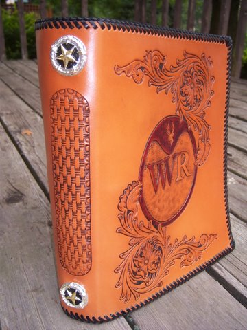

that's their brand. I worked from a really bad b/w zerox logo and sized it to look right. It was a gift from a friend to the ranch owner so I couldn't even get suggestions. His logo also goes from brown to nothing on the "R". I need to work on my dying skills- should have done 3-4 coats dry brushing so as to fade it out. I've never dome any figure carving so I went with a TLF deer stamp and beveled around it. DON"T SLAP ME CLAY! I didn't want to learn figure carving on my first commissioned piece! pete
