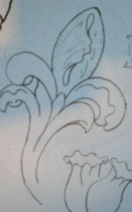

David, Clay, Bruce, et.al. Please critique this pattern if you would. Re-draw if you can- if anyone likes it it's free!!! It's my first attempt at a serious pattern. \Enjoy!
me too please!!! pete

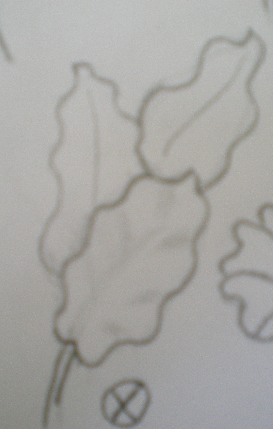

Thank you both very much. David-I have a new hope and energy from your remarks!Bruce- that's exactly what I was going to attempt. I'm very grateful for your comments as I greatly respect your work. Bruce- why do you vein down on the front leaves and vein up on the backwards leaf? Wouldn't the backside be a mirror image of the front? pete
PLEASE bear with me- this isn't a vanity posting- I KNOW that I can't draw but I'm trying really hard to get the feel for it. I see so many things in my head but I can't seem to get them down on paper like most of you all. So here goes- a few leaves and thoughts. The one marked with an "X" I thought would be interesting to carve with the back 2 normally and the front most one as the BACK of the leaf. I'm going to try to pear shade or emboss(push from behind?) the front leaf on the outer curves and pear shade the upper two normally. I THINK that it will show as the back of the leaf as it should. Thoughts????? ps- David G., Clay(s), and all you others that could do this left handed while watching the superbowl.. PLEASE feel free to re-draw these and make them better and more realistic. Thanks pete
