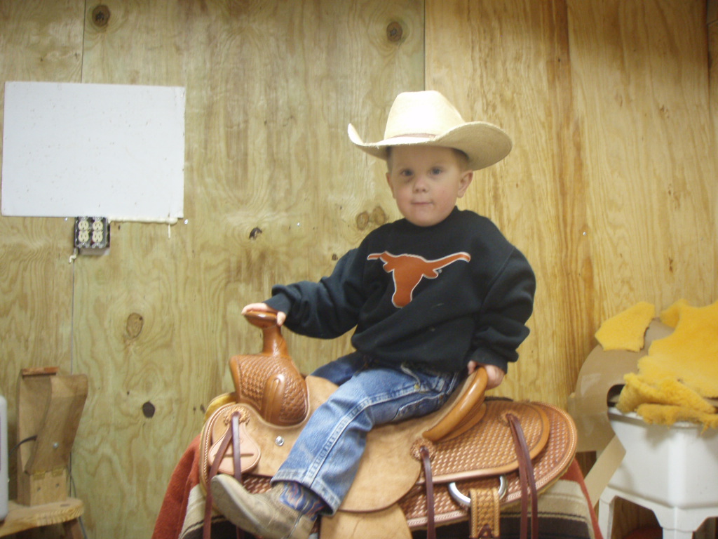

	Ricky and Joel, Thank you so much for the kind words. I see every fingernail mark and crooked stitch in it. JW, I sure appreciate it and the help over the past months. I think you hit square on. After I got them blocked they looked different than when I drew them on paper. Do you think if I took about an inch off the front and then flared the cut up under the fender it would level it out? thanks again, CW
	Here's my little boy and his Christmas present from dad. There wasn't any point in waiting til Christmas because he played in the shop floor most of the time I built it. Merry Christmas, CW
	I built this saddle for my son. It is a 13 in. Will James from Quality Mfg. with Hermann Oak leather. I would really appreciate some good critiques so the next one will be better. Please take a look at my seat profile and my patterns. I am not real satisfied with my skirt pattern but can't put my finger on what is wrong. The fender length may throw off the overall balance but he is only three feet tall and I let them out all the way for the pictures. Thanks and Merry Christmas, CW
