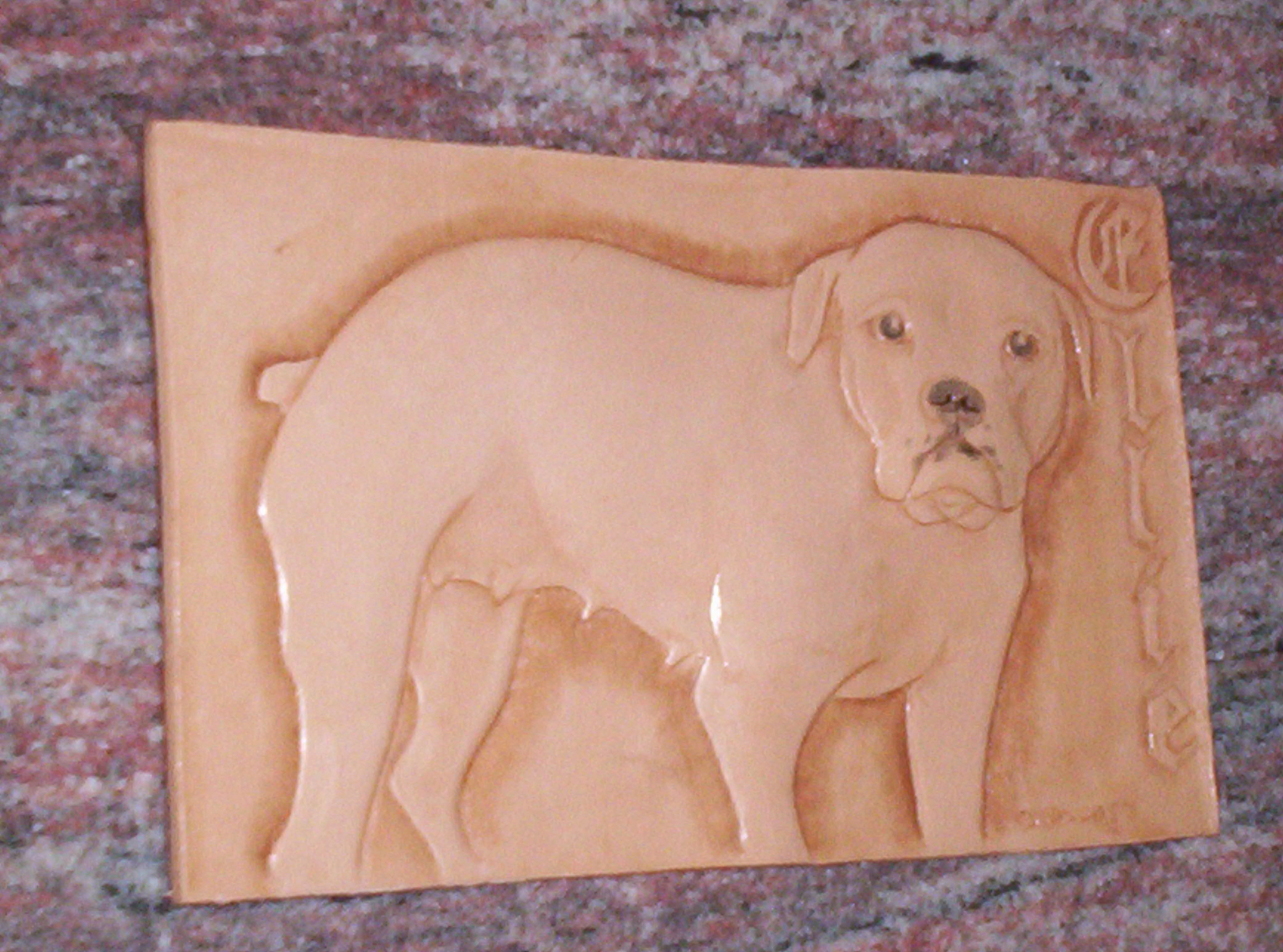

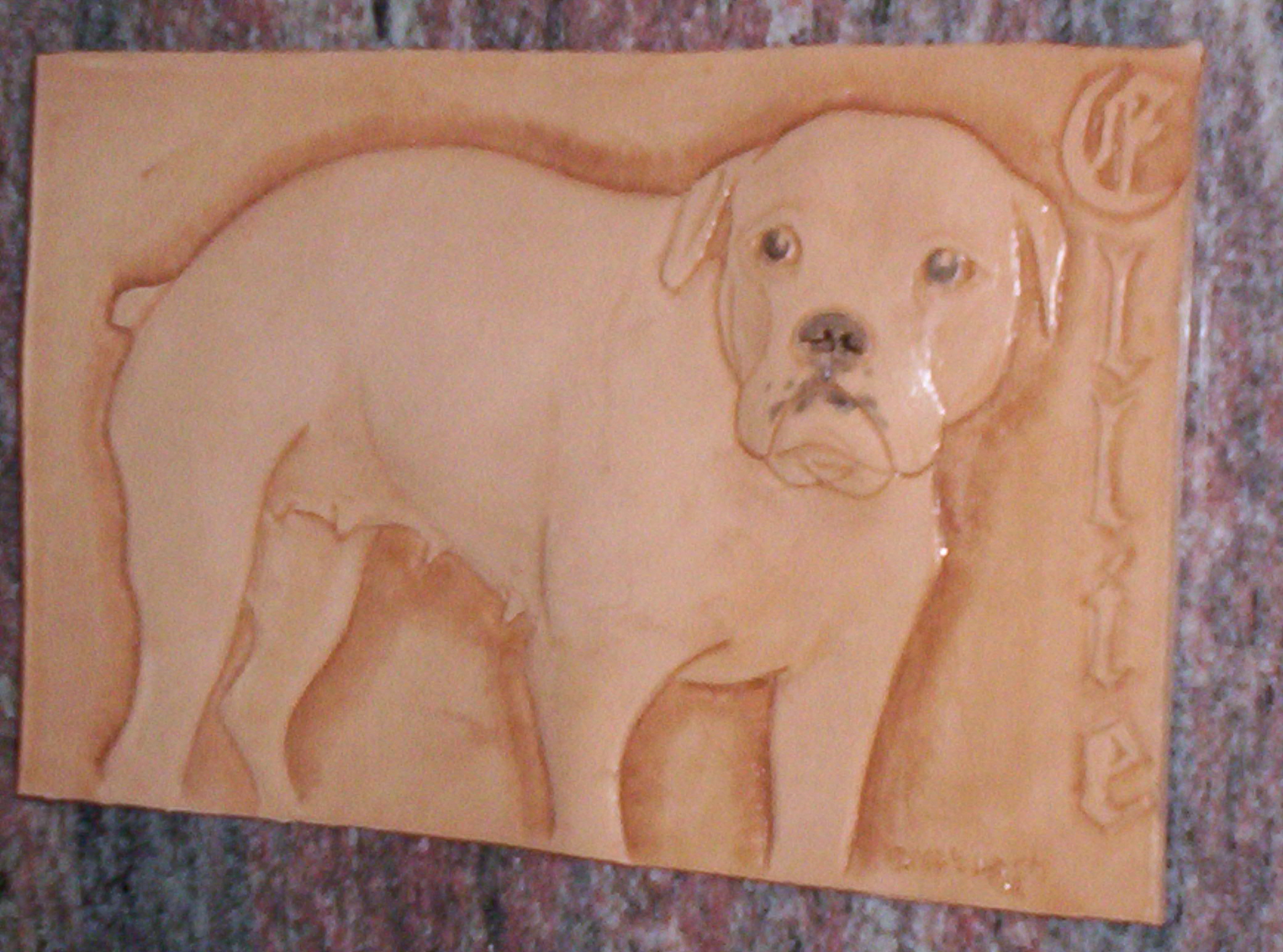

Here's the remake of the piece I killed (mentioned in '..Dyes..') The body of the dog doesn't have much tooling for musculature, but it is fully embossed. The right side of the dog is higher than the left, and the head is pushed out even more. The dog is totally white, except a few blotches on her muzzle. That presents a slight hurdle since I wanted to keep a natural leather look. Interestingly enough, Eco Super Sheen and Resolene have a slightly different tone when dry. I used the SS on the dog, and the Resolene on the background. It's hard to see in the photos ('cause I don't have a lightbox or a good camera) but the head is raised about 3/16" above the background. Also included is the source pic, for comparison

Thanks for all the replies, and yes, I just recarved it today. The old Architect's addage "If you can't hide it, make it obvious" just doesn't seem to have taken spirit dye into account. The whole problem with any fix was that the dog I carved was s'posed to be white. I did dye the whole original piece to match..then tried a few other things....and well...now I have a med. brown carving reverse highlighted with titanium white artists' oil paint. That's when I reached for the clean leather. I'll post pics over in Figure Carving this afternoon.
