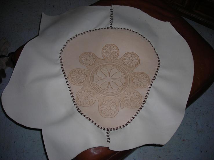

Randy, I also use 6oz for the top and 3-4oz for the sides. I try to get the sides really wet before forming to the seat. I try not to get the top wet. Yes wetting the leather makes it more workable and it does shrink a bit making it tighter. Unfortunatley it's been my experience that even if you don't have any tight curves the leather will still bunch some especially in the front of the seat. one of the tips I picked up here is to wet form the seat riveting it in place stretching it evenly. You will probably find that there will be some areas that you can't get the bunched up leather to smooth out. Let the seat dry out for a day then remove the rivets in the area that is bunched up then re-wet that area and stretch it some more. If I'm working with a steel pan I use sheet metal screws the first time I form the seat that way I can remove them easily when I re-wet and rivet for final fit. Not sure if that will work for fiberglass. here's a pic of a cover I made that eventually was wet formed I used two pieces for the sides because that's what I had but one piece works just as well Scott -

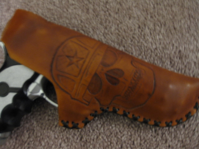

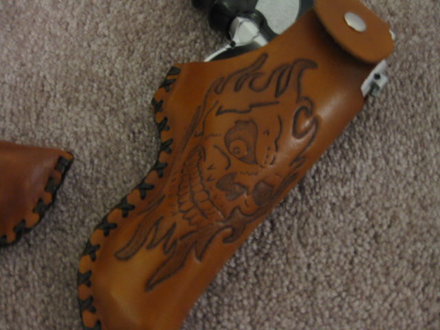

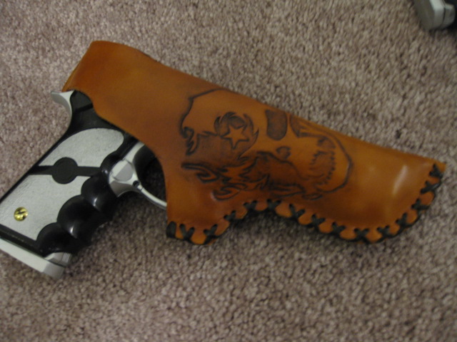

Knifenut, I wish I had alot of artistic talent. It takes me awhile to draw out my patterns and sometimes I have an artist friend draw some for me. I got these from a Google Image search. I changed them some to fit the holsters. I wish I could give credit to the artists but images get linked and sent all over and you never seem to see the original source. Scott
