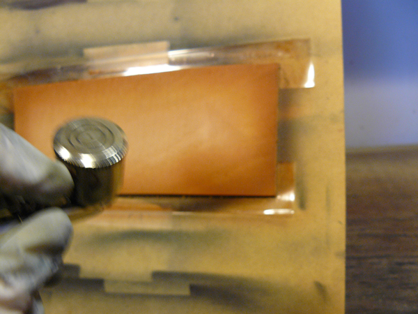

Marlon asked earlier about techniques for shading edges with an airbrush. Here's a quick series of photos I put together to show how to do that. It's also quite easy to do, even for someone without a lot of airbrushing experience. (Sorry about the quality of the photos - I was too lazy to set up the tripod to do this series, and was holding the camera in one hand while I worked with the other. Bad idea - won't do it again. Anyway...) I just used a piece of badly abused scrap for this demo. To begin, I'm putting a thin line of color around the very edge of the part. This can be done for one or more passes, depending upon how dark you want the shading. Then, start spraying a gradually wider pattern... ...and wider. The color will be darkest around the edges, and gradually and smoothly fade towards the center. If you want a little more darkness around the edges, to give it almost a burnt or even charred appearance, add a thin line around the edges of your color with something darker mixed in. I mixed a few drops of black dye in with my tan. Finished. If you use antique, make it darker. Kate
