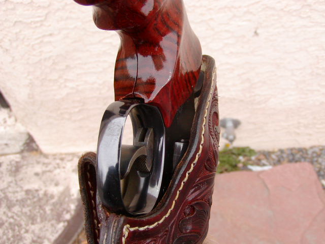

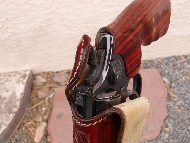

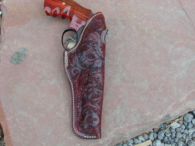

Over the years I've done a variety of western-style rigs, although it has never developed into a major portion of the business. A few months ago while working on a couple of orders I developed an idea that I thought might be popular with a few folks. Basically, this holster is generally of the single-loop style, and resembles the holster used by John Wayne in many of his later movies. I envisioned a simplified construction method using Chicago screws to secure the holster loop, which really speeds up the overall production process. While working on one the thought occurred to me that interchangable loops could be used, allowing the customer to customize the basic design to personal preference, or to have multiple holster loops on hand to change out as desired. So in addition to the basic single loop I made up a loop reminiscent of the Texas jockstrap style. I may also do up a strap with buckle for another look. Presently I have several of the loops at my carver's shop being embellished with Sheridan-style floral carving. This will permit a very nice custom holster touch without the expense involved in a full coverage carving job. While he's at it I'm having a number of ovals carved in Sheridan floral that can be added to the belt for a matched set. Shown here with a 2nd Generation (1957) Colt Single Action Army, 5.5" nickel finish. I'm having fun with this idea and look forward to getting a number of pieces made up to show on the website. Have a couple of orders so far, one including a buscadero-style cartridge belt.

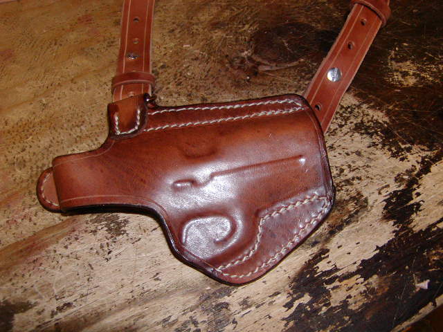

Horsehide is considerably more dense than cowhide, so direct comparisons of leather "weight" are difficult. Being more dense horsehide provides equal strength with less bulk, and it is also more resistant to moisture (perspiration is always a factor with shoulder holsters and IWB-style holsters). In terms of thickness the horsehide used on these holsters is similar to cowhide of about 5 oz. weight, which performs much like cowhide of around 7 oz. weight. The straps are made of slightly thinner horsehide, providing better flexibility. Strap length adjustment is provided by Chicago screws and multiple holes in the straps. The support pad is made of two layers of horsehide in the general shape of a butterfly to conform to the upper back and base of the neck where it rides, straps are connected using Chicago screws so that each strap is fully articulated and allowed to rotate freely at the connection point as the body moves. Strap connections at the holsters are done on D-rings, which also allows the strap connections to move with the body. The overall objective is to improve comfort in use by preventing chafing or kinking of the straps as the wearer engages in normal activities. An added small benefit of this design is that it permits the use of one harness with any number of holsters and/or pouches. I have had quite a few customers order additional holster & pouch sets, saving the expense of a separate harness for each carry rig. Customers appreciate the modular approach for its economy, while I see it as providing additional profitability down the road. -
Recently had a customer request a modification to my horizontal shoulder holster design to include two holsters rather than a holster and double mag pouch. This rig is for two S&W 3913-NL pistols. Done in horsehide, a good choice for shoulder holsters due to its reduced bulk and higher resistance to moisture-related problems than cowhide (shoulder holsters are always subjected to perspiration in use). Personally, I haven't felt the need for two pistols since my days on a narcotics task force, back in the 70's. But the customer is always right, right? Maybe, I guess. Oh well. Kind of fun to have something different to do now and then.
