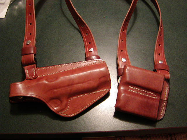

Thank you. Made for a railed 1911, if I remember correctly. Shoulder holsters are not as popular as they were 20 years ago, but we still get orders for 3 or 4 per month. Anyone who has ever used a shoulder holster can tell you how damp they can become during use. Horsehide is an excellent material for this type of application.
Jeremiah: Nothing to share as far as dyeing goes. The pieces shown are finished with nothing more than neatsfoot oil, acrylic sealant, and final finishing agent. The colors, and variations, shown are naturally occurring within the horsehide. Some hides will display it, some will not. I would be careful about "misting on" any dyes, as noted in my earlier post the horsehide does not readily absorb any liquid and can easily start to display surface cracking that displays underlying material that does not absorb the dye and will be quite noticeable. Not familiar at all with the antique paste, but as you note it does not penetrate well, so the effect could be similar and the results could be disaster. My best advice is to keep experimenting with sample pieces, use them for a while, and only take on commercial orders for those things that you know will stand up to rigorous use. Otherwise you may have disgruntled customers. Replenishing the inherent moisture seems to me to be the key, and modest applications of neatsfoot oil seems to do the job for my needs. Best regards.
