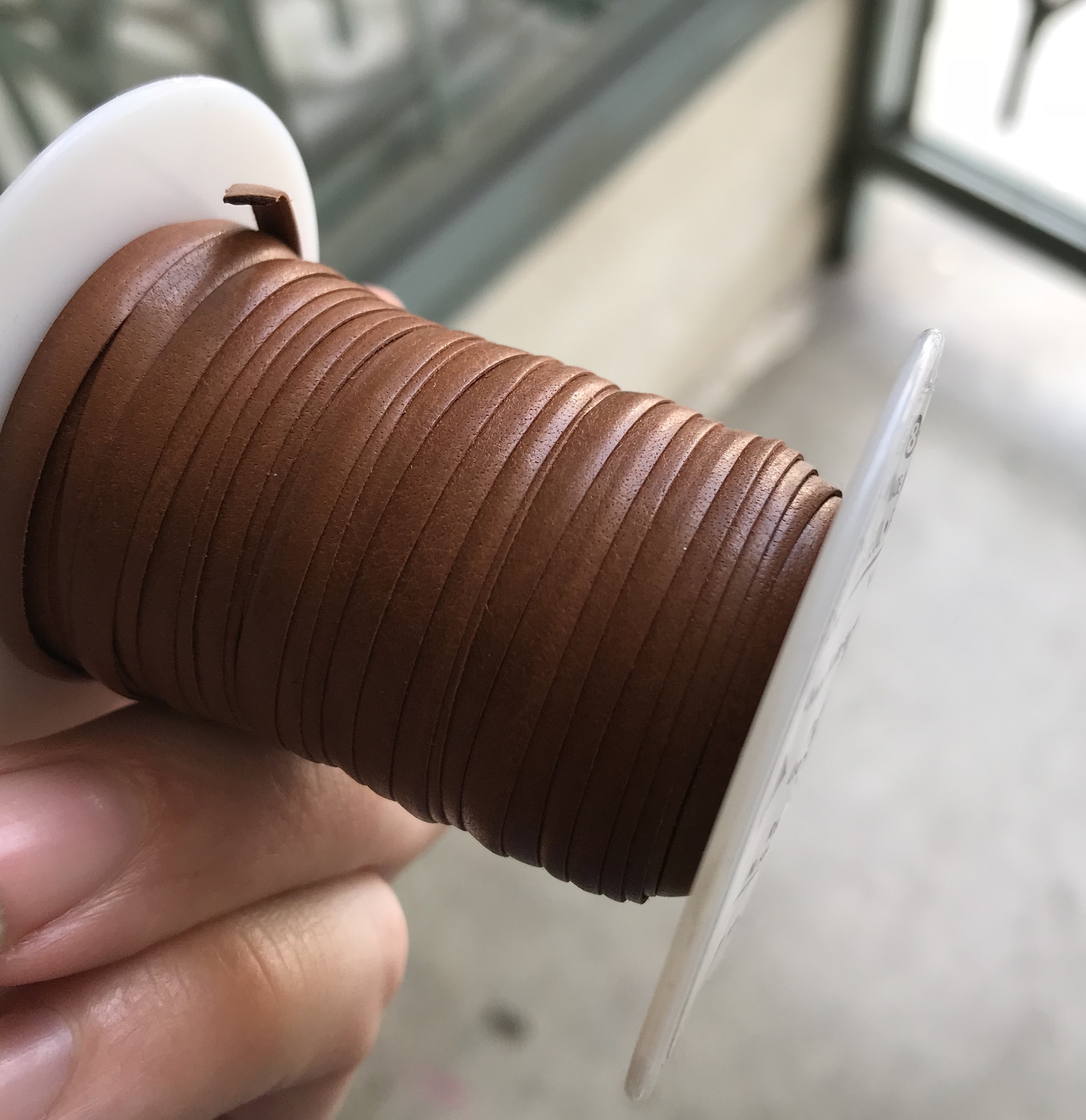

I use Tandy’s Premium Calf Lace. It is beveled, formed veg-tan calf lace that is light weight, extremely thin and fairly strong. I use it on ALL my lacing projects because when you’re looking at it vs. “Real Leather” brand, Tandy’s craftsman lace, etc. the others’ top grains get lost but the calf-lace keeps that continuity between itself and the top grain of the leather on your project. I don’t know if I’m describing it best so I will just tell that it looks WAY better. It’s sometimes cursed with bad splices and discoloration for being as expensive as it is but it’s great looking stuff on a nice project. I’ve never found beveled, formed lace like this before and I want to know where Tandy gets it or how it’s made so I can either make it or have it made for me in more colors. I use a lot of this stuff and even with Elite pricing it costs me $1.14/yrd
